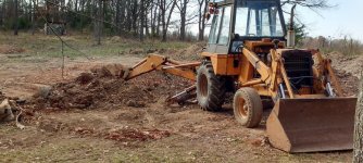

Is this the kind of hill you're talking about? The far end is about 5 ft cut out. I made it wider than the shop so I can slope away from the foundation. No fill necessary, so no soil engineering, engineered fill, compacting, proctor tests, etc

Our new shop is built into a hillside. The site drops 7 feet diagonally across the building, hence the basement under the garage floor. The building is 50 feet wide and 35 feet deep.

Check my thread out. I cut into the hill to avoid the soil and compaction issues that James mentioned.
