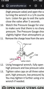

If you're nervous about pulling a vacuum, don't be. Looking back, it really isn't as intimidating as it seems. You still have to make the same flare connections regardless of which system you buy. The difference is that with a traditional system, the refrigerant stays sealed inside the outdoor unit until you're ready to release it. Pulling a vacuum removes air and moisture from the lines and lets you verify your flare connections are leak-free before opening the service valves. Once I understood what was actually happening, the process made a lot more sense.
I just did a Cooper & Hunter 9,000BTU in my attic (12" open cell foam, so very well insulated). Had my contractor run condensate and refrigerant lines, as well as control and power, so mine was easily plug and play. Oh dear lord it feels heavenly up there now, even set at 80 degrees, because of the humidity difference.
I did not know the system came pre-charged. Darn near destroyed my vacuum pump when I went to evacuate it. Which brings me to a question.......how do you evacuate the system when the unit comes precharged?

For my unit, the refrigerant is in the outdoor unit, so when the vacuum is pulled, it’s on the line set and the indoor unit. The outdoor unit until you open those valves to let the refrigerator out is self-contained.

The only port on mine was on the low pressure valve. Open to evacuate, and you simultaneously opened the refrigerant to the rest of the system (and vacuum pump).
I should have just opened it, and purged some on the high pressure side (system off) the same way you do gauges, by cracking that flare fitting loose, befire opening that high pressure valve. But I didnt thibk of that until it was too late.

Valves at the condenser are shipped closed. After lines are connected most manufacturers want 500-600 lbs of nitrogen pressure for 4 to 8 hours. Nitrogen is blown out, vacuum to under 500 microns. Install manual will list what the manufacturer wants. With a unit in a deep vacuum unit valve are opened. Vacuum pump is pulling te vacumm through gauge manifold and can be valved off.
These directions only listed instructions for recharging, not initial setup. But yes, I know the preferred method. The bigger problem is that the service hookup didn't give access to either the lines to the evaporator or the condenser. See Attached from the manual. The red arrow is the service line hookup. The valve is the setscrew like thing. You can see how it closes the two sides simultaneously.

You need to RTFM and not mislead folks how installing minisplits is done. The OP has it perfectly explained.
You don't open the valve to the condenser to evacuate the lines. You evacuate the lines and the indoor unit to the required vacuum level, seal up the system and then release the refrigerant from the condenser unit into the lines and indoor unit. All most all mini splits work the same way.

Hey, man, look. I can't tell you how many times I RTFM trying to figure it out. And like I said, I had no idea it was pre-charged, which may have what led to all the confusion. I was expecting to evacuate not just the lines and evaporator, but the condenser as well. Also, go back and re-read, I was ASKING, not telling anyone.
It took no time to get down, like instantly. Maybe because my pump is for vacuum bagging composites and abotu 10 times larger than is necessary, but it did not appear to be pulling a vacuum on the system, I would have expected it to not immediately bottom out the gauge, but rather several seconds or a couple of minutes. Every car I've done has been the same way.
So it appears that the service port goes around the valve and passes to the lines. That is what I was trying to figure out. OP's picture looks exactly like mine, and it didnt' appear to me that the valve worked that way (and honestly, from the outside, it still doesn't).
The service port does not go around the valve. When shipped, the valve is closed. You evacuate the lines and indoor unit via the service port with the valve closed, then you seal up the service port and next open the valve to release the refrigerant to the system.
