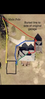

Any thoughts or input on getting power to the garage?
Or should I post electrical question as new post?
Will have heat / ac. Likely 2-3 zone minisplit.
Power for maybe two electric vehicles just in case. Small tankless water heater for possible dog washing station. And then normal lights and outlets. Nothing crazy.
Picture included:
Power buried from pole to side of original garage. Separate panel for garage / garage apartment. Then line runs to main house with its own panel.
?? Run another line off main house panel to panel in new garage (green line)
?? Run another line off original garage panel to new garage panel (Blue Line)
?? Just pull new service to garage from pole (likely overkill)
Thanks for any input

Do either of those panels have open capacity for the draw of the new panel?
P
Parttim3r
Mar 28, 2022
15
200 amp service.
I “think” we have plenty of room / amp wise for the detached garage. Waiting to meet with electrician for site visit as well.
We have ~2 ton Ac, electric water heater, stove and washer/dryer in apartment and not much else.
We have 3.5 ton Ac, water heater, electric washer and dryer, stove, in main house and then just scattered circuits for three bedrooms / etc.
Could also look at just increasing service to main house at time of running the sun panel to the new garage if needed, so don’t have second bill / meter.

Gotcha. So 200A service to the current garage, which then feeds that garage, an apartment, and the main house. Calling an electrician out to talk strategy is prudent. I'd start laying out both the current and expected amp draws in a spreadsheet to get a grasp of whether or not the 200A service is adequate.
P
Parttim3r
Mar 28, 2022
15
This stuff is definitely over my head a bit. I appreciate the input and I like to know all my options….”good, better and best” and then I Can decide which one to go with once I discuss with electrician.
racecougar
Jan 26, 2021
5,572
Missouri
I get it. Without being able to walk through your current and expected draws, nobody is going to be able to provide an answer that has any certainty behind it via the internet though. That's why I suggest laying it all out on a spreadsheet.
