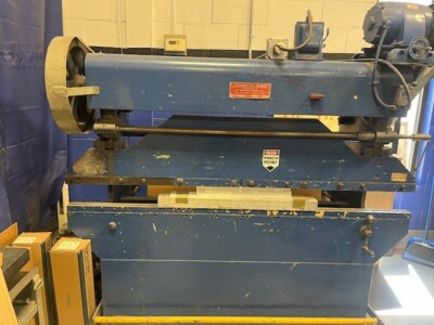

With that said, I've found myself enjoying making a lot of one-off stuff and find that I often have to do bends with precision.
I used to own a Harbor Freight 20 ton press, with Swag OR finger brake kit. Made my own "bottom dies" I rigged up along with having made my own gooseneck dies -
The problem is that the tool set the kit comes with, will not suffice for providing clean bends with a tight radius on smaller parts. Especially if those parts are made from thinner material.
If you look above in my current pic, you'll see a 20 ton Bend Press I got from Trick Tools. That thing got me hooked as it uses a 30 degree punch and uses a 4-way bottom die to use for different thickness materials. Only problem is that the punch is a single, non-replaceable piece and I can't use a different bottom die paired with the fact that it's only 10" wide.
Here it is in action -
Has anyone used the Cyclops Designs press brake attachment found on Ebay?
I'm especially interested in it because it uses EURO tooling and comes with a 24" 4-way bottom die (if purchased with tooling).
Unless there's an alternative I should be looking at?
I'm on a fixed income and short on space so just trying to spend my money wisely.

Just be aware that used Armada and Euro tooling is more difficult to find than American. It's also way pricier too. You are looking at anywhere from $11 to $20 bucks an inch, plus shipping. A quick scan of fleabay had less than a dozen pieces listed, while there were over 1500 listings for American style dies.
The two main points for looking at this setup are -
Although not as common as American dies, I do find Euro dies that would fit many of my needs as I sometimes require a 6" wide gooseneck and various other styles.
Having a 24" width gives me a lot of flexibility and I would not buy a 24" die in every style. This means the cost difference between dies themselves is not an important factor.
But if I went with American style, what press brake attachment is out in the market that you can suggest? Around $1.7k with some tooling included?

Most of the Euro tooling is sold in metric sizes. So your 24" length would require 2 dies in the stuff I'm using LVD/Wila. Most of it is segmented which is nice but not really needed for your type of machine, and requires a unique punch holder ( but if you don't need the quick change feature, you could make some thing that would just clamp it in). Also your machine really would be a waste of the precision these tools are made to, ie. 0.0005" ground and hardened, another reason they are $$$$$
If I were you, I would look for a 2' section of 4 way die and say about 26" of some goose neck die and cut it up into 4 pieces (2", 4", 8",& 10"), so you could bend a few sizes of pan/box's.

Kwik: I'd look at fabricating a new bottom section for the SWAG kit. If I remember correctly, it takes American tooling already, You've got the skills to create a new bottom that take American stuff.
Depending on where you are located, there is literally thousands of tons of American die sections for sale at any one time for cheap. Even HGR Surplus has it for less than $4 a pound, for any profile or length.

What I'm getting is more than just a suggestion to switch to American Tooling, but also it seems like I should just "make my own" attachment by the sound of it?
Either make you own, or bump your budget up a little and find a used 4' or smaller press brake.
Here's 6 footer with a bunch of tooling..
or:
K
KwikFab
Jul 27, 2024
1,226
Central Valley, CA
or:
Fixed income :ROFLMAO:
