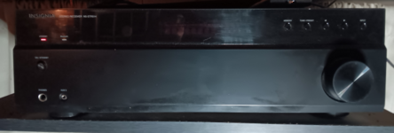

Hardly any cheapie is gonna get ya any good AM nowadays. Check Craigslist (or FBMP if so inclined) for 90's-2000 era Sony receivers. Not so much ebay, should be able to test first. Or similar brands from that era. Better reception, especially AM. No internet, blutooth or streaming stuff getting in the way either. Simple, and they work. Running two now in the garage and patio. Early 2000's Sony STR-DH130 and an Insignia NS-STR514 (BESTBUY home brand) maybe 15 years old. Both are left in unheated/uncooled areas 365. The Sony ended up with a foot of snow on it years ago. Removed cover, brought in the house for a week to dry out upside down, still fine. Powering four good size speakers on both. I also am 75% AM for talk, news and ballgames while outside. $50-$75 around here.
