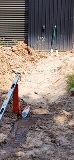

When I had the concrete poured for my pole barn I had a 2" waste line put in exiting out the back of the shop about 15" from the shop wall. I picked up a stainless steel sink from a local bakery that closed. Sink is just to wash hands before going into house, filling dog water bowl and occasionally washing items. No heavy use.
I'm not cheap I just don't want to waste money putting in parts over complicating things if I don't need to. The 2" pipe sticks up out of the floor. Is just putting 45's and connecting the sink drain to the waste line sufficient? Or do I need to put in a p trap and air vent?
This is just the sink grey water occasional use going out to the yard. I live in the sticks on a 6 acre lot. Going to put a splitter on the hydrant with one side feeding the garden hose and the other leg feeding the sink.

I’d put a p-trap in for two reasons. You may drop something down there you want to retrieve. And it will keep bugs, mice, and rats from crawling up the pipe into your shop. I‘d probably extend the other end out a little ways from the foundation into a gavel filled hole. Make sure it’s not clay so it doesn’t hold water and bring mosquitoes.

I would install a trap and also install a vent type fitting on the end of pipe out in the yard to keep critters out of it.
ETA
Yes. Like above pic with the landscape cap on the end.

You guys rock, thank you for the pic's and guidance.
I couldn't find anything to fit on end of the 2" pvc exit behind the shop so I put a cap on it for now and drilled a bunch of holes in it.
I will have to see if they make those baskets you have that fit on 2". You have correct name for those green baskets so I can search better?
Off to Lowes to buy fittings and see what I can do. I'll post a pic when completed.
