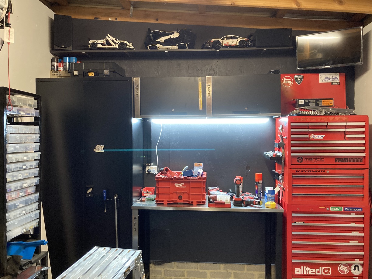

Anyway, first up was cleaning up and tidying one end of the garage so I could paint it and get it sorted out:

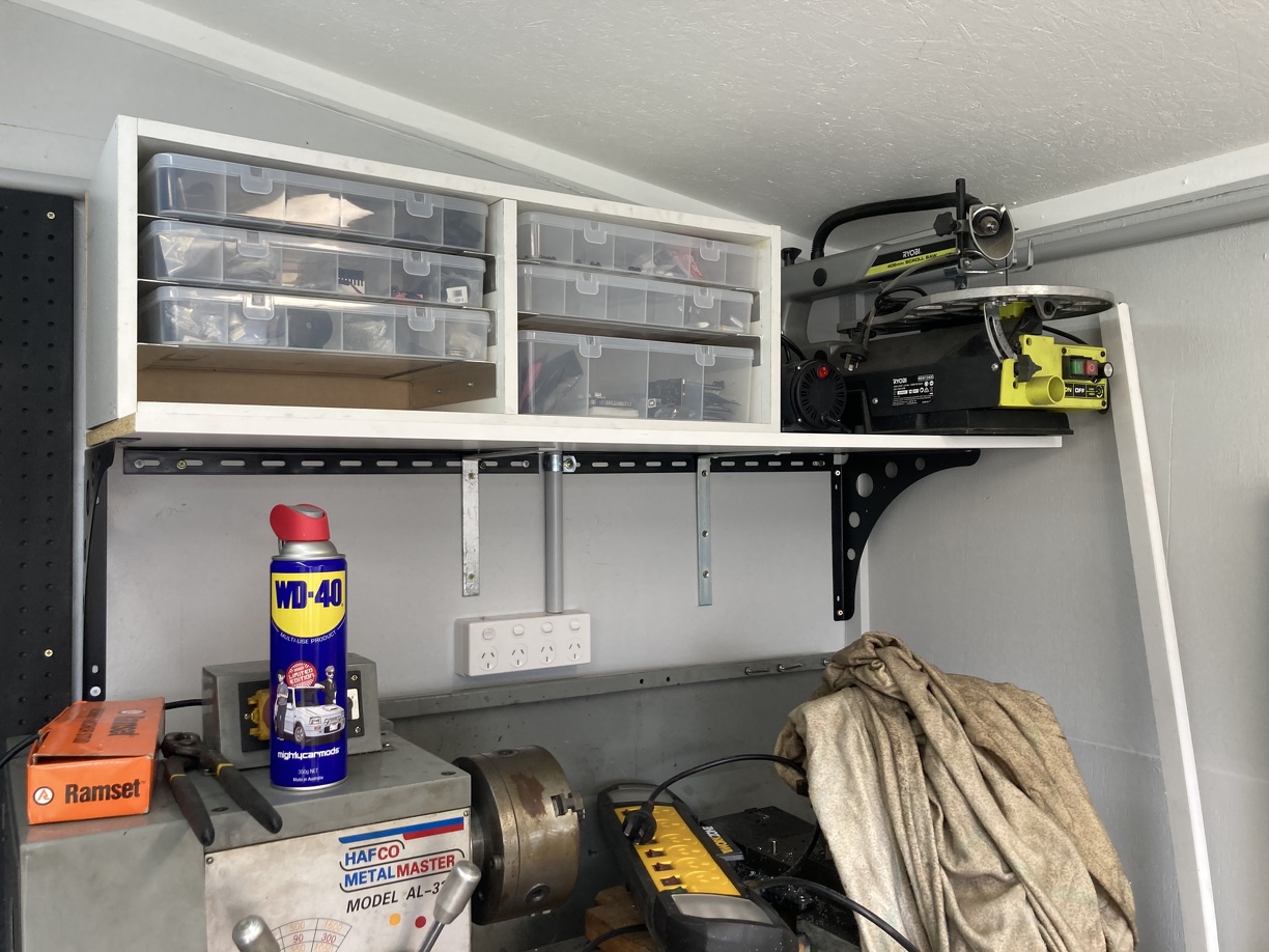

Then moved stuff back in place, added the cabinets above the workbench and a few decorations:

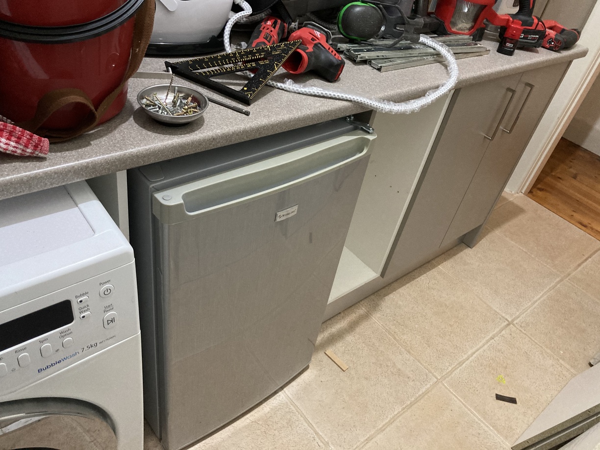

Then it all got hot, so worked inside for a bit and removed the two useless clothes hamper drawers from the laundry and built a basic hole for the upright freezer.
Just needs a shelf cut down to size and to get one of the door frontages edge banded for it and fitted up. For now though it got the freezer out of the garage.

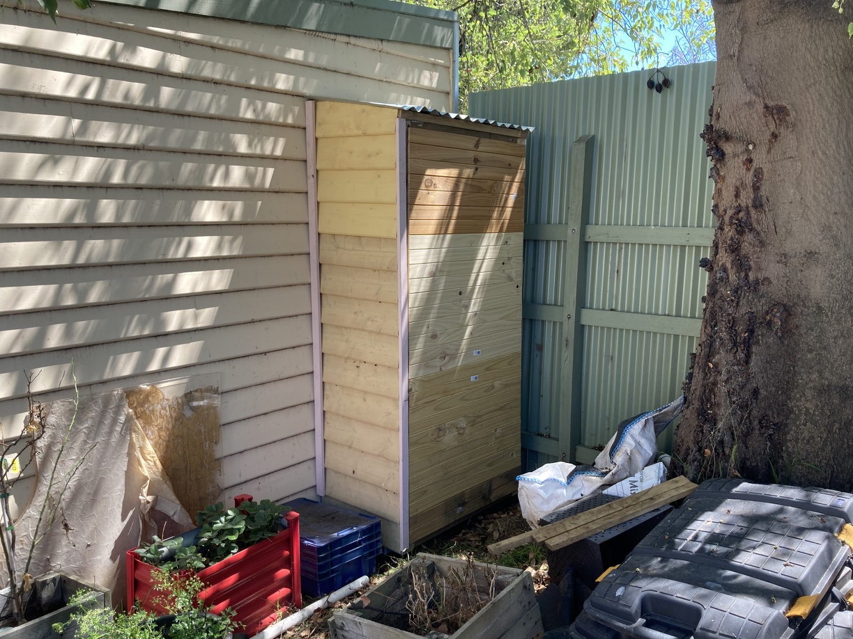

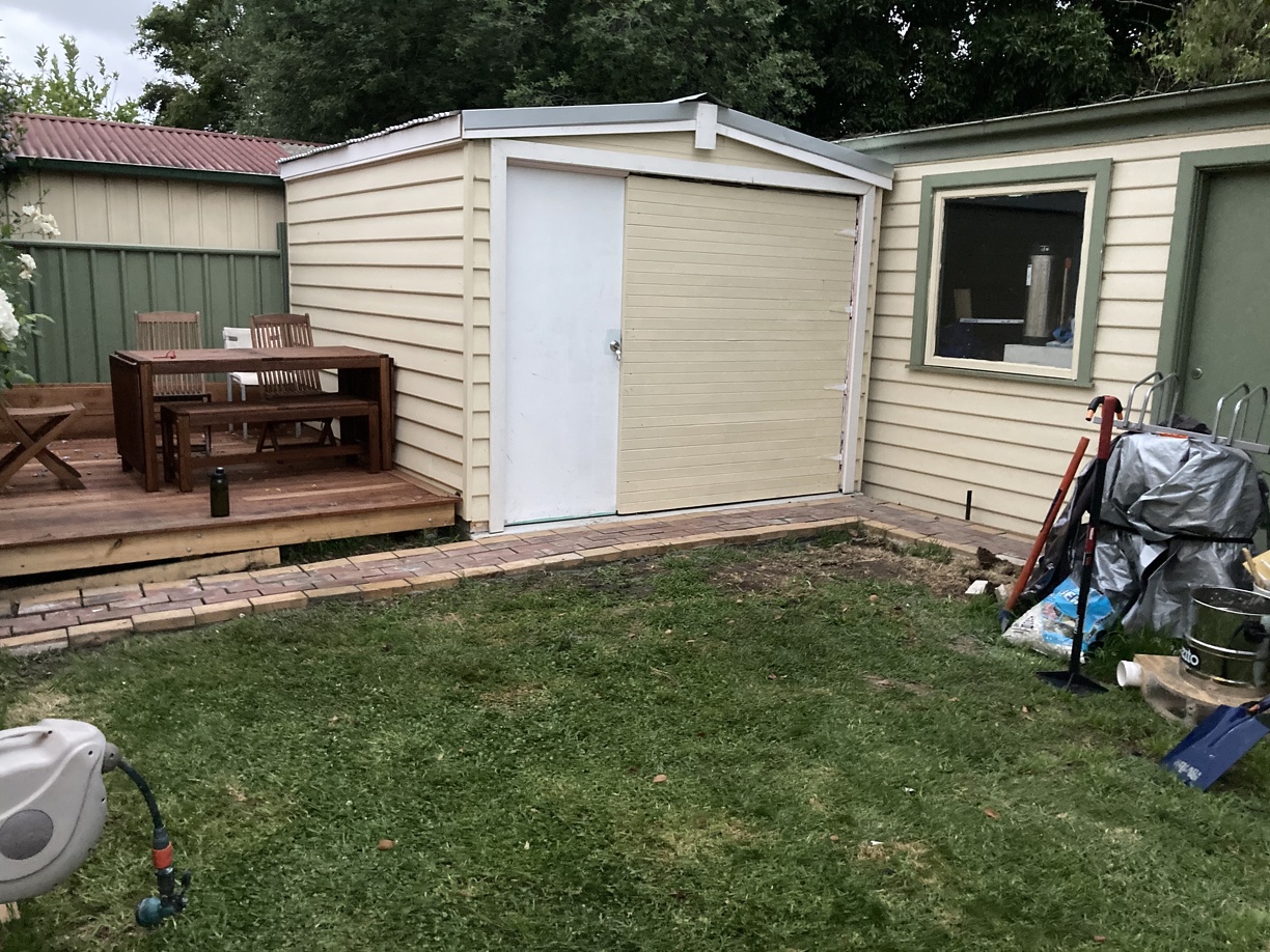

I also built a quick hutch/cupboard for the air compressor on the outer wall of the garage:
It has an outdoor powerpoint in there, and i lined up all the weatherboards for a different base spacing, then changed my mind, so going to have to deal with it being out of alignment. Ohwell its pretty obscured back there.

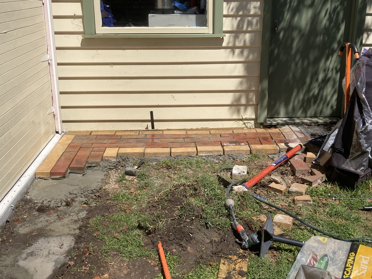

Also did a bunch of paving around the edge of the garage/workshop so can now get from the back door to the garage without walking across the lawn:
Still need to build the step off the deck.

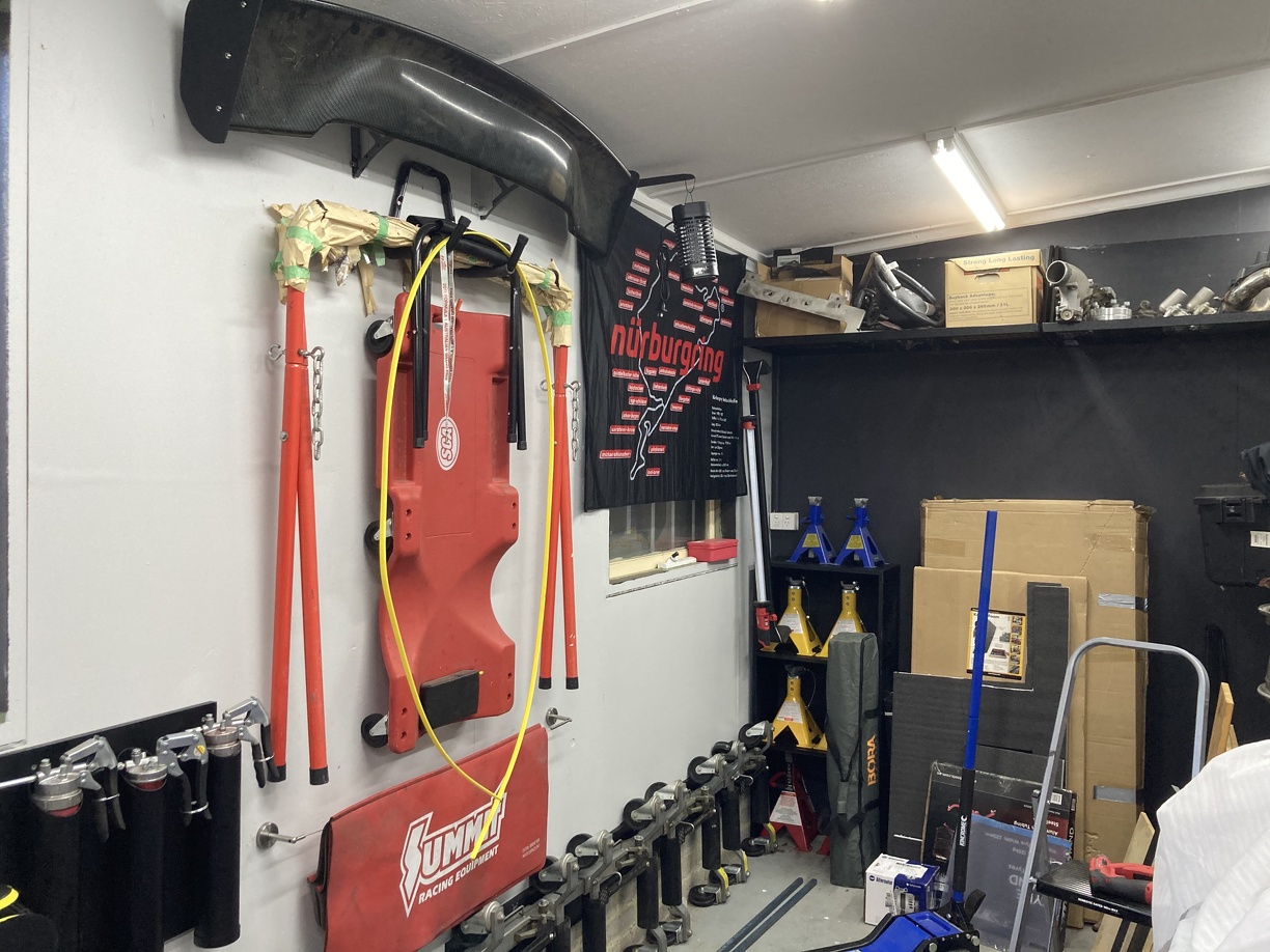

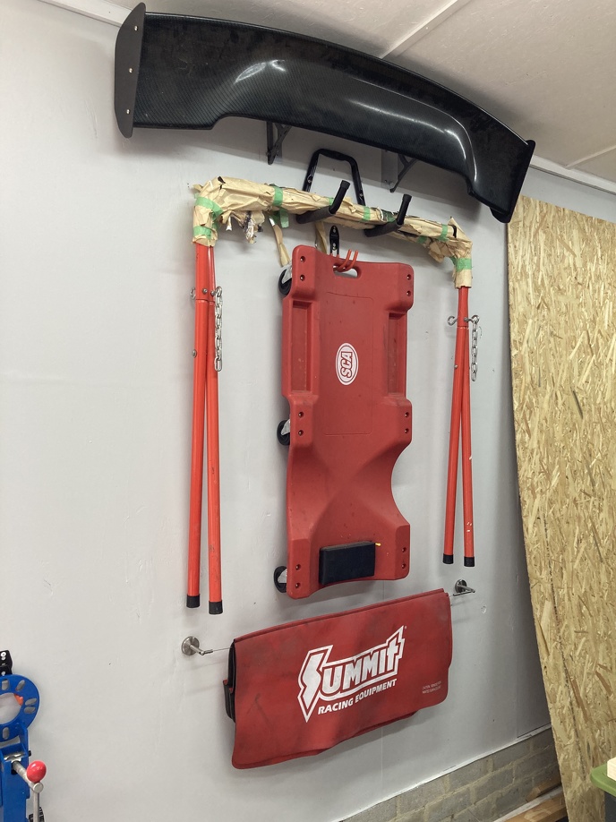

Plus started getting stuff up onto the walls off the floor to just try and tidy up a bit:

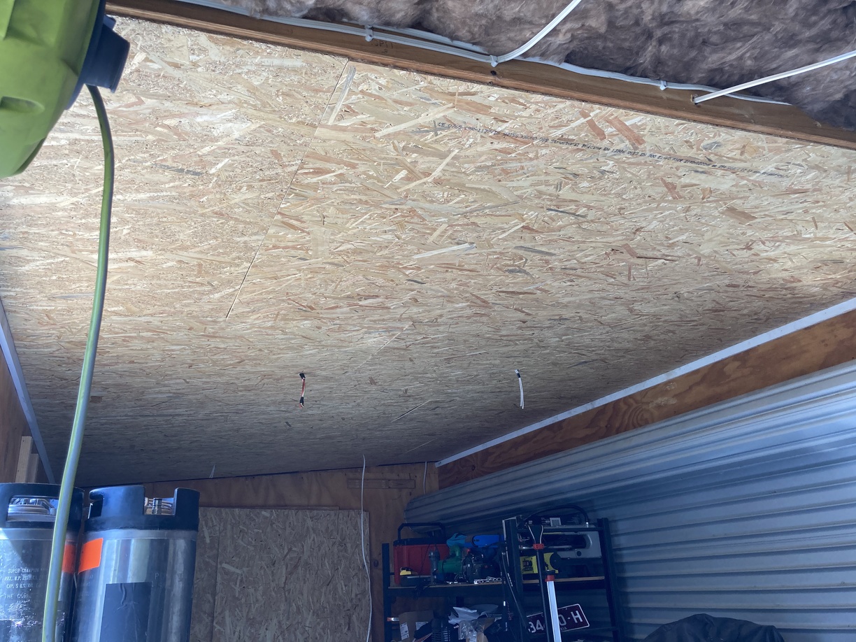

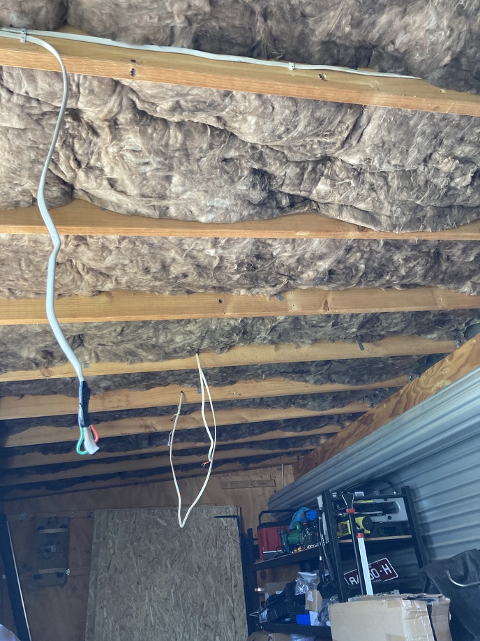

Oh yeah, and did I say it got hot...? Decided to rethink my plan of leaving the rafters open and at the last minute chose to insulate them.
Shoved a bunch of insulation batting up into the rafters on a 35C day...
And now have started to clad it all with 6mm OSB like the workshop... fun

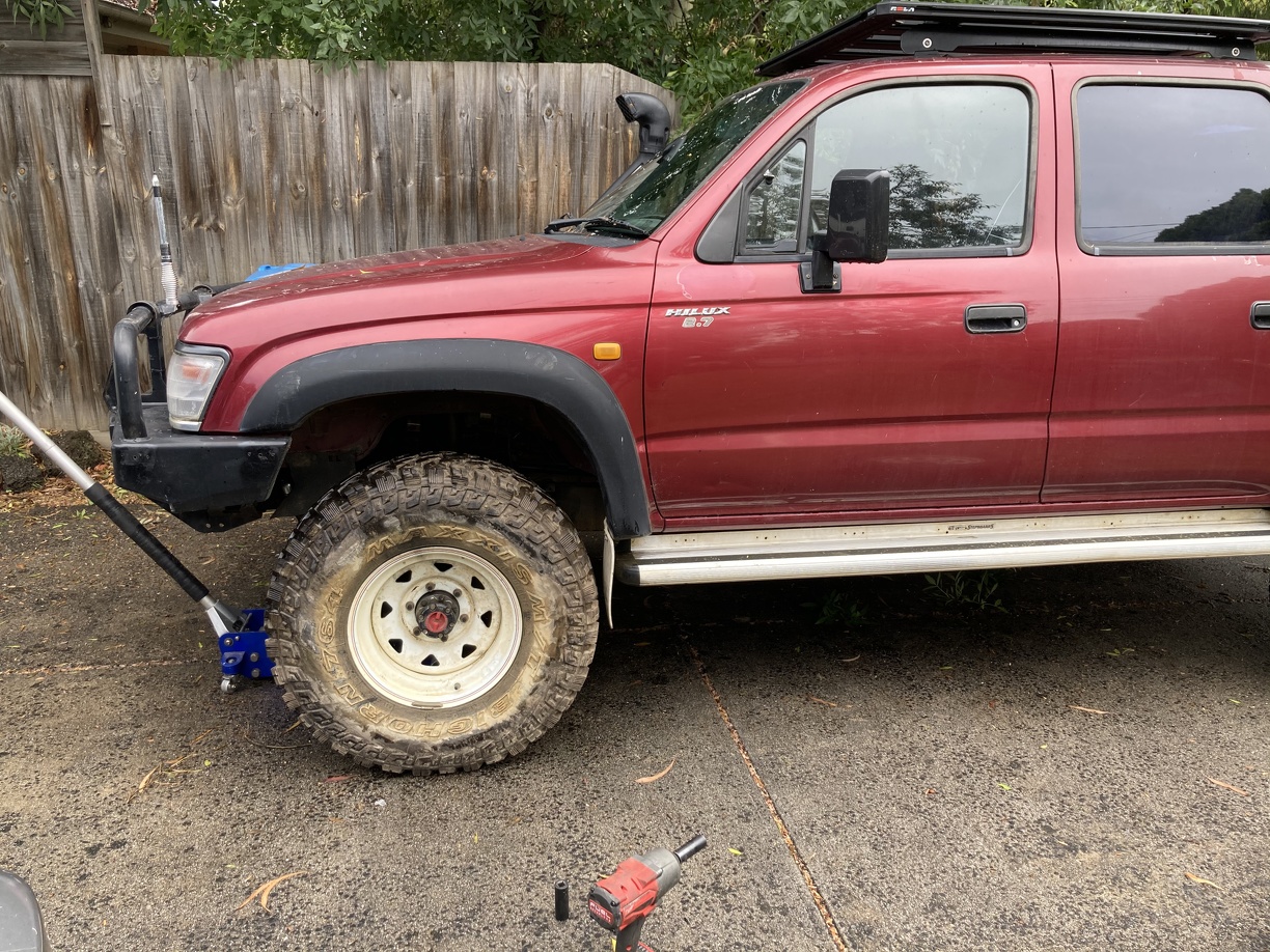

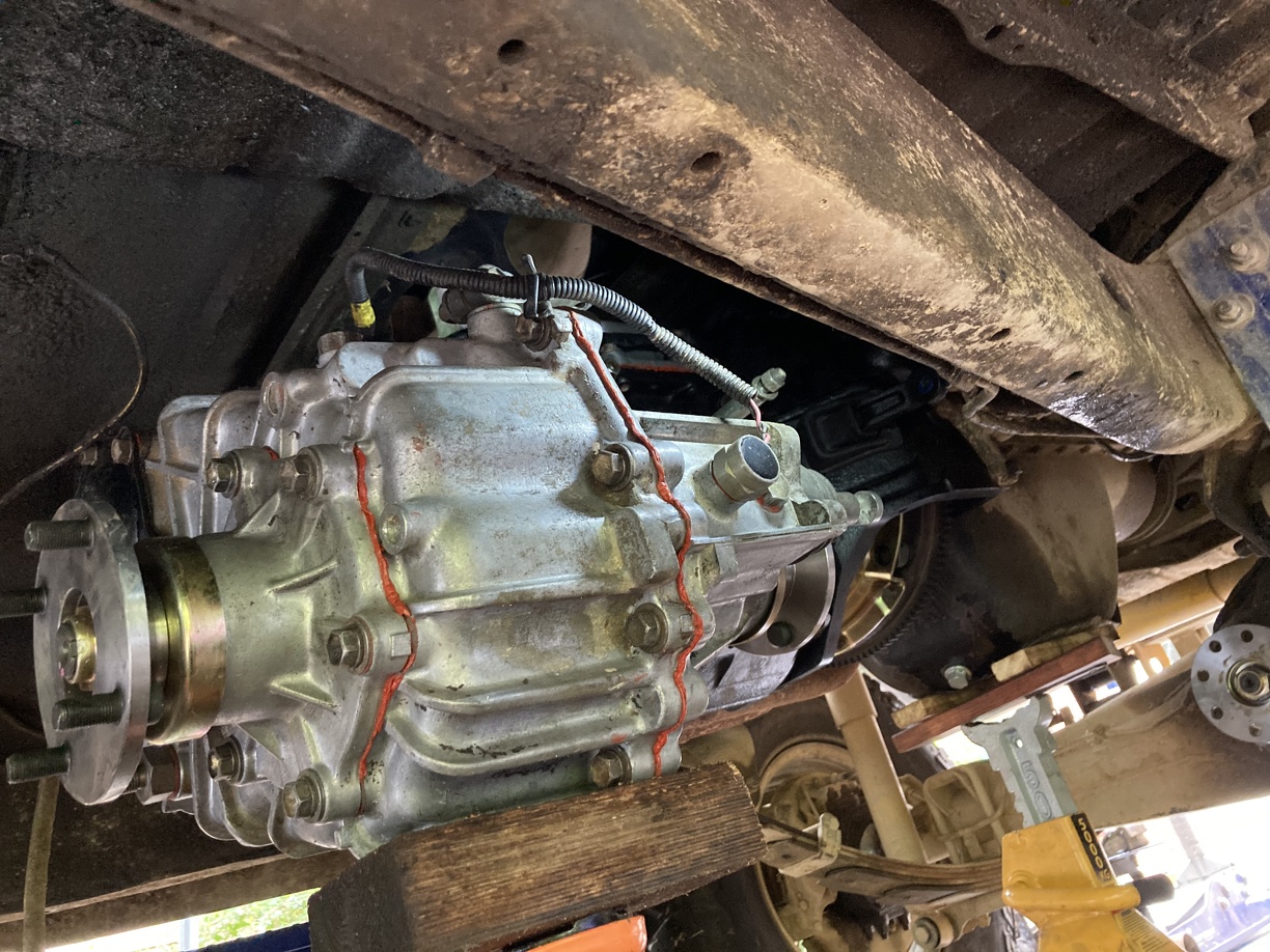

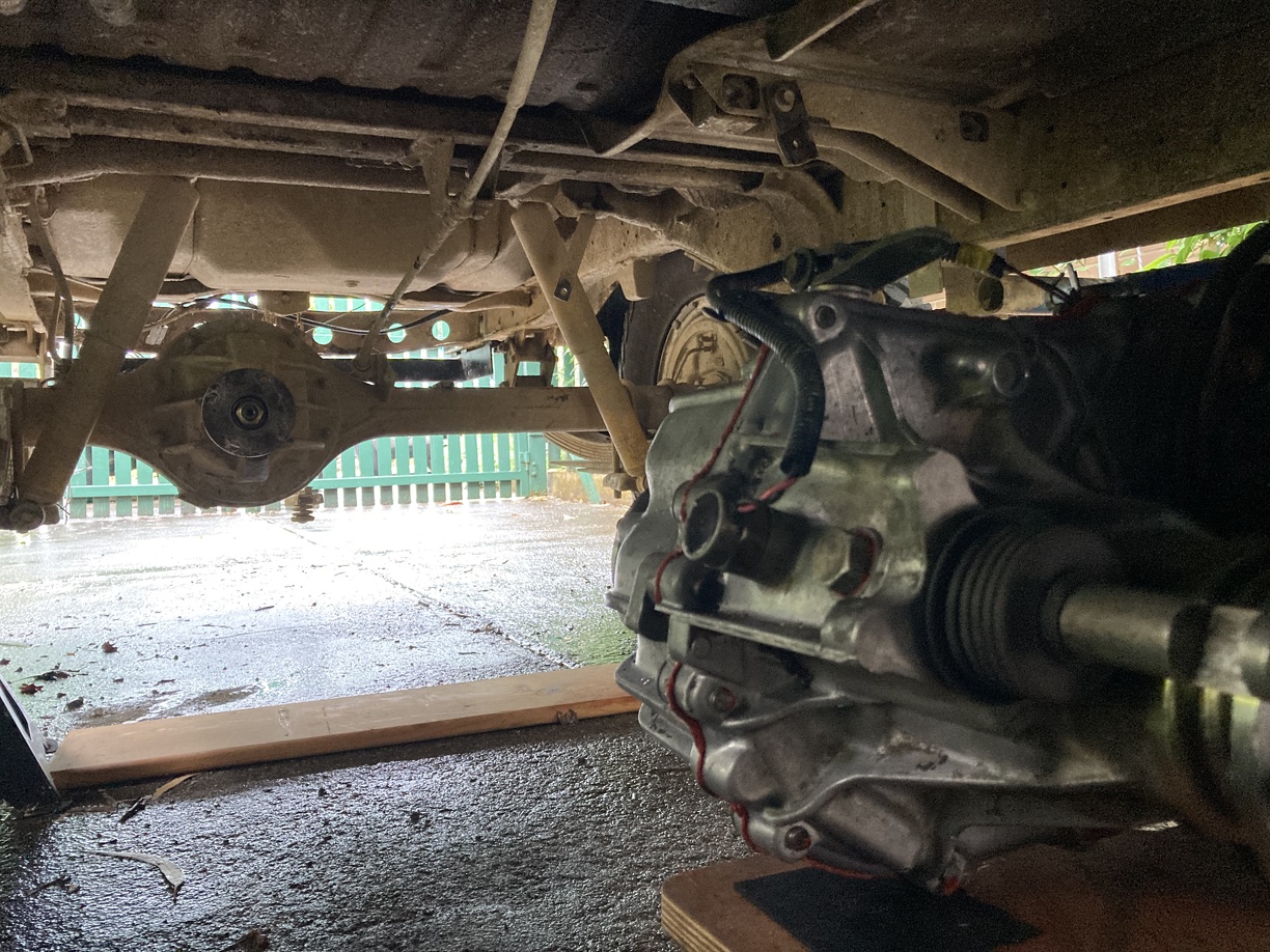

I also headed around to a mates house to help him put a H55F back into his 60 series, on a day when it decided to pour with rain... that was fun.
Mmmm, 90kg of freshly rebuilt cast iron gearbox:
Somehow we managed to get it up here with 2 jacks and a lot of dicey manoeuvres:

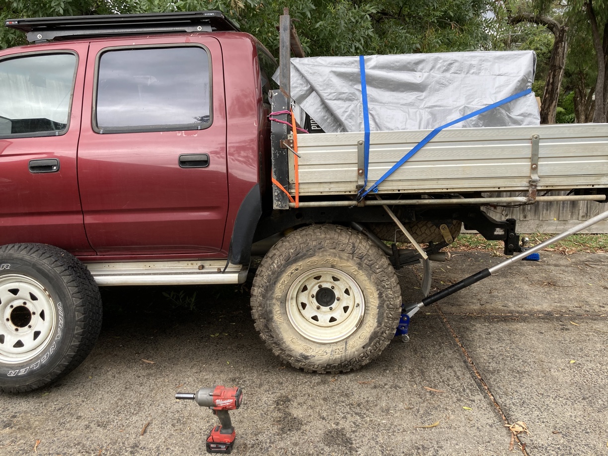

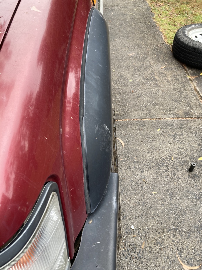

But while I was there we test fitted some wheels to the Hilux:
They are 32x11.5x15 on 15x8 -23 offset wheels. Fit up pretty well. Might need a touch of relief around the inner plastic guard on the flares, and those side steps will need to go. But no great loss there
Pretty much perfectly fitting guard wise:
Tempting to grab those when he goes to 33s.

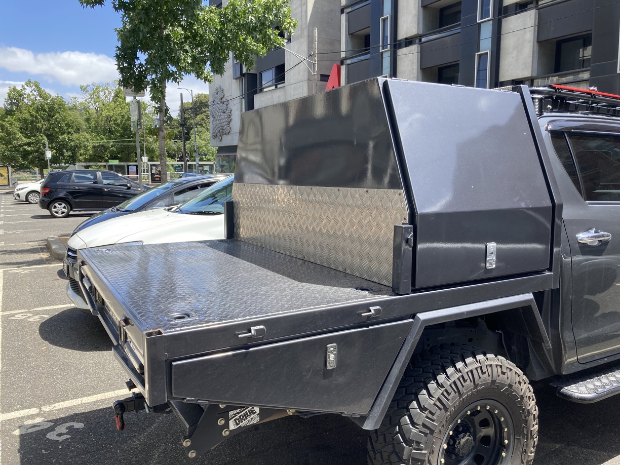

Also came across a random ute in the street with a canopy setup similar to what I am thinking of, so leaving this here to jog my memory:

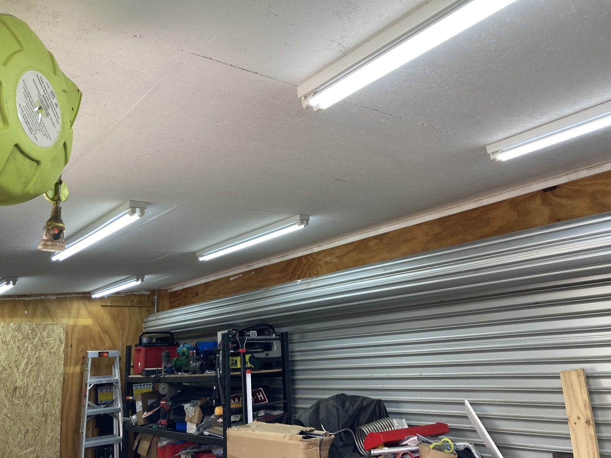

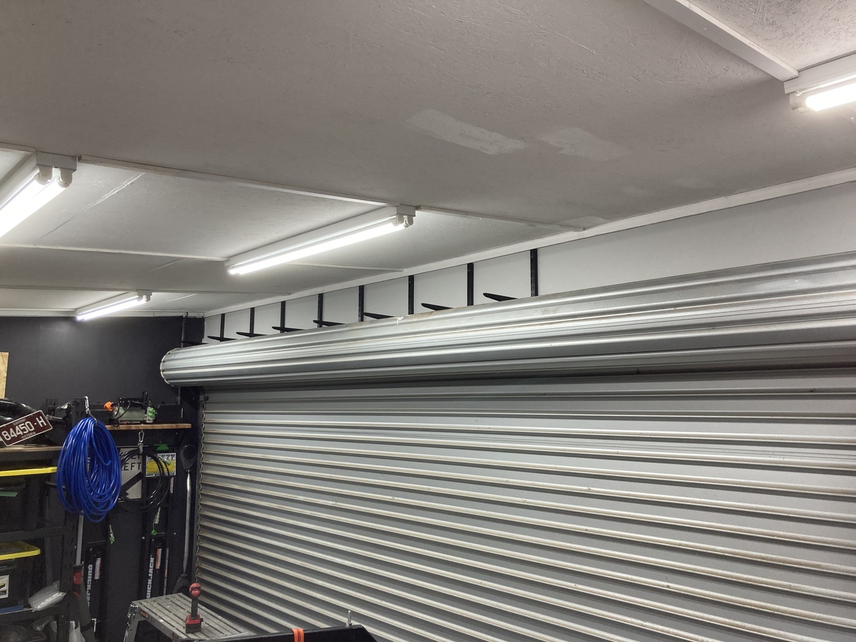

6 dual T8 battens with LED bulbs, courtesy of my cousin picking them up from some surplus/liquidation store in Queensland and sending them down.

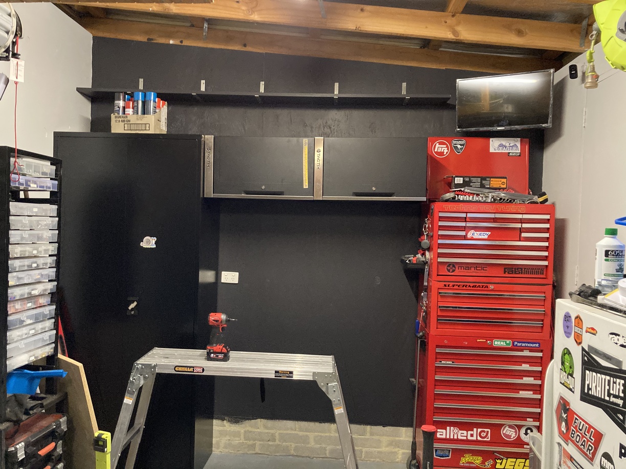

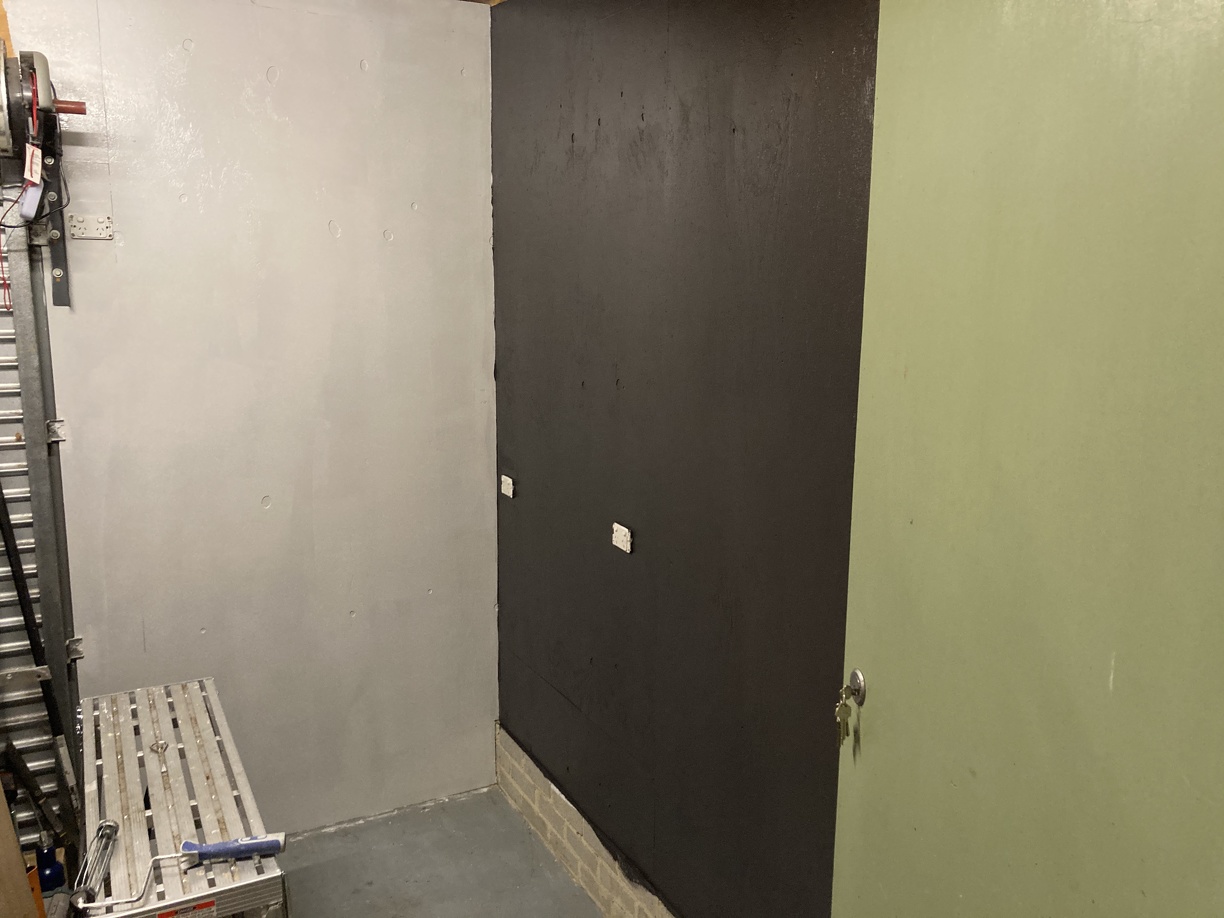

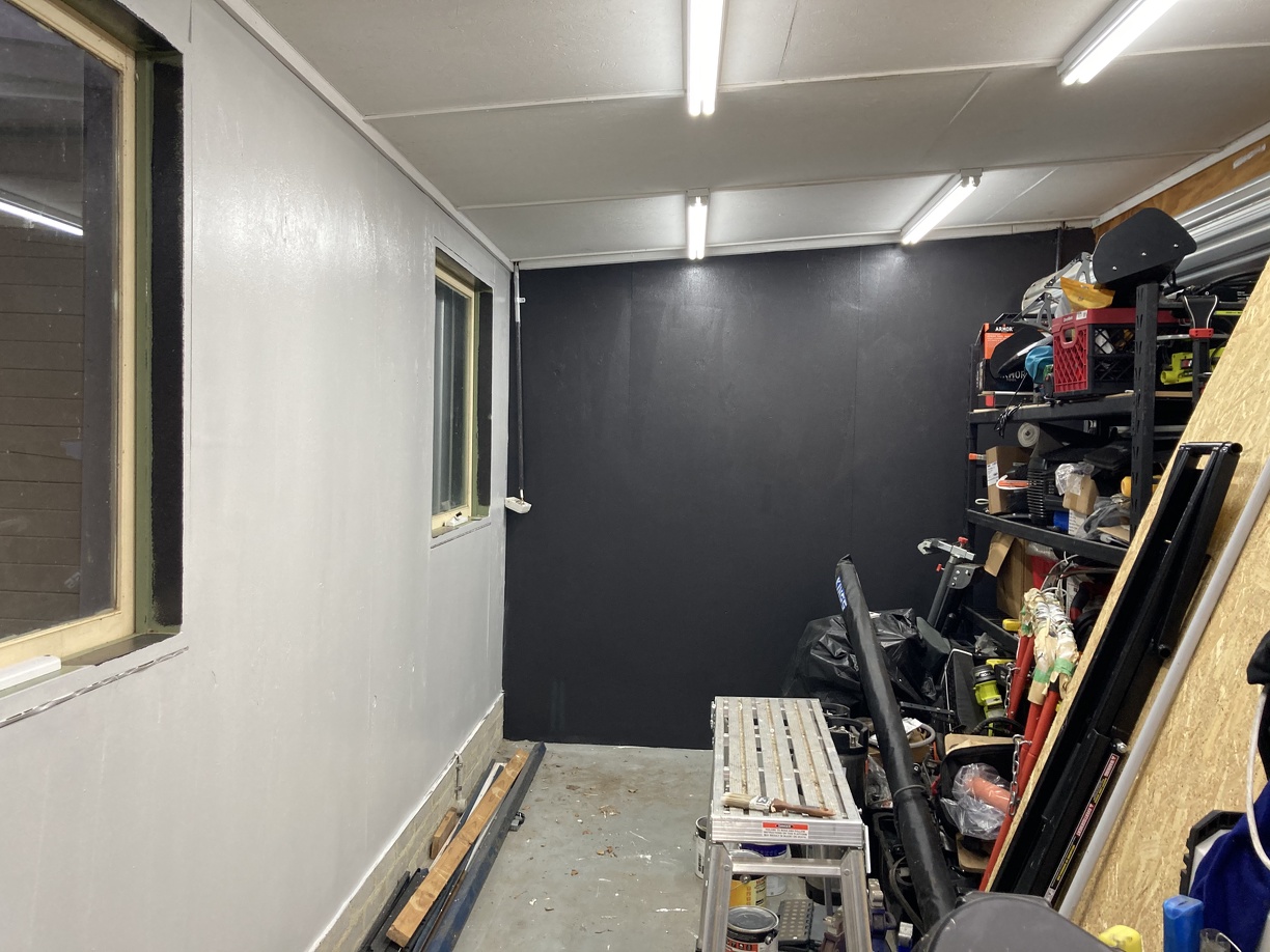

Then i got around to moving the stuff so i could paint the two large walls:
With that done almost all the painting is complete. Needs the 5000x300mm strip painted above the garage door, but that will have to wait until all the stuff on that side is shifted, plus a handful of little touchups around the place.
Hopefully the electrician is coming on Thursday to wire in the workshop and breakers and perhaps there might be scope to moving the mill and lathe in place on Saturday if the lockdown finishes up.

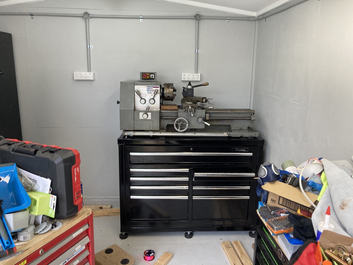

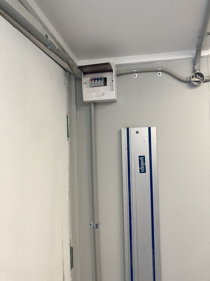

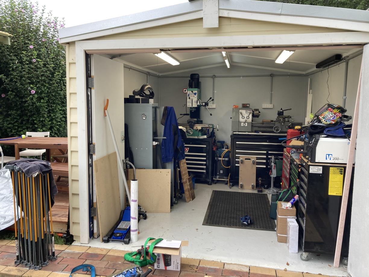

So after our brief lockdown the electrician ended up coming on Thursday to run the new feed to the garage (6mm copper) on a 32A breaker. This then runs the GPO circuit around the workshop, the lights for the workshop, a 15A for welders, and the general power feed for the garage (lights and GPO). Now all nicely tucked into bed:
That means there is now light in the workshop:
(and a ton of junk)
Using the two single battens from the garage along with the LED panel lights that I had from our previous rental garages.

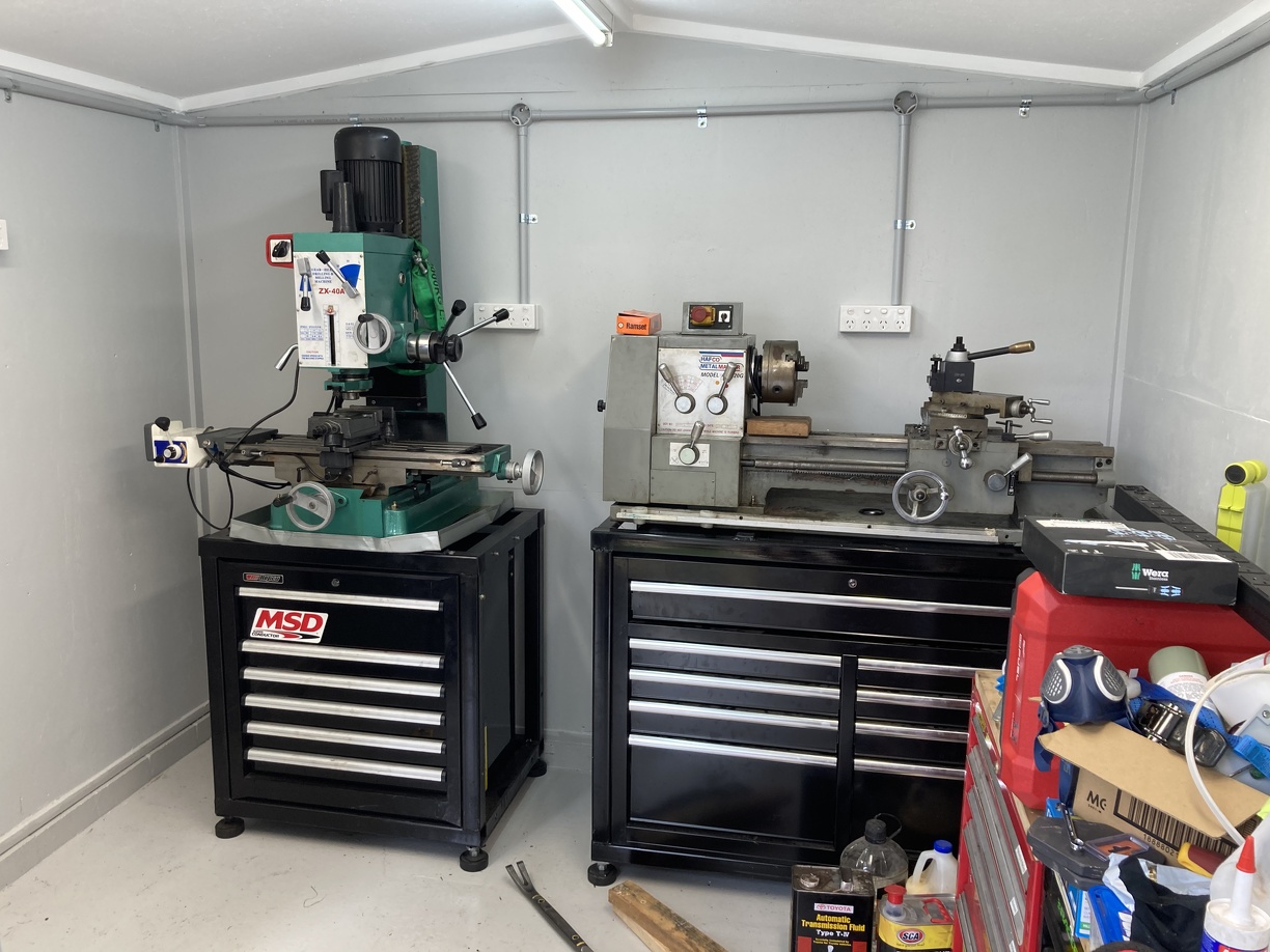

All of that together meant that it was time to get a move on with cleaning up and shifting things around for some heavy machinery to be put in place and then I can figure out where everything else goes.
First up was getting the lathe and stand in place, which was an effort using levers and dollys, plus an engine crane.
Then add one mill, which was even heavier.
Finally move in cabinets, welders, and other general machinery which means it now looks like this:
Next up I need to build some shelving above the lathe for storage and put up the french cleats on the walls. I have to decide where to put the scrap metal storage as well, but that is a bit easier to move about. I will eventually build a workbench over the two cabinets on the right, and the welding table will go in the front bay door. For now though the priority is the shelving so that storage can be constructed.

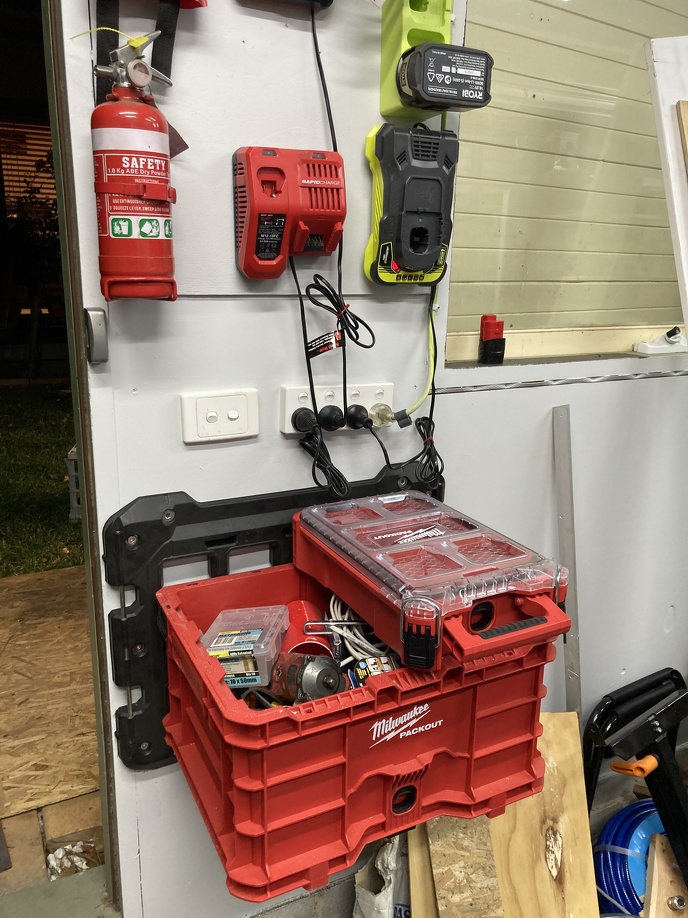

I also found the Packout baseplate and installed my overly expensive milk crate and holder:
Picked it up on sale a while ago so that it can be a universal drag stuff out to the camper trailer/workshop/hilux or wherever. Also planning on building a top for it so I can use it as a router table for woodwork. Maybe... if i get around to it.

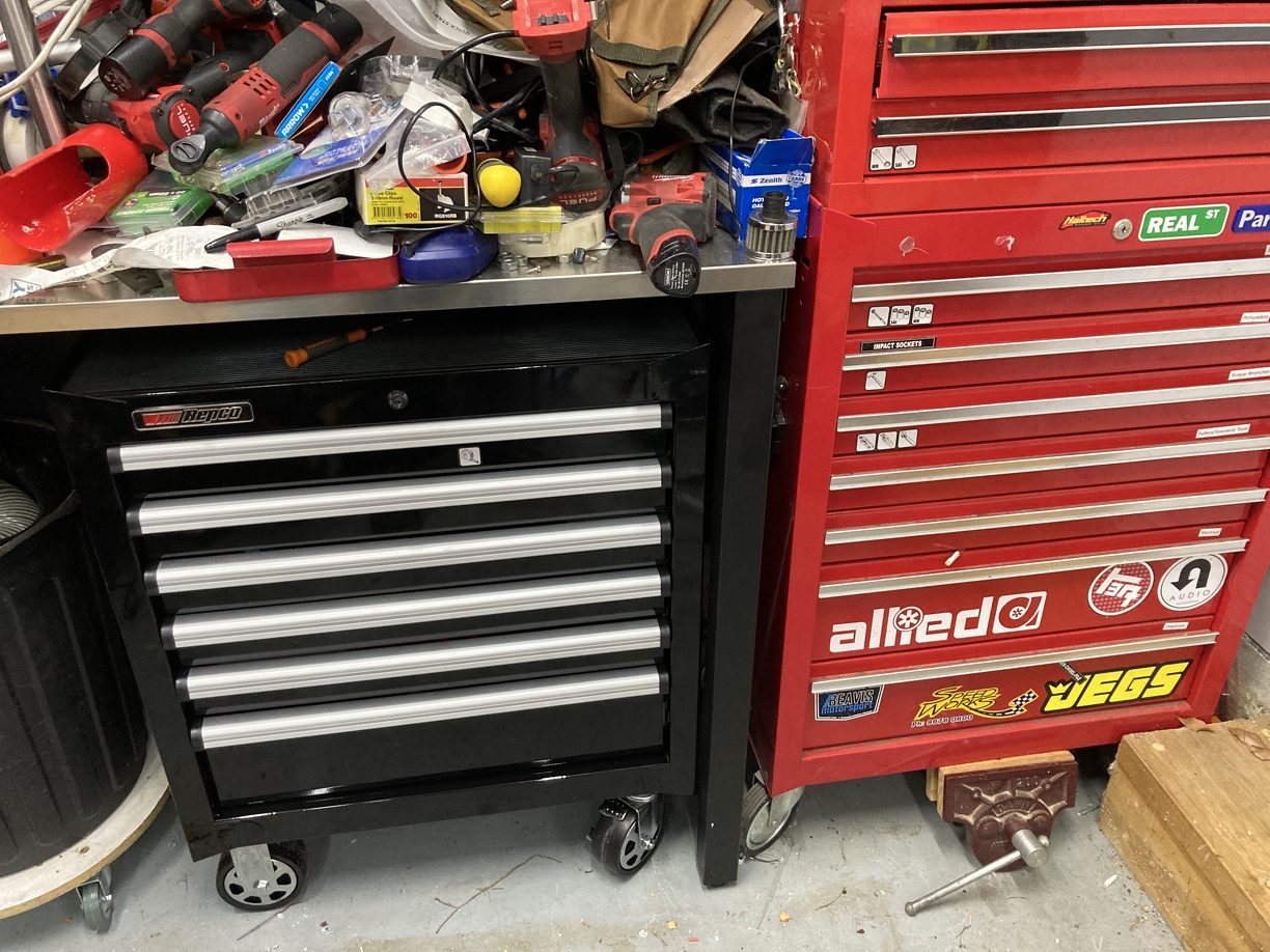

Finally I picked up this roll cab very cheaply a while ago and have had it in storage. Set it up and starting to transfer all my diagnostics and electrical tools into it:
That will make for enough room in my main cabinet to rearrange the automotive gear out of the two old roll cabs which can then be dedicated to woodworking and metalworking gear.

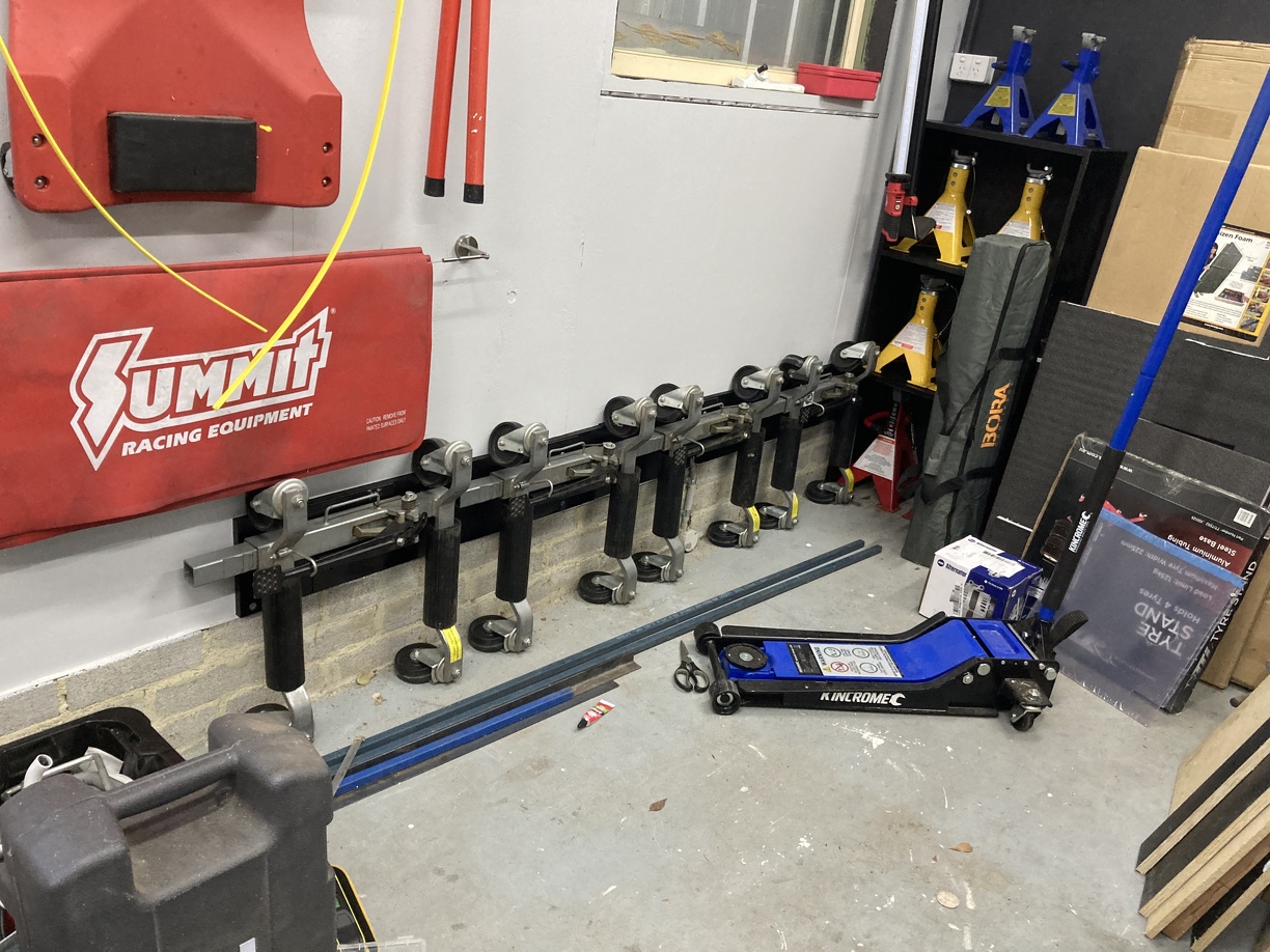

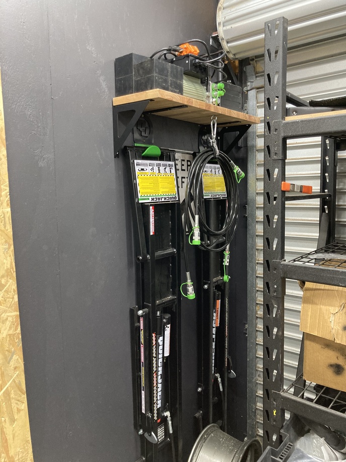

Finished building the storage for the Quickjaks, including waiting for the $25 brackets to come in from the US rather than spending $180 for them here:

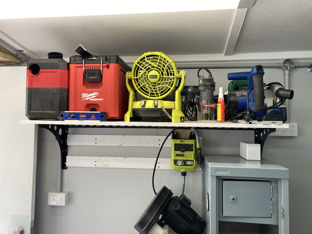

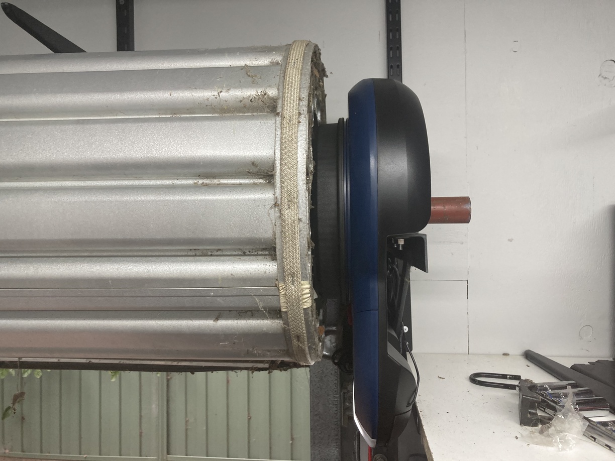

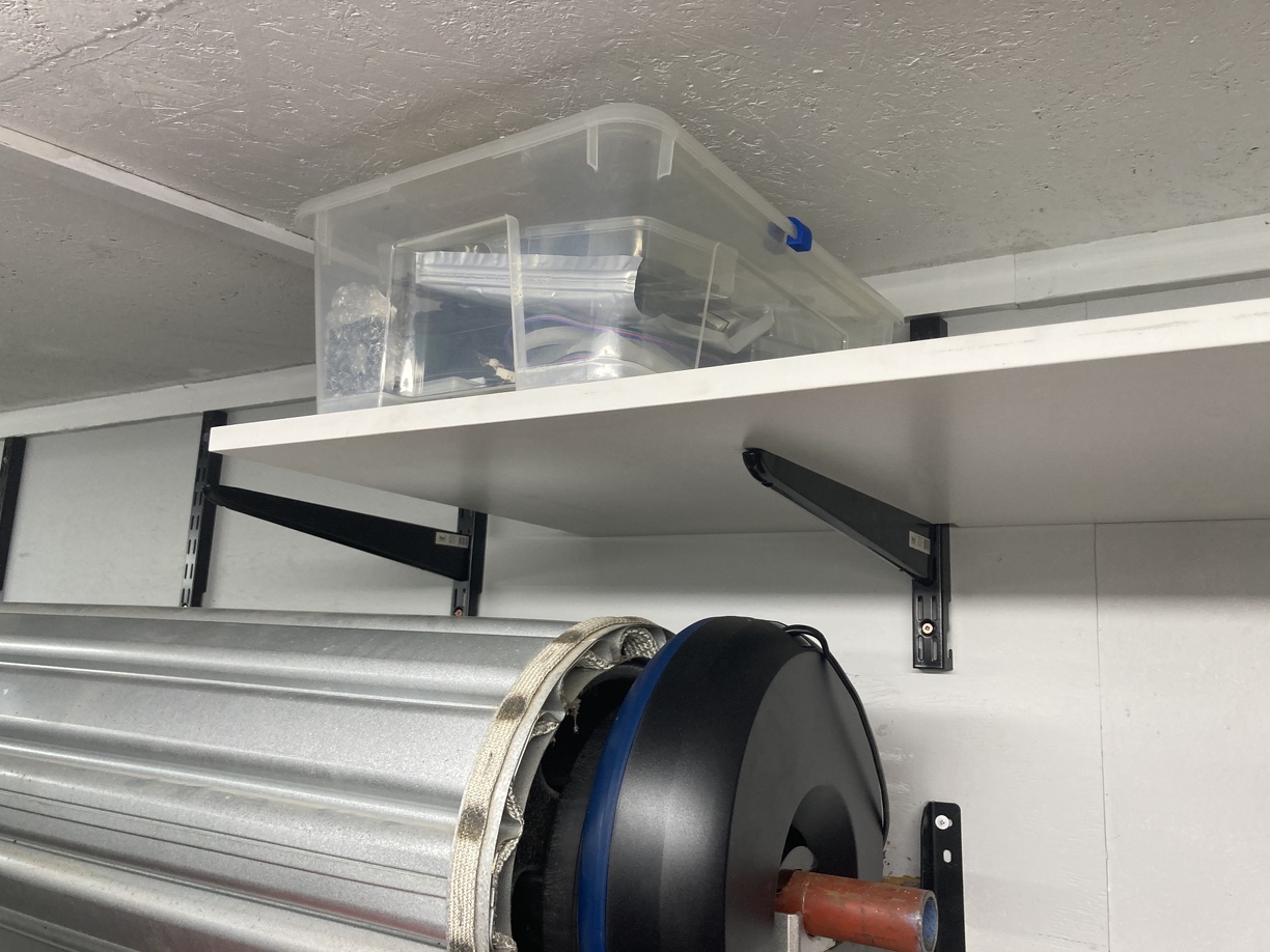

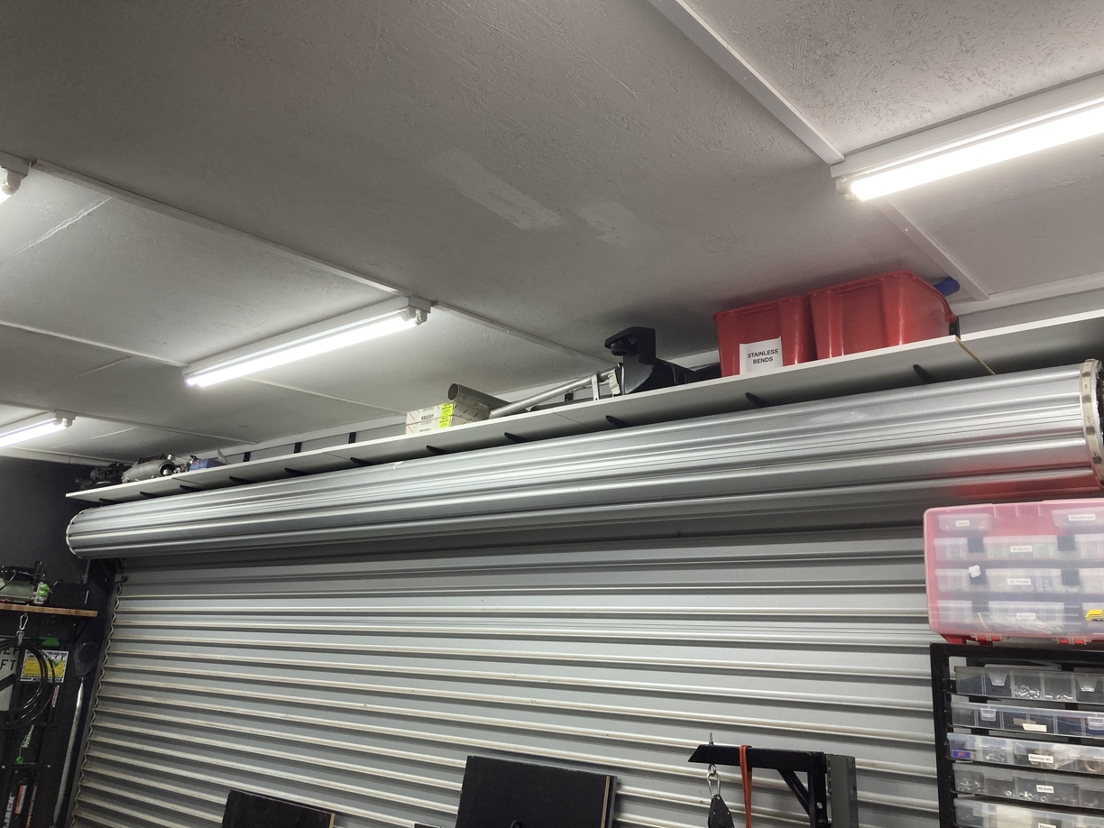

Then put up some shelving above the garage door:

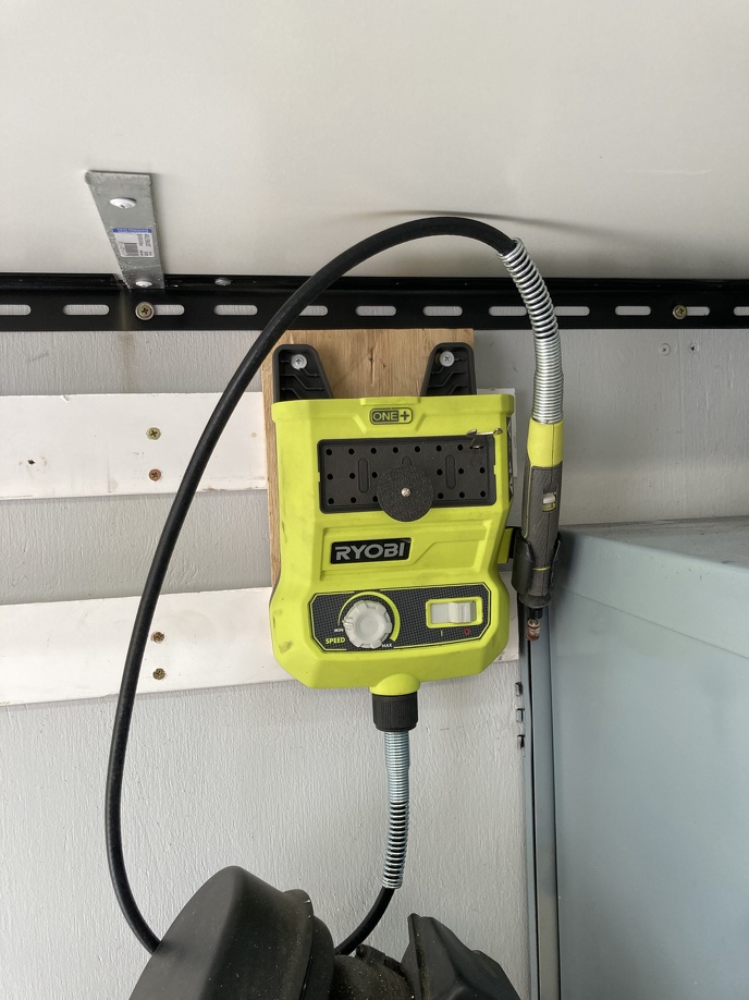

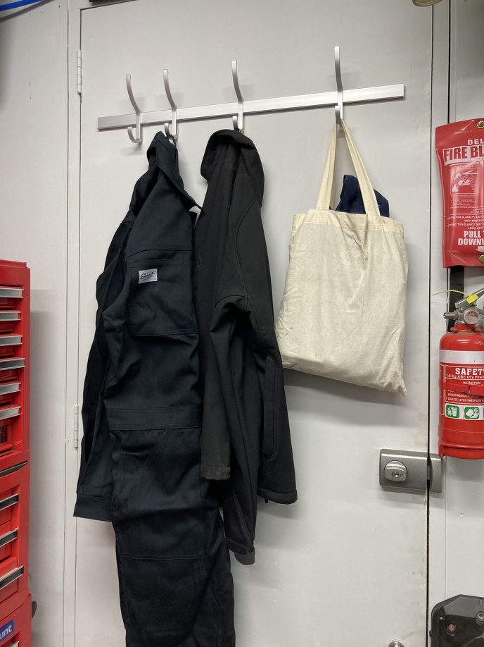

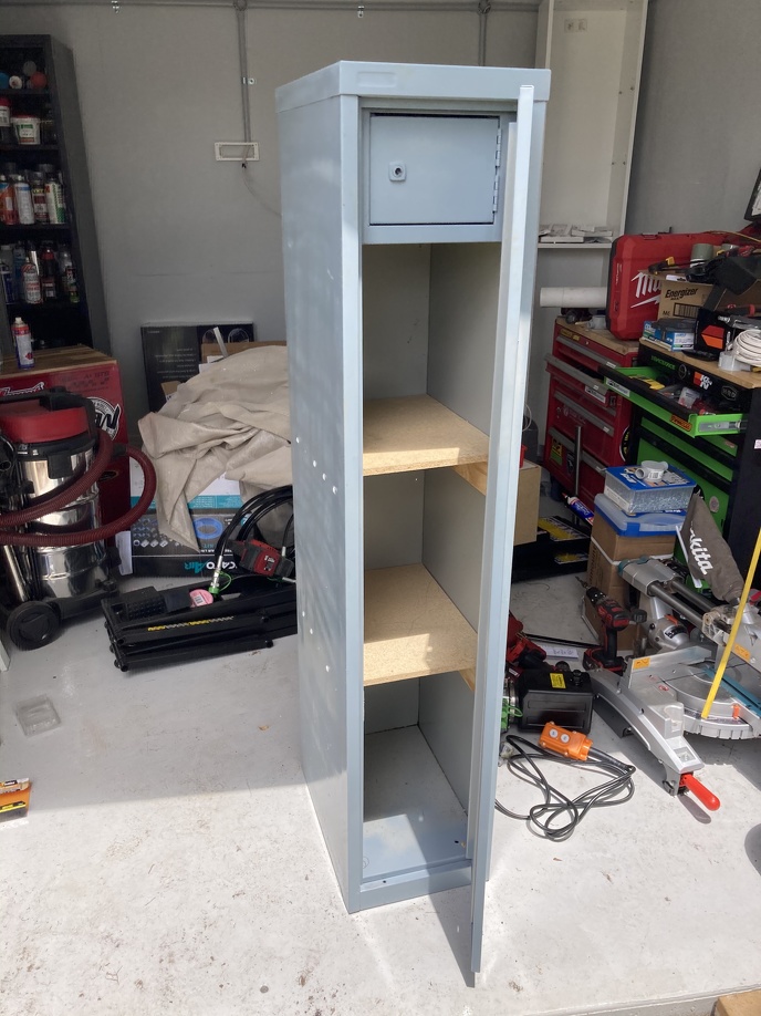

Plus nopics decided she didnt like the coat hooks we had bought for the hallway, so i grabbed them for the garage and workshop:

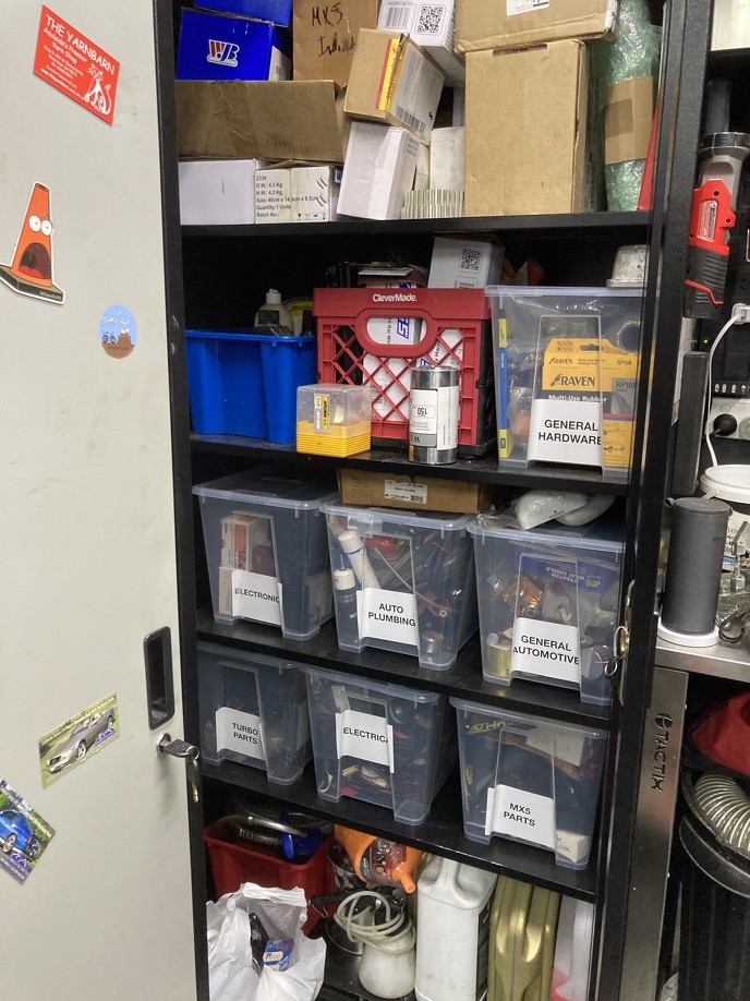

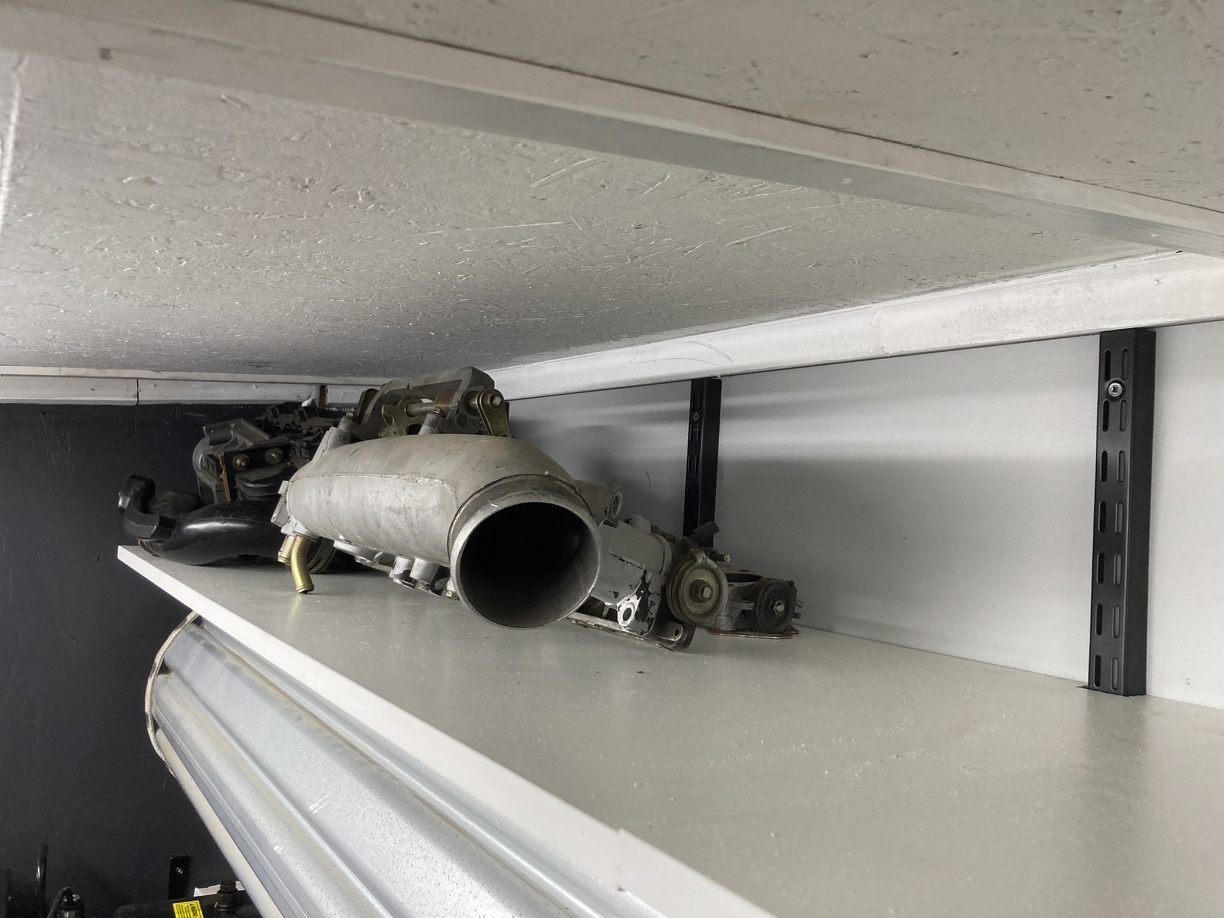

But really 90% of the time has been sorting **** out. I have stuff from 4 or 5 projects ago. But getting to the point where it is starting to look like this:
Top shelf there are mostly parts that will go onto the Hilux or MX5, as is the red crate.
Need to do the same thing for the grey cabinet in the foreground which holds most of my spray cans and stuff.
Will be good once its done, but its pretty soul destroying just having to spend hours cleaning and sorting **** out.

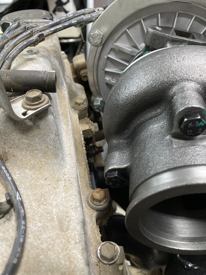

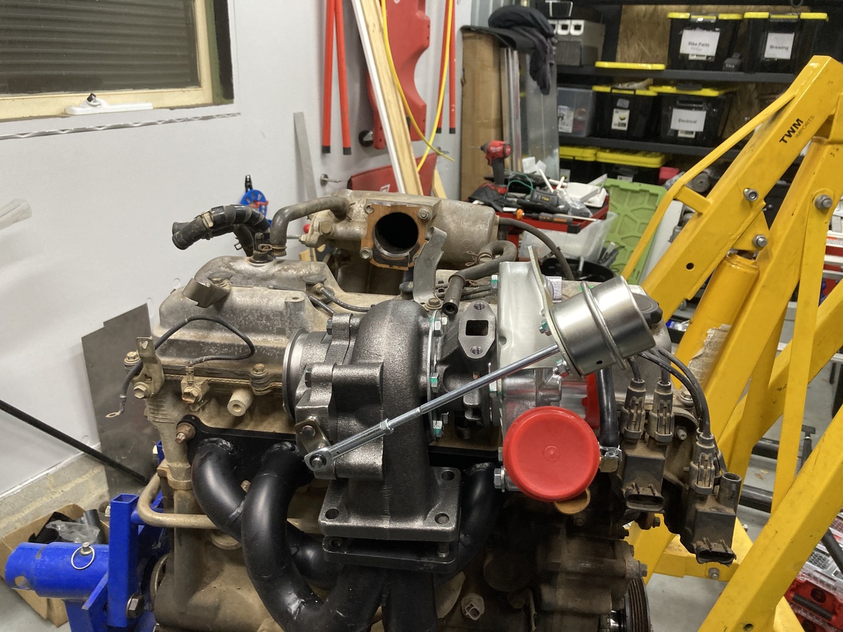

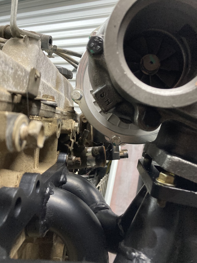

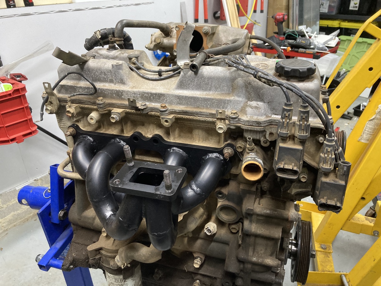

To vary things up I also dragged the spare Hilux engine in to the garage last night, which was dicey as. First had to get the engine crane down the stairs (garage is 300mm lower than the path), and then pull the engine over and let it swing into the garage. Managed to do it without any major damage:

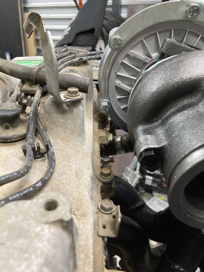

Got it up on the engine stand, and then decided to pop on a couple of bits that I had collected for it:
eBay manifold with random studs that i had lying around. Manifold seems decent.
But its clearly made for a smaller turbo:
Picked up that T3/T4 and manifold cheaply from eBay courtesy of some random code giving me a couple of hundred dollars off overall, so for $350 in the hole it isn't terrible. Trying now to decide whether i rotate the turbo and keep it parallel with the block or twist it 15deg to make it point outwards slightly. The second option makes it harder with the dump pipe, the first makes it harder with the intake.
Oh well that is a problem for future me.
T
takai
Jan 15, 2017
249
Melbourne

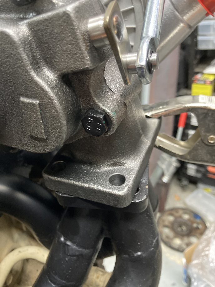

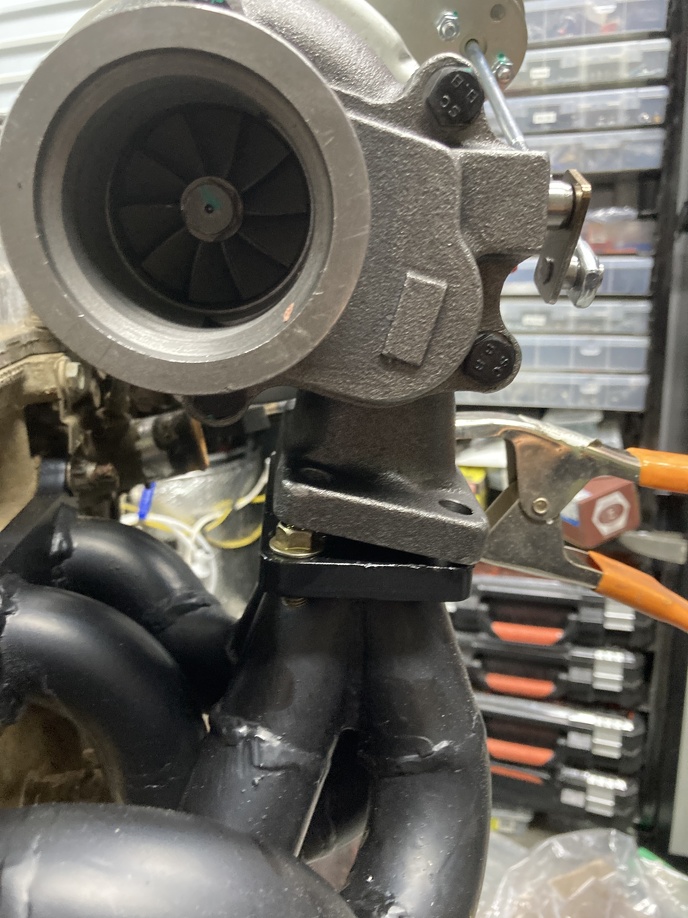

Had a brief muckaround after dinner with the turbo, playing with rotation or twisting the flange. A fairly small flange twist lets it all clear fairly well:
Its still close, but should work ok, and with a turbo blanket and insulation it shouldnt dump too much heat into the cam cover area. The disadvantage here is that there is much less room between the cam cover and dump pipe.
The other option is to create room by rotating the flange away from the engine, that i have simulated here with a couple of bolts in the flange holes:
That gives a reasonable amount of room, back to the engine, but might make the exhaust side a bit dicey. It does give more clearance for the exhaust housing though.
Not settled on what to do yet, will be waiting until i rebuild this engine and swap them over anyway, so can fix the turbo flange when the engine comes out. Big thing for now is to set up the engine fittings out of the car so that it is easier to do.

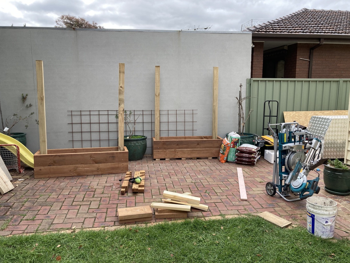

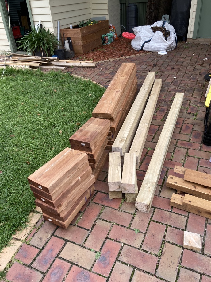

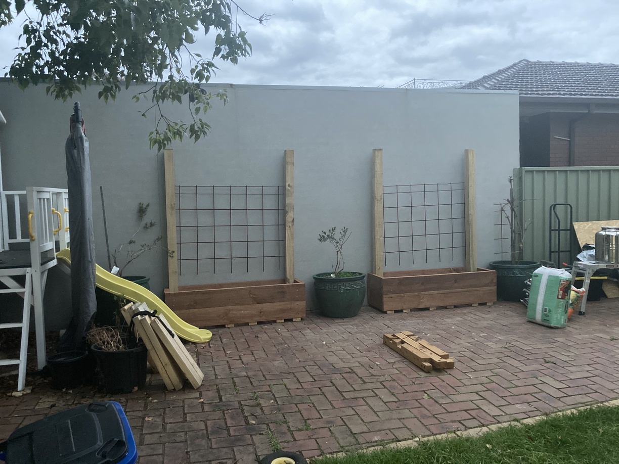

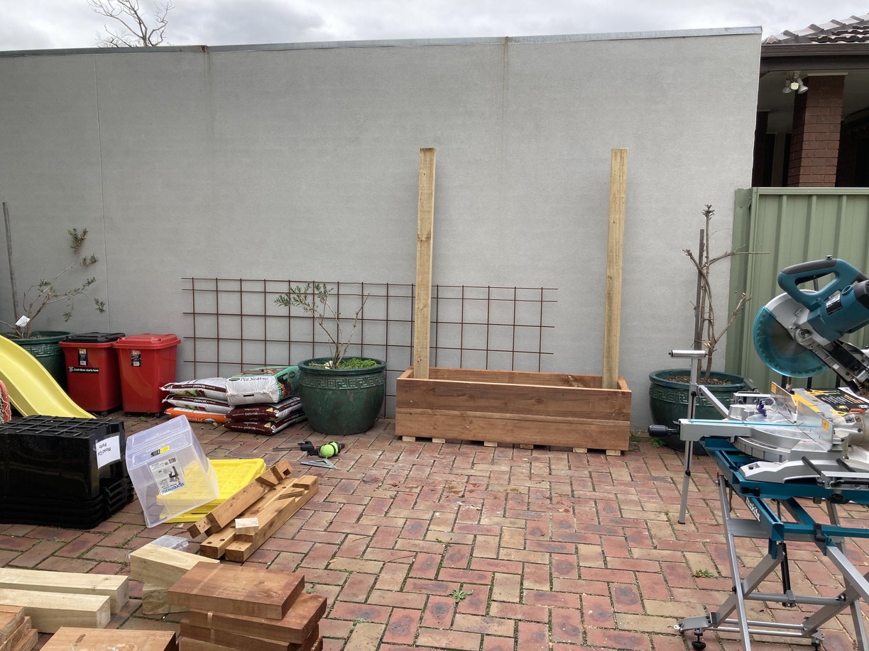

So after a couple of weekends of not getting much tangibly done i pulled my finger out this weekend and did some stuff. First thing was to generate a whole bunch of sawdust and convert a pile of wood into two planter boxes. Choppy chop:
One up:
Two up ^H^H and out of lag screws:
After a quick trip to Bunnings on Saturday this is how they ended up...
Annoyingly on Sunday as the wood dried out a little the two inner posts bowed and now it looks all skewed. Oh well, with plants on it you wont be able to notice.

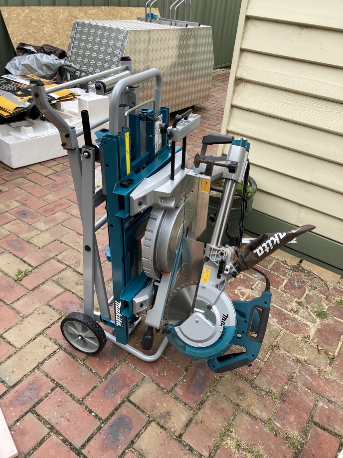

All of that was made much easier with the new saw stand i bought for the mitre saw:
Folds down really well and makes for a much easier time moving the saw around and getting it setup in position. Definitely recommended.

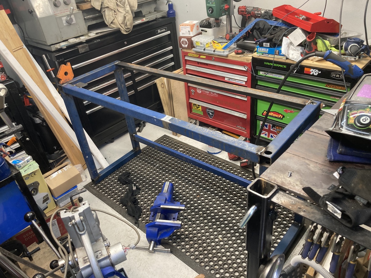

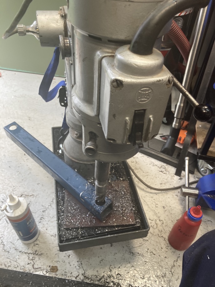

On Sunday I made a start on the new workbench to sit in the workshop over the red and green rolling cabinets. First up was to get the ancient German mag drill running. Its old and clunky... but like Clarkson says: "POWAHHHH"
Works a treat with annular cutters.

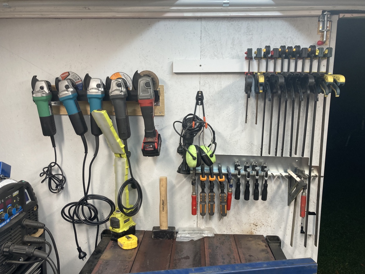

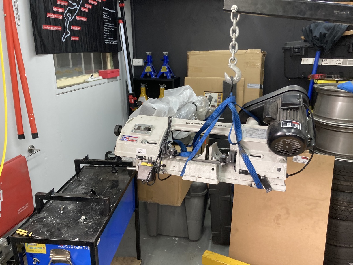

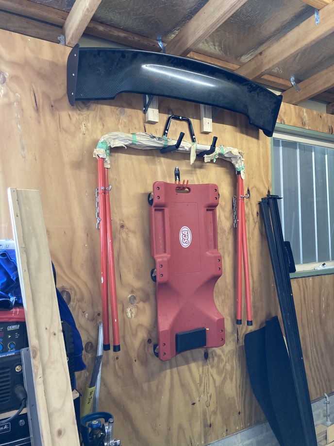

I then realised i was out of space on the welding bench because of all the clutter, so i finally built the angle grinder rack to go on the door, third modification on the same old rack i have had for ages, first time it has had paint:
Put it on some metal french cleats as well so i can move it to the side of the welding table if needed.

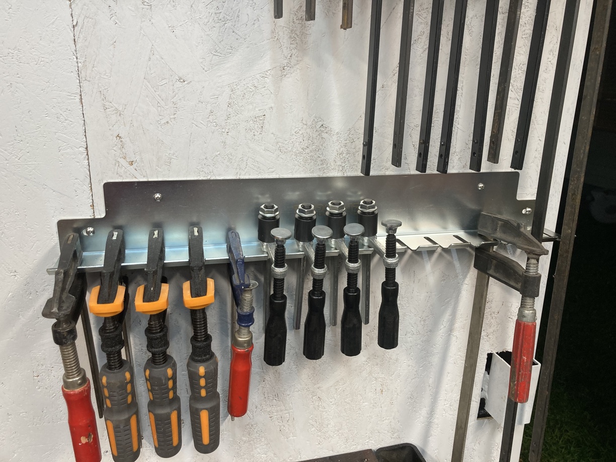

A while ago i had picked up this Torquata F-clamp rack, which made its way onto the door:
Now everything looks a little neater:

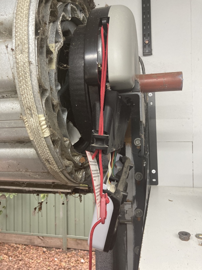

Ended up just removing the bracket from the wall and supporting it on an adjustable scaffolding strut that i picked up from hard rubbish earlier in the year. Worked a treat.
Anyway with that in place i could then see if anything would actually fit in the space above the door, and what do you know. Win:
That setting has plenty of clearance with the door up, and should be able to fit enough smaller stuff plus that size crate up there.

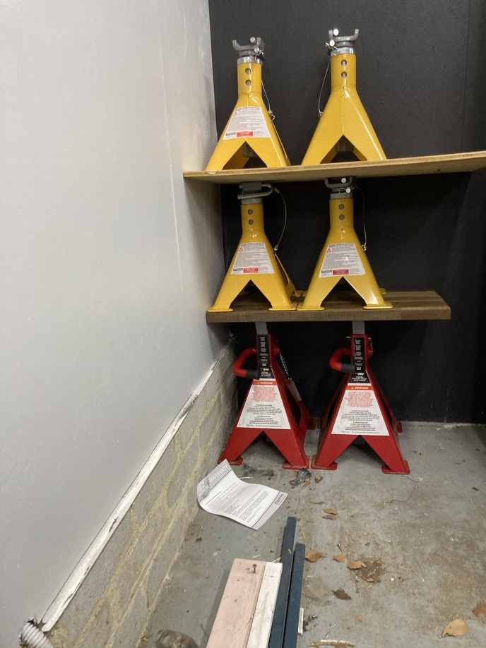

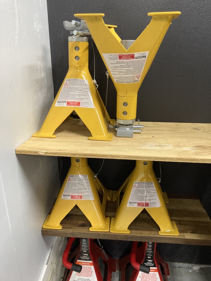

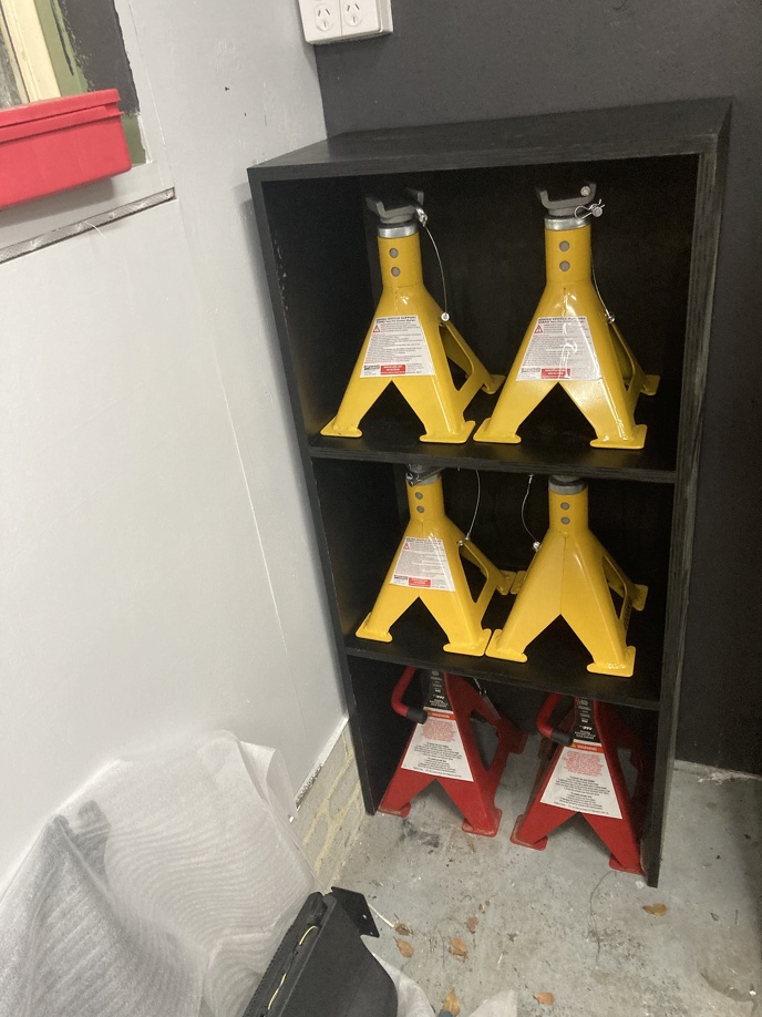

Finally i started thinking about how i would store all my jack stands. Considering just building some cubbies for them like this:
I toyed with inverting one like this, but not sure it gives me much benefit:
Anyway, should be able to finish welding up the workbench this week and then get it in place when it stops raining.
Plus with the new setup above the garage door i should be able to keep sorting stuff into those containers for longer term storage which will be useful.

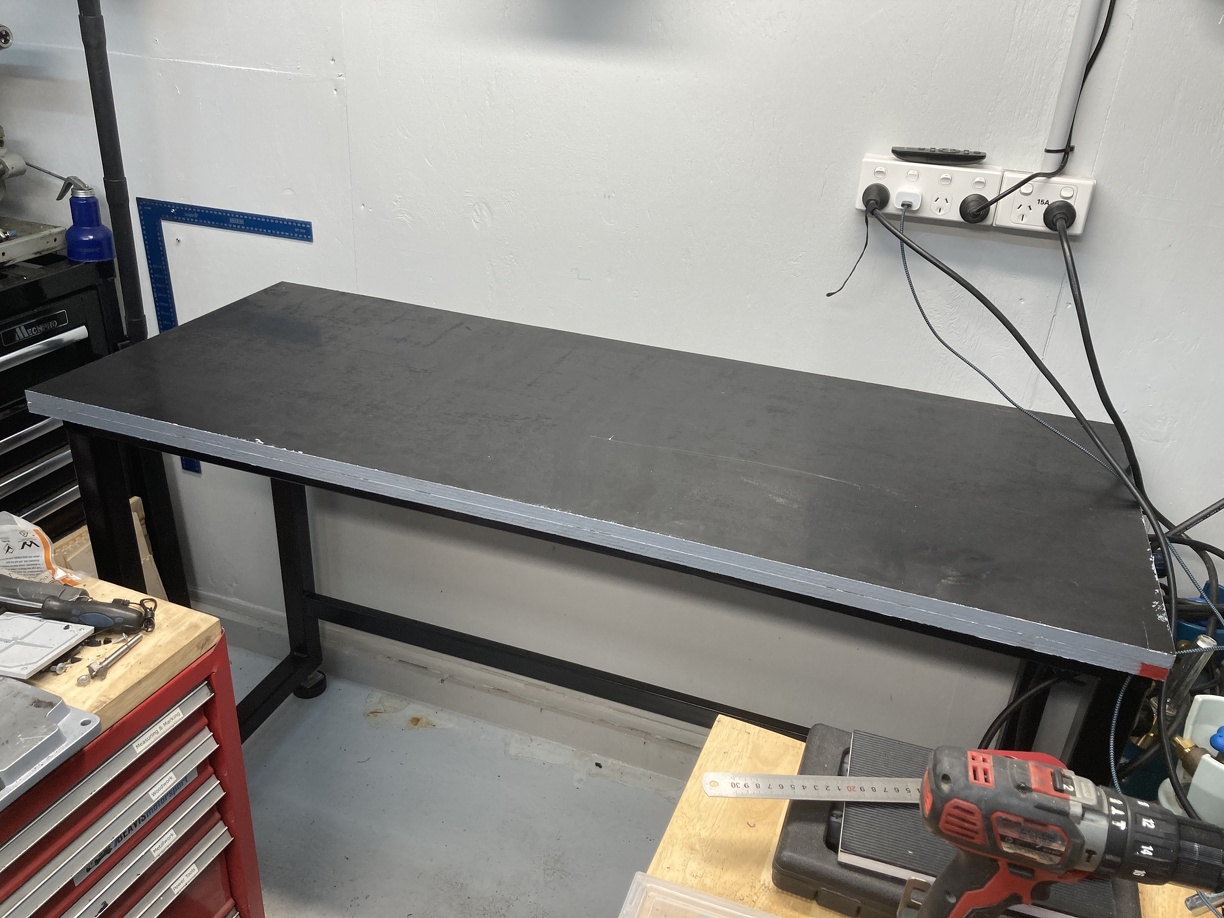

Another weekend, another few bits done. Not huge progress but posting to keep motivation up.

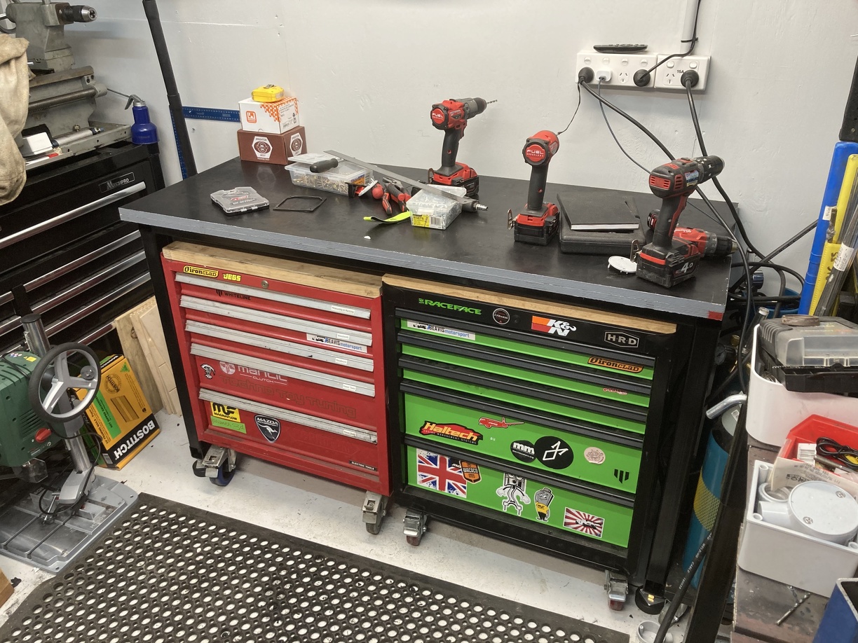

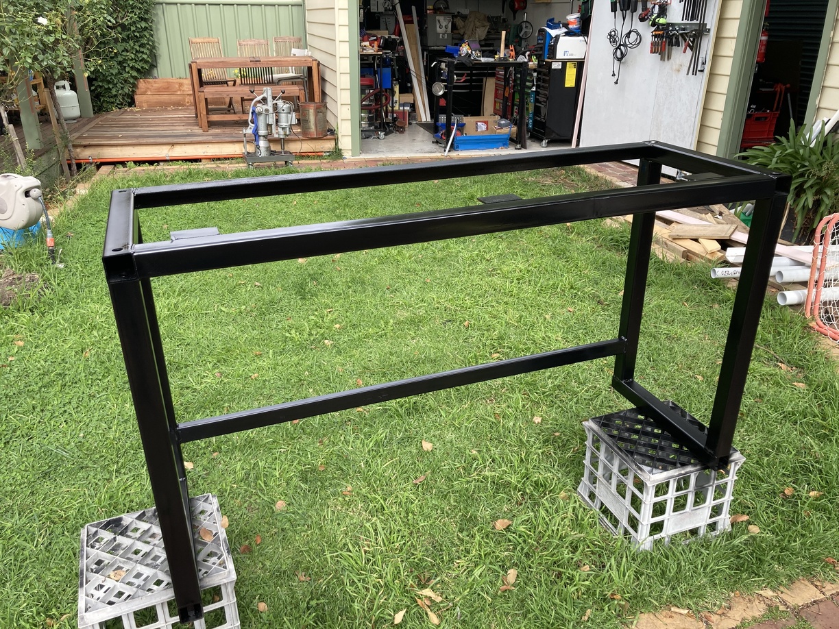

First up was welding together the new work bench:
You can see there my brain dead moment last week where i drilled 8 extra holes on the top rails which were just not needed at all. *facepalm*
Oh and true to Murphy I ran out of gas while welding on the final brackets to secure the top... typical
Anyway after a trip the next day to get gas, and then a coat of paint:

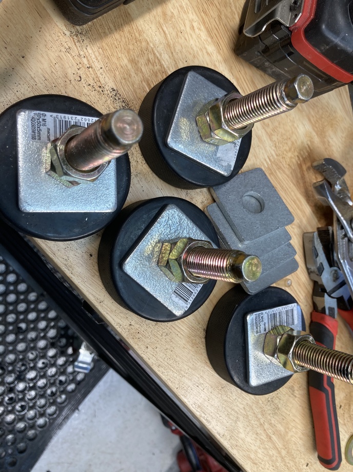

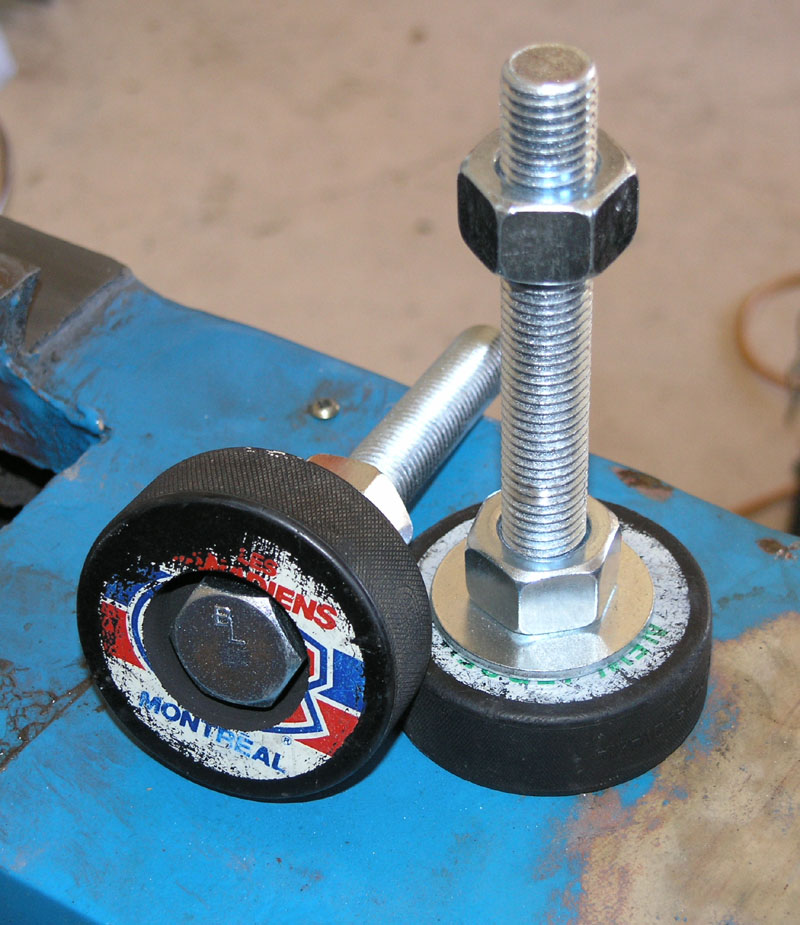

Built up some more hockey puck feet:
That box of 25 pucks that i brought back from the US in 2019 has proven to be very useful.
Then add some formply for the top:
And cabinets:

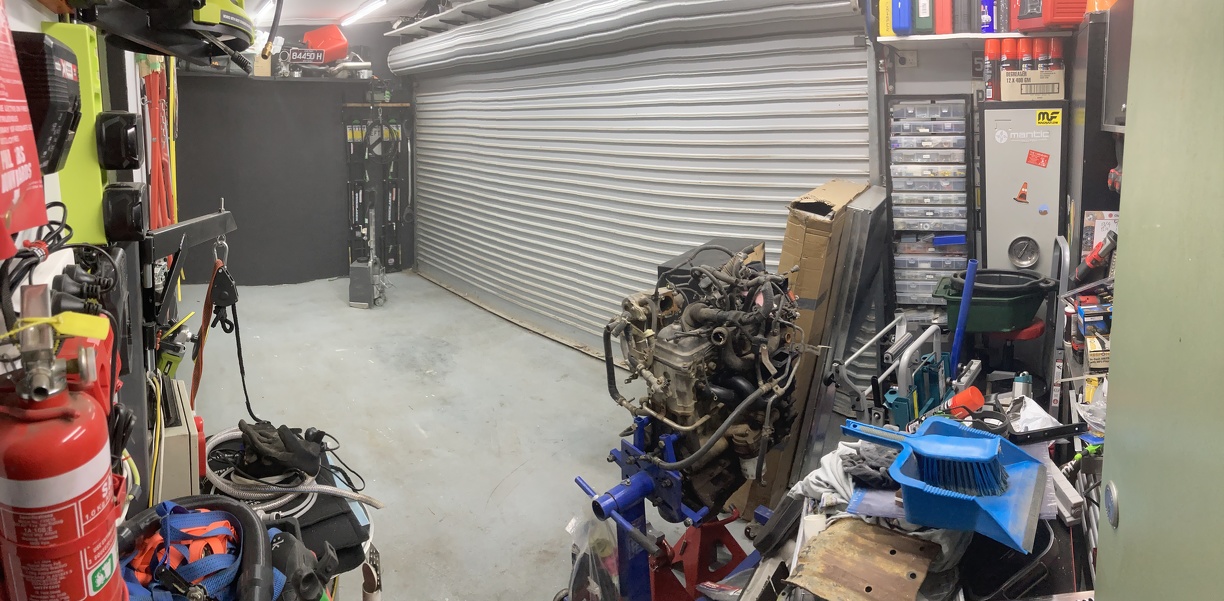

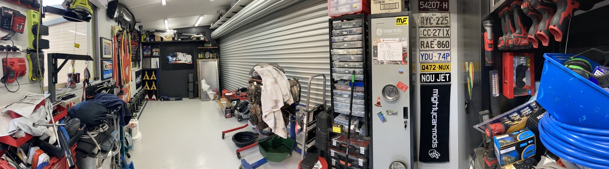

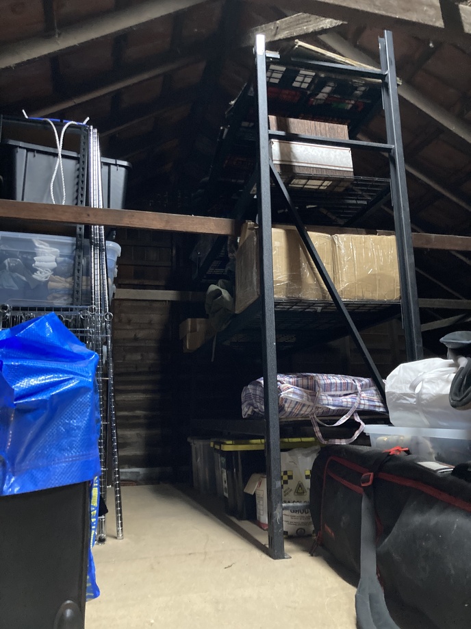

With that sorted out i then took to fixing up some storage in our attic which involved assembling this massive pallet rack:
Ended up having to assemble it around the beams, but it works. Nothing too heavy up there just a box of cables and then crates of baby and kids clothes.
Finally, I kept on sorting out the garage including getting a ton of small boxes setup above the garage door:
Getting some clear floor at last. It is a slow and tedious task, but needs to be done.

Can you please post a pic of the opposite side of the hock puck feet so I can see how the bolt is attached/fixed through it. Thanks!
I don't have any pics around but it is just a nut welded onto the stud to form a bolt head and then recessed into the bottom of the puck. Here is a photo of someone else doing the same thing:
We can't cheaply get hockey pucks here in Australia, so i picked up a box when I was last in the US. Using M16 chemset anchor studs there as they are a cheap source of threaded rod in the right sort of length, and then 50x50mm M16 square washers.
Basically the washer acts as the load spreader over the surface of the puck and it is just sandwiched together.

Nice work on the feet, I had the same issue with hockey puck supplies. Ended up ordering a heap of feet from alibaba $1.5 each I think plus postage
Ah nice. I didnt think about Alibaba. These were more of an impulse buy while i was in the US.
T
takai
Jan 15, 2017
249
Melbourne
No smaller washer on the bottom, the underside of the bolt is chamfered enough to not worry about it and once its locked together it wont be moving as it isn't loaded in that direction (or if it is then there are much bigger things to worry about)

I spent the last week at home with our newborn, and got a few moments throughout the week to potter around in a sleep deprived daze in the garage to get a few little projects done.

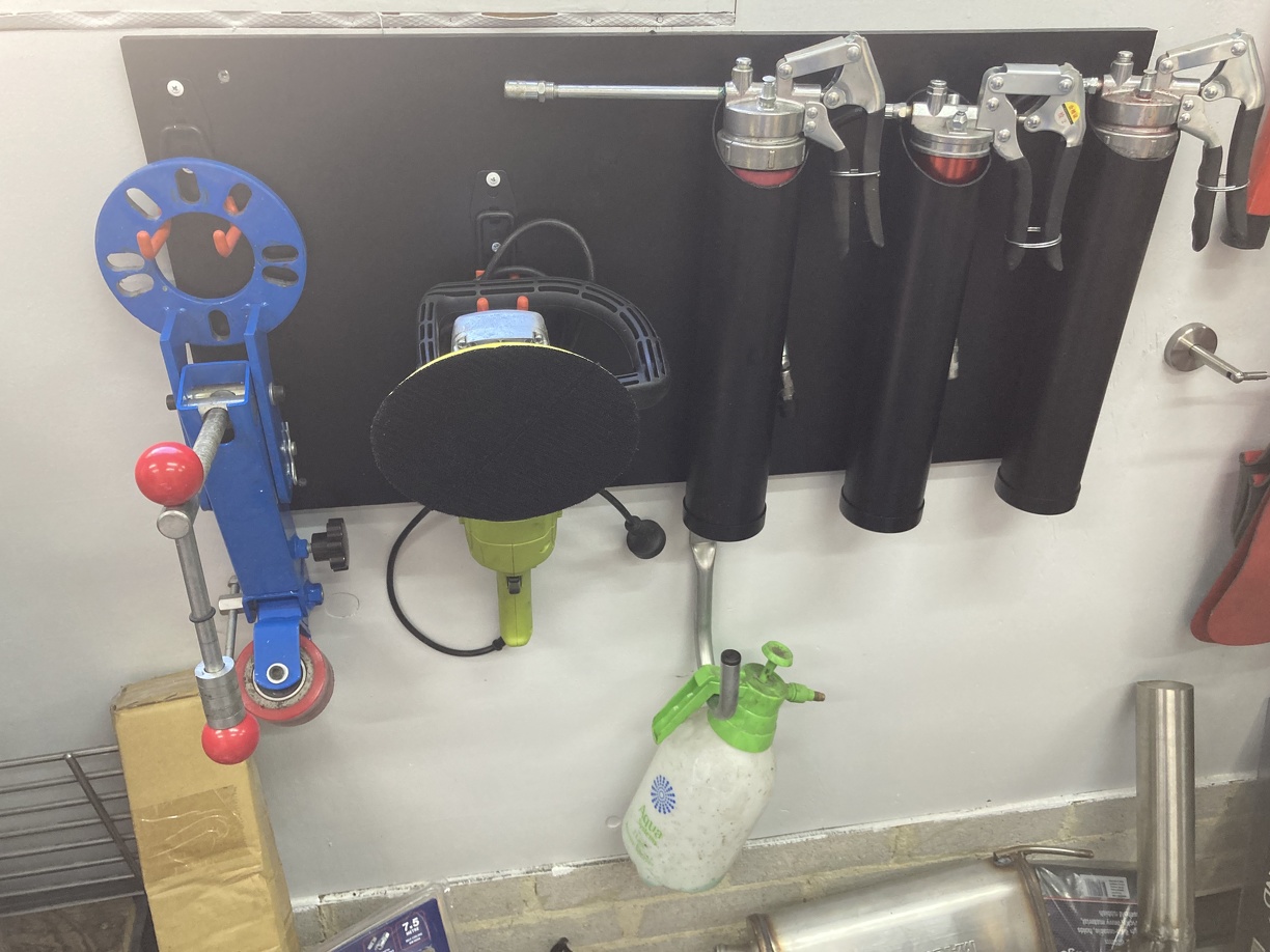

First up was giving the grease guns somewhere to live:
Just a quick little set of 75mm pipes with end caps. I have a few smaller pieces of 20mm conduit to be screwed down as well to secure the hoses.
Also gives a convenient spot to store the other bits
Plus rejigged the benchtop tool storage using some Stealthmounts.
Then built a small box to hold the jack stands:
And rigged up some brackets to hold the GoJaks:
Just using some spare 100mm angle lintel that a neighbour had turfed out for hard rubbish. Massive overkill, but as they say, its my second favourite type of kill.

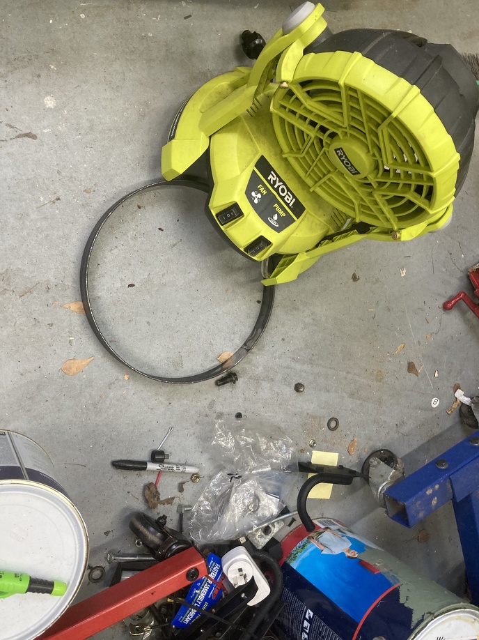

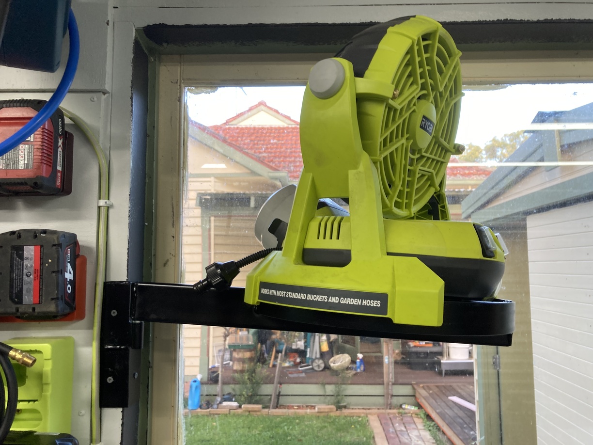

Then started on some tool holders for my welding bench, which i had designed around being able to use 50mm trailer hitches, and quickly welded this one up for my ring roller:
So then i could roll a ring for my Ryobi bucket fan to sit on and be mounted to the wall, like this:
Pretty simple little setup that keeps the fan out of the way, plus gives a usable fan for heat or steam from the brewery without having to get a new fan to mount to the wall. This way i can still just take it off when we go camping etc.

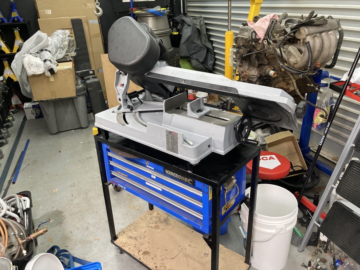

Then I managed to get the bandsaw off the old stand:
And build some mounts to put the new bandsaw back on it:
Looks like it will work pretty well. I'll build a hydraulic downfeed for it later on, based on the one that ships with the Grizzly version but that can come later.

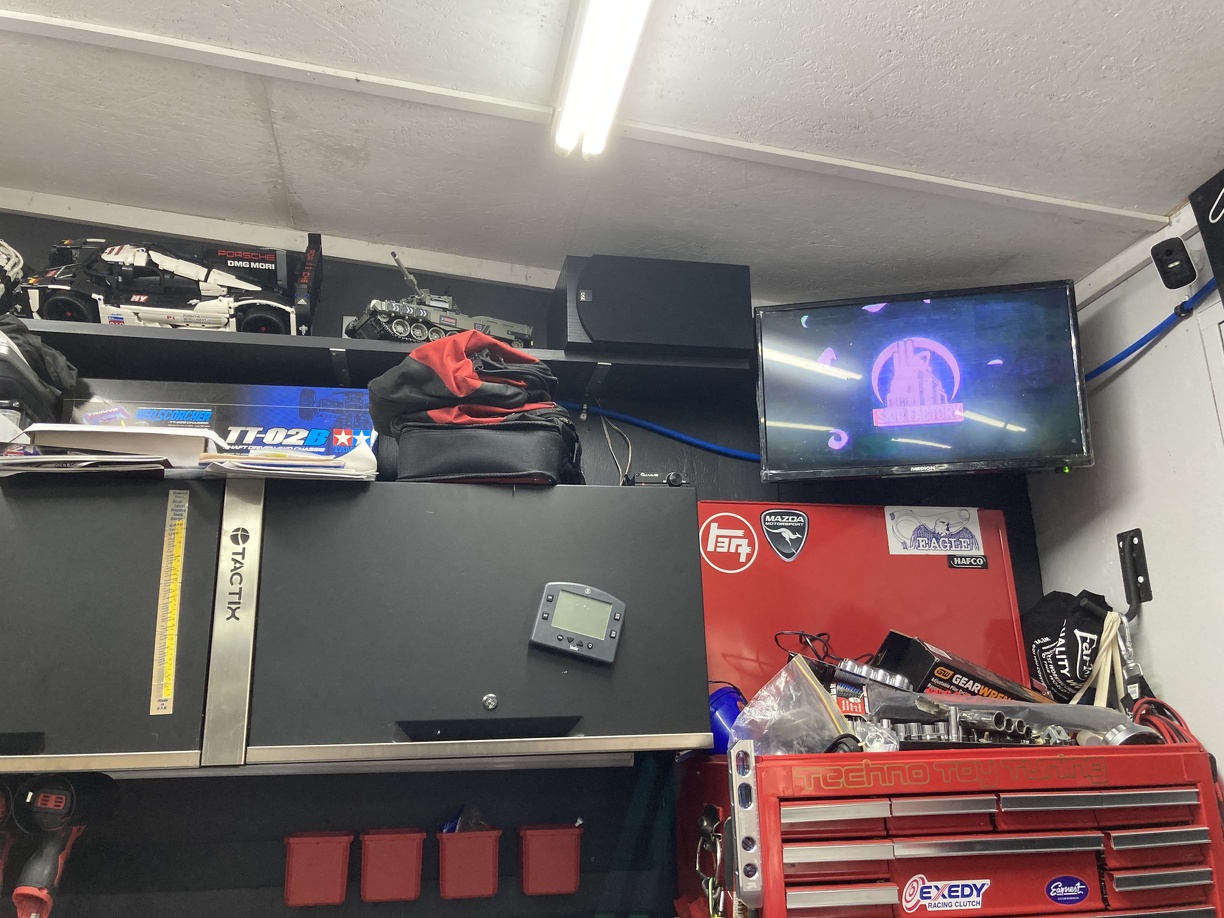

Oh and i managed to finally get the TV and speakers hooked up:
Plus added the first piece of decoration because of the Nurburgring 6hr race yesterday:

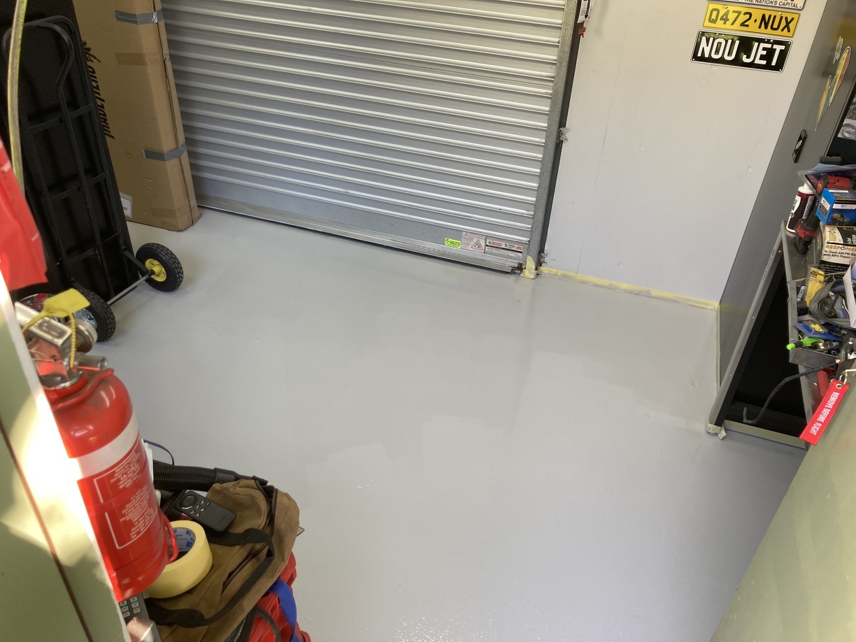

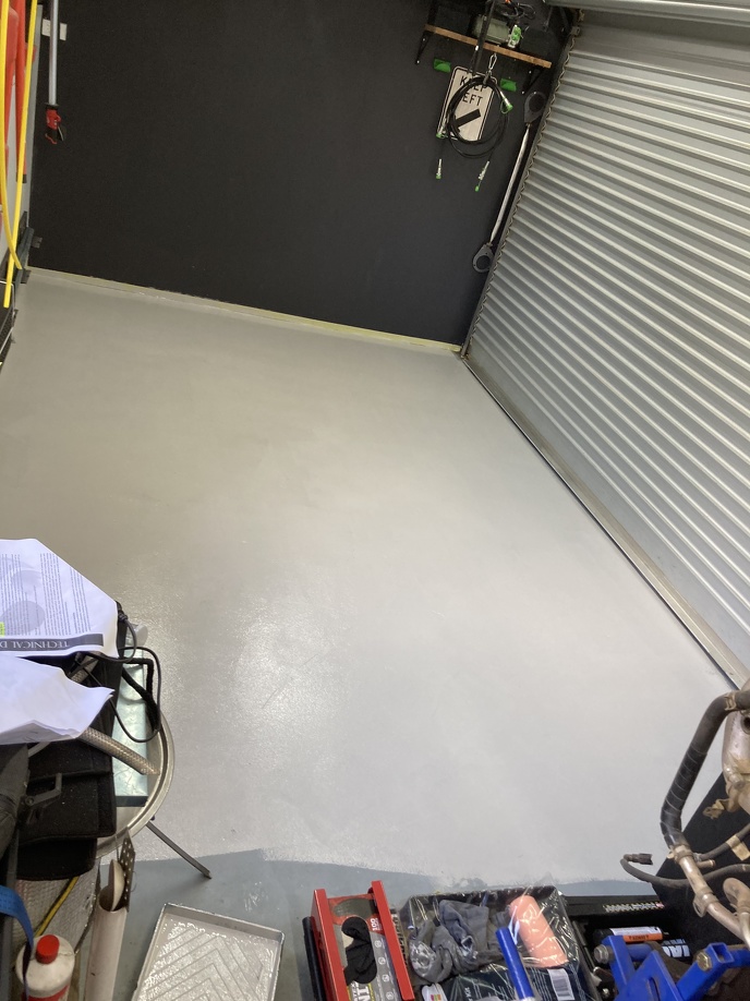

So, this next phase has taken a while, but mainly because it has been so cold and rainy. First up i needed to tidy up the garage so that I could shove all of the big and heavy stuff down one end:
i.php
Because it has been so wet I couldnt just dump it all outside, and so therefore i ended up doing the silly epoxy in two parts thing.
That was so i could sand the entire garage:
Then i could epoxy one end of the garage:
Wait about 10 days because its so cold that its taking forever to cure, and then epoxy the other end:
Managed to feather the coats together such that its hard to see where they overlap.

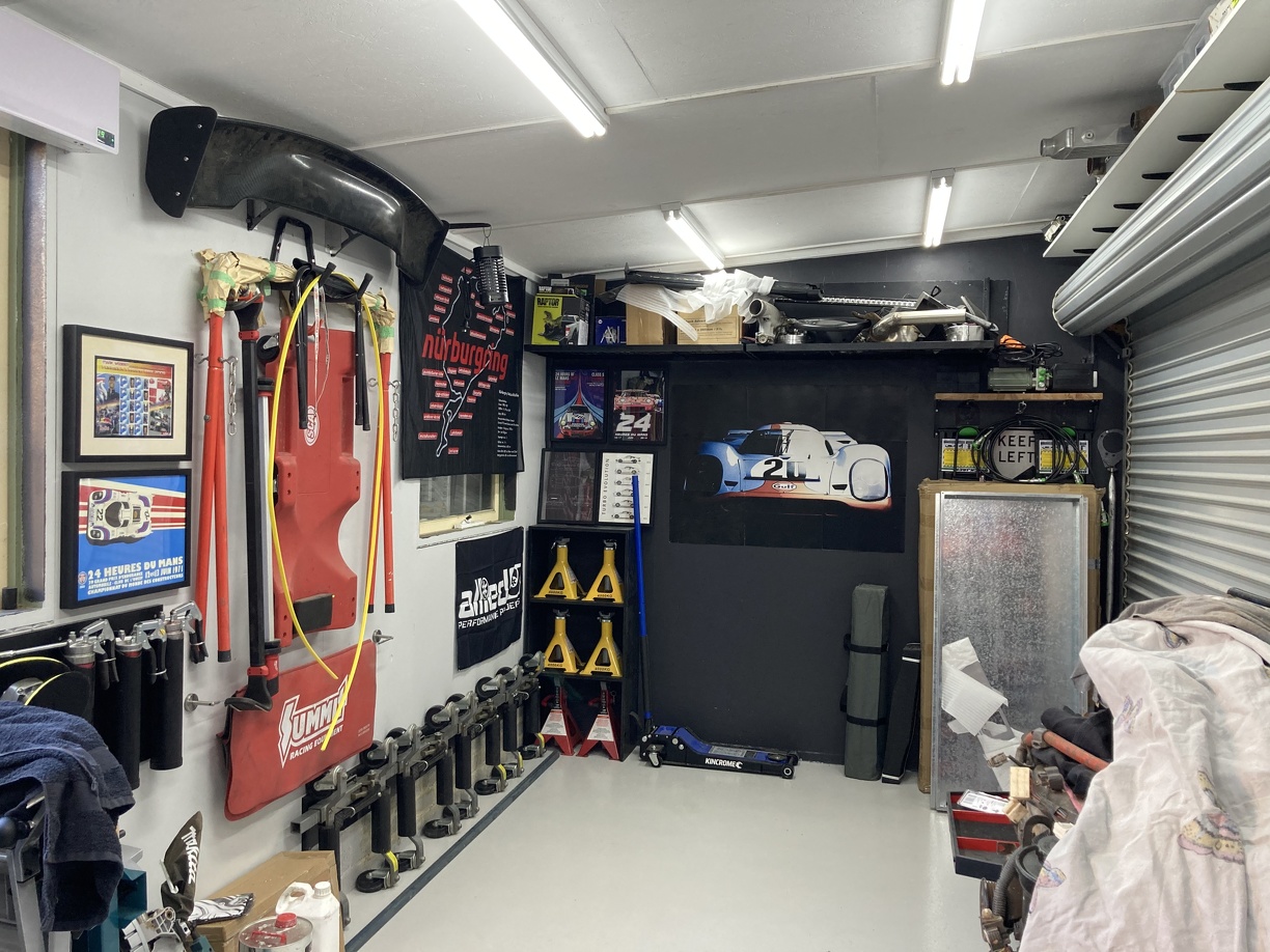

Finally I could get everything back into the places they were supposed to be, and get the artwork up on the walls:
The GT40 print i have had sitting around since 2011, but never had anywhere to put it.

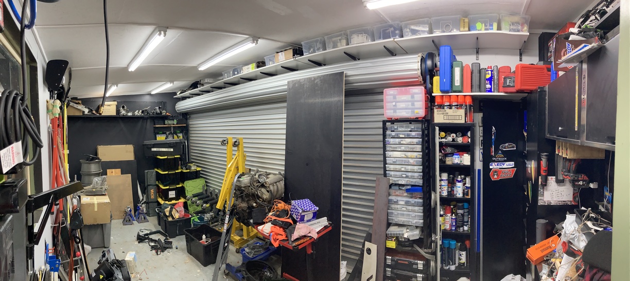

And also a pano:
Still need to tidy and sort the stuff on the workbench and in the Milwaukee packout crate, but its like 99% done
Currently we are in lockdown, but once we get out I should be able to get the MX5 through and then i can start working on that again.
The end of working on the garage rather than working in the garage is in sight!

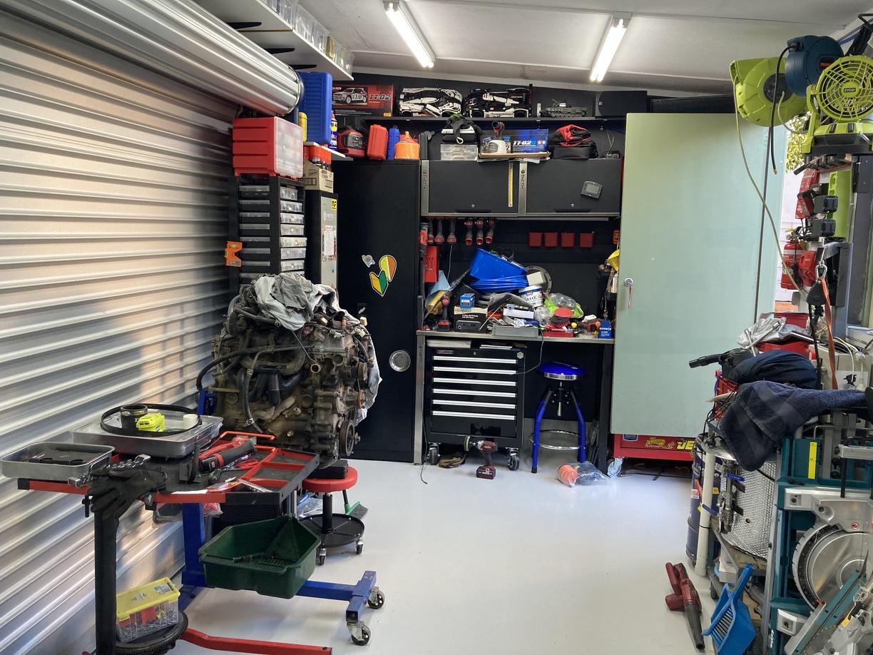

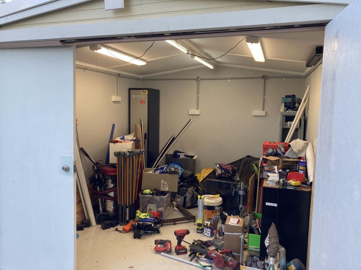

Anyway, the garage now looks like this:
Couldn't stay so clean for that long anyway. Still have to clean up and tidy the workbenches and sort out some storage for 3RZ bits while im waiting to rebuild it. But it finally feels like I can work in the garage rather than working on the garage.

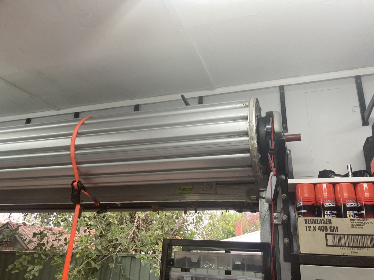

That was followed by a Maximum Effort (oh wait that is trademarked) to get the bull bar off, as all of the bolts were covered in mud, rusted and seized, and then i had to slowly lower the bullbar solo by hand (a friend still has my jack and we are in lockdown). But it is off:
That thing needs to go on a diet, especially with all the roller hardware for a steel cable winch. But that can wait for a bit. Oh did i mention that I attempted to remove the indicator plugs carefully, and they just snapped off... ugh. Time to rewire with Deutsch connectors.
Anywho, got stuck in and started pulling apart the engine for removal, and got to this point before my fingers were so cold i couldnt tell if it was the connector disconnecting, the plastic breaking, or my bones cracking.
This is the first time in about 15 years that I have pulled an engine with care to keep the AC stuff together and not just started cutting hoses because it was all going to be replaced. So much easier when you are building cars that 90% of it will be changed. For this one I think the only thing ill end up replacing with other gear is the fuel side of things, and just to swap that over to AN fittings because the stock stuff is pretty average.
As you can see its a pretty messy old engine, there is so much oil sludge and residue on the intake side down low that its probably going to spawn a monster or something, and I have no idea how that alternator belt was still holding on:
Coolant stuff is also pretty badly corroded, which thankfully I have better condition stuff on the other engine, but I just hope that the block itself isnt terribly corroded.
Either way i should be able to pull the engine out soon, and then the fun can begin of assembling one good engine from two. Plus perhaps a bit of scope creep.
This is where I left it for now though:

Had a bit of unexpected time today to work on the Hilux, as I was originally expecting it to be pouring. Finished stripping off the rest of the ancillaries (starter, alternator etc), and then started to figure out how to get to the upper two gearbox bolts. Because the engine is canted over one of them is pretty much exactly in the middle of the trans tunnel and almost impossible to get to, while the other is obscured by the transfer case and front drive shaft.
Figured the easiest way to try was to get the gearbox crossmember down and then squeeze long extensions up from there.
To do that I needed to do some literal archaeology:
The crossmember was so full of mud that there was no getting to the bolts, and it took me about an hour with a cold chisel and hammer to dig through the mud and rocks:
No idea what the previous owner/s have done to get that much **** into there but it was dried solid.
Eventually i got to these four bolts and then managed to get the crossmember off:
After soaking the crossmember in a bath for half the day most of the mud finally came away:

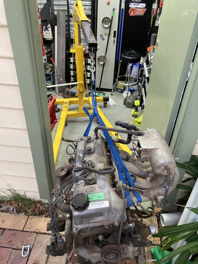

Then it was time to try and get the engine out. Which meant finding more bolts that were basically invisible underneath all the oil encrusted mud:
Finally had success at my archaeological expedition and got the engine out:

Big weekend on the Hilux, first up was discovering that the bolt on engine mounts.... dont, you know, bolt on:
That was a simple fix with the drill, no biggy.

Went on with a few other things though, first up was sorting out the drain plug:
Using a wideband bung that I had lying around, makes it easy to plug for now then can add an AN fitting when i add the turbo.
I then mounted up the turbo again:
Wow, it fits this time... after some fettling:
This would explain why the turbo manifold was so cheap, there is no way it would ever fit a T3 housing turbo with the angles it was setup for. But for some reason it came with a T3 flange. I suspect the design was built for a T25, which would also explain the setup for internal wastegate which is more prevalent on the T25 flange, as opposed to most T3 housings which are external wastegate.
I will just tack this in place for now and then measure up again once the engine is in the Hilux, to check clearances back to the brake MC etc. But all of that does look a lot easier than before.
Thats about it for now. Need to get shims and go from there.
