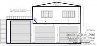

i want this anyways. I'm planning on building a 48x52 with a 30x50 living area above. one enterance of the garage being a rv bay. I plan on renting it out later once I have funds available to build the house. That or just let me brother live there, but there will be both enterences.

that is a rough idea of what it will look like. It will have an over hang for the bays, and im going to have a designer take a look and see if he can modifiy my plan for the better. I drew this with a cheap free program and it took maybe an hr for both drawings.
