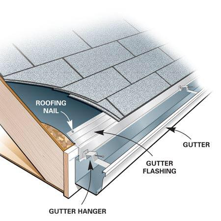

Did you put these on the sheeting for the roof? If not, it will sag at the gaps.
As for the flashing:
