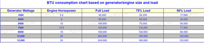

I think you need to 'do the math' first. Find out how many BTU's per hour the generator is going to require and then once you have them you can calculate how many BTU's per hour the 'flexible hose' can provide. Since your basically connecting at the gas meter, I would think the meter could certainly handle it
I found this one chart that may be helpful. In looking over some charts for natural gas lines using 1/2" pipe for example, they should easily be able to provide 73,000 BTU at 30'

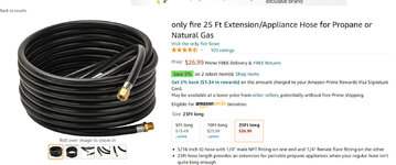

I think he is talking about something like this and they usually put a quick disconnect on them

Ideally -- you don't want 25' of hose around. Most grill installs have the hard pipe close to the final location .... have seen at the beach where people have a longer hose so they can pull it out of it's storage location up against the house. but, the valve is right there.
Those hoses are not w/o issues .... especially with small animals. In my neck of the woods you have to have a valve with quick connect. they can't be permanent with the hose.

...Those hoses are not w/o issues .... especially with small animals. In my neck of the woods you have to have a valve with quick connect. they can't be permanent with the hose.
I have a similar hose on my NG grill, and I shut the valve at the end of the pipe when I'm done grilling. I don't disconnect the QD hose, because that risks getting dirt in the QD.
But anyway, that's fine for occasional use (which would include a manual transfer switch or manual interlock), but not fine for an auto-start generator, because you don't want to leave the valve on while unattended.
