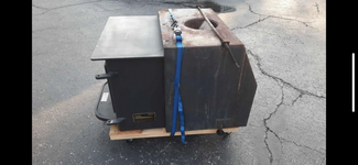

930dreamer
Oct 7, 2009
22,986
Amarillo,TX and Stinnett,TX
I'd rather have a Fisher wood stove properly installed than a gas fireplace. The Fisher will still put heat out in an emergency. Is the Fisher a true insert?
