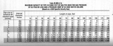

Here's the method we used to size NG lines, IIRC it was even in the BOCA book.
Anyway it's pretty straight forward: you take the distance to the farthest appliance from the meter and use that column to sizes all the other appliances based on BTU's required.
In this example the farthest appliance is 150' from the meter so you would use that column.
