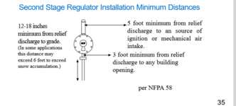

I have a question about the location of the gas regulator vent. I have two regulators, one for my propane boiler and one for my generator. I was told that the vents had to be 10' from the generator and that's where they are now. But I would like to build an outside shed for my compressor and would like to put that shed right next to the two vents. Is there any limitation as to where a compressor shed can be placed in relation to the gas vents. The two vents are shown at the end of the black pipes in the picture below. I would like to place the shed just to the right of the last vent. The shed will not be fully enclosed as the back of it will be open but up against the wall. Also is there any issues with proximity to the LP tanks?
Thanks

Looks like I may have a problem with the regulator position as well with the 5 ft requirement? What is considered the source of ignition in this case. If the compressor motor and contactor is on the right side 5 ft should not be a problem. But if the outside wall needs to be 5 ft away than that is a problem. For reference the compressor shed will look something like the second picture and will have a 4' x 4' footprint.

"5 foot minimum from Relief Discharge to a source of ignition or mechanical air intake"
The relief discharge is the vent on the regulator. If you install the vent kit correctly now the "relief discharge" as at the end of the vent kits pipe/screen not the regulator itself.
So if your tanks are 10 feet away from your compressor shed, and your secondary regulator vent kits terminate by the tank, then your 5 foot minimum is maintained even if your compressor is only 4' from the regulator itself.

Thank you.
That's good to know. I may have to cheat a little on the lower vent line to about 22' long. I will probably step those extensions up to 1".
