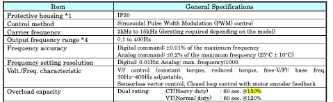

4.3A @ 60HZ, @ 230V. I assume if you're going to run the motor slower you'll need the amps to make the torque. so we're not talking about power, we're talking torque.
I'd check the manual and see what it'll do on overload. not the peak overload but the 60s overload. I've got a few applications where I'll happily let a VFD "overload" if it's transient, or saves the process, vs erroring out at 100% current.
My go-to drives are Hitatchi (P1, WJ200), and invertek (mostly for the IP66 housings with local controls). very happy with both.
Personally, I'd upsize the drive slightly for < 60Hz use, and run it in vector mode.
here's a screen shot from the hitatchi specs. by default it'll allow 150% overload, but only for a minute. so it depends on what you're doing. vector mode can give you basically full torque down to almost 0 RPM. otherwise you're either in V/Hz mode, or some kind of manual torque boost.
