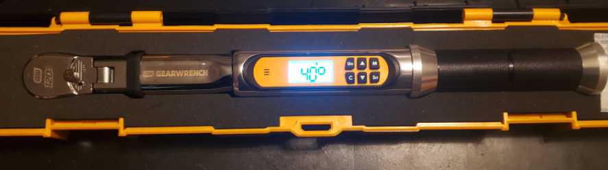

Made in Taiwan, flex head, digital with angle! 10 - 100 ft pounds

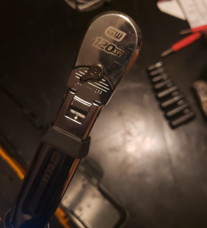

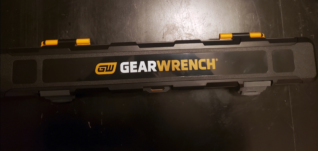

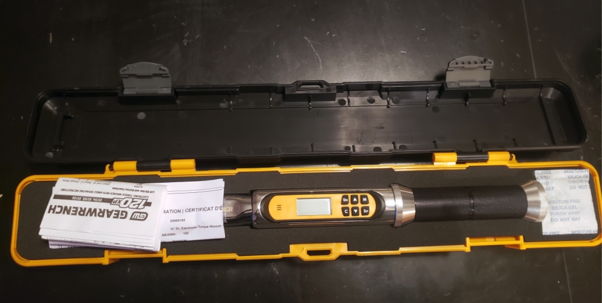

The case is beefy and the wrench itself is really beefy. The last few digital torque wrenches I've used are oldish(?) wrenches of my co-workers, a digital Snap On and a Digital matco, both of which had lots of plastic. I know both of them, the whole digital/button housing was plastic. The Gearwrench one has no plastic exposed except the visible orange face as seen in the pictures. The other three sides are covered by the metal body. You'd think it would make the wrench rather bulky but it feels sleek and thin in my hand, and the pictures make it appear larger than I think it is. The only failure point I see (depending on how the mechanism/electronics hold up) would be the battery cap threads. When you take the cap off, the threads coming out of the body are plastic and feel like...plastic. Probably not an issue, but its the only cheap feeling part of the wrench.
Sorry the pictures aren't the best, its late and I just got home. Maybe I'll talk some better pictures tomorrow at work, I've got a job that 5 of the steering gear bolts need 5 NM + 90* angle, so I'll use this for that first thing in the morning! I imagine it'll be a busy day and the torque wrench torquing bolts down will be uneventful, but I'll report back irregardless!
The case, very heavy duty
How it arrived - Silica packet and all

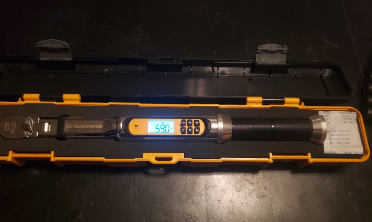

Torque
Angle
120 xp

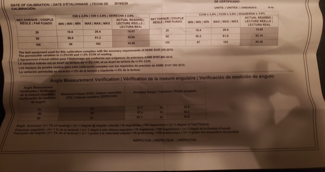

****** photo of the calibration and manual

Nice. The clicker SO and CDI wrenches I use are coarse tooth which can present problems in certain situations. If you ever put it on a torque tester let us know how it performs.

Thanks everyone for the replies. I had heard good things about their past electronics, even those made in China. I cant obviously comment on how this one will fair, but hopefully its great. I picked up the 85195 3/8" wrench from ebay with a few accumulated ebay bucks + a 5 dollar coupon for 160 (172 - 5 ebay coupon - 7 ebay bucks)
I used the wrench today to do 5 NM + 90* angle, and unfortunately could not do it with a single wrench. This wrench is ~13nm - ~113 (10 ft lbs - 100 ft lbs) so I did the 5NM with another wrench, but did the 90* angle with this one, worked like a charm. Red and green on the display + a great vibration when hitting the desired value. This wrench will do a torque value + angle, but my torque value in this situation was unfortunately to low. No complaints, it obviously must have been fairly accurate, none of the bolts snapped and all seemed properly tight after the torque procedure. I meant to get better pictures and wanted to get a few with the handle light up in red and green, but again ended up way to busy and just didn't quite have the time. I will end up using this a fair amount in the next few weeks, and if it continues to fair well I might pick up the 1/4" as well. The wrench feels great in my hand by the way. Despite being beefy and robust, it felt rather light once in use.

I was hoping Gearwrench would use their new 90 tooth head on these because, I'm not a fan of the 120xp head. there are a couple of you tube videos demoing these at the SEMA Gearwrench booth. I like that there are lights and vibration plus angle on it.

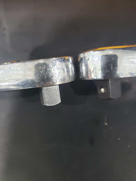

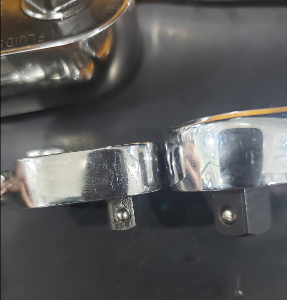

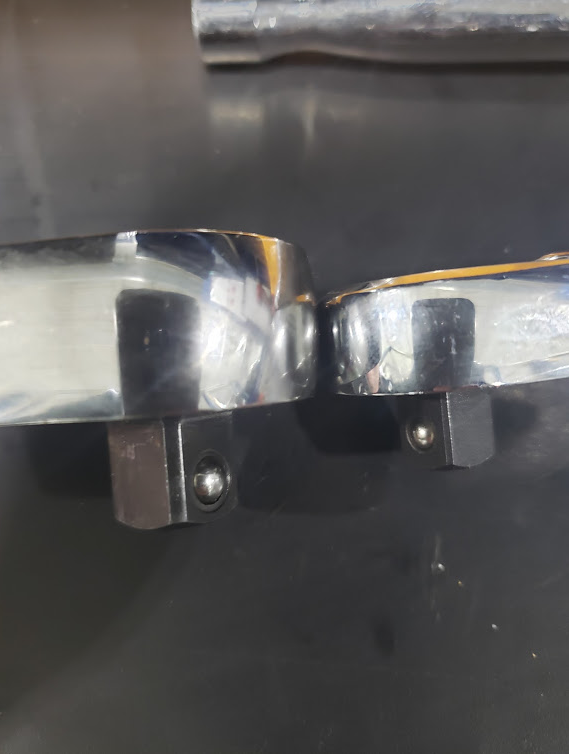

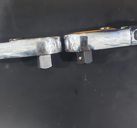

I know most concerns are over the head size, and I don't own any 120XP ratchets to compare, but I don't think the regular ratchet head sizes translates into the torque wrench head size. In fact, this head must be within 1mm front to back when compared to a regular 3/8" 84T head, and that includes the higher portion, not just the beveled edge. I went in for a few hours today and unfortunately my digital caliper is dead and broken at work, so pictures will have to do.
84T 3/8" flex head vs Torque Wrench
Snap On S80A vs Torque Wrench
Snap on TLL72 vs Torque Wrench

Yea, its about 1.25-1.5mm thicker overall. Which to me isn't worth it.
It looks though like you can swap heads on these. So might be possible to swap on an 88T MATCO head. lol.

Ive been using the 1/2" drive one for a few months now and really like it. Having the flex head seems irrelevant at first but its come in handy. The 120 tooth is great as well, for getting into tight spaces. No complaints.
