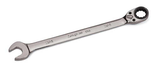

I have a set of Gearwrench combination metric wrenches I bought years ago. They have the knuckle offset and the small lever to change direction, unlike the current gearwrench wrenches that are flat and must be flipped over.
These miserable 'lever style' wrenches annoy me to no end. The 'lever' flips to the opposite direction about every second swing of the wrench. Almost every wrench in the set does this and I avoid using them. Most of the wrenches in the set lasted maybe a year before suffering this fate.
Should I mail them in for warranty? Throw them away? Arc-weld them into 'regular' wrenches? They aren't broken, per se, so I'm not sure what Gearwrench will say. Is there a 'field fix' like packing them full of grease?

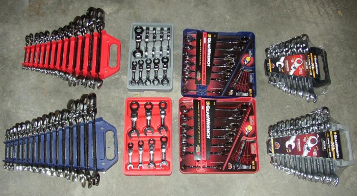

I LUV my reversible (and my flex, locking flex, and stubby flex) GearWrench ratcheting wrenches. Use them every day.
What I don't ever use is the zero offset flip to reverse ratcheting wrenches. I've had sets of metric and SAE sets for many years and most have never been used even once. Didn't take long to figure out they were a waste of money for me. I still have them but I'm not sure why. They just take up precious space in my box. When up against something there's not enough room to get your fingers around them. If you make the mistake of ratcheting up against something they get stuck and you may not be able to get it off without breaking out a cutoff or torch. There is nothing they can do that a flex or locking flex ratcheting wrench can't, but a hell of a lot that they can't do that a flex or locking flex can.
If your selector is flipping on you then I'd try to warranty them, but if they are all doing that for you then that's really strange. I've turned well over a thousand or more fasteners with most if not all of my reversible GearWrench ratcheting wrenches and never had that happen (yet). I don't use the ratcheting ends to break stuff free though unless it's like ~15 ft lbs.

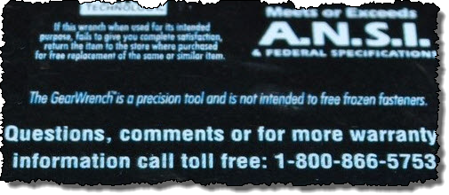

GearWrench ratcheting wrenches have a lifetime warranty "when used for it's intended purpose" and specifically warn they are "not intended to free frozen fasteners"

If your Craftsman reversible ratcheting wrenches say USA on them like in that photo then were they made by Armstrong? Good luck finding anything like that now. These days Craftsman ratcheting wrenches, at least the ones available through Sears, are GearWrench rebadges. No idea if Stanley has come out with any yet.

FWIW all Gearwrench ratcheting wrenches are made in China now. All of my GW ratcheting wrenches, pictured below right after they were bought a few years ago, were made in China. Used daily by me, family and/or employees. We've had zero problems with any of them.

UPDATE:
I called Apex tools and got a nice, sympathetic customer service rep. She said they would warrant it and could send me an RMA #, and I would pay one-way shipping. She claimed it was a $30 wrench (according to their computer system). She also asked if I could return it to the place I bought it, but that was 15 years ago - not likely.
While on the phone, I found the very wrench for $5.50 on Amazon as an 'add on'.
https://www.amazon.com/dp/B0002NYDJY/?tag=atomicindus08-20
Clearly the way to fly, and she agreed - given postal rates. She said that reports of the ratchet levers flipping (like mine) are not endemic and she said that I may have just worn out the wrench. I disagree slightly with that, but don't really care. I can throw money at this problem (little money) and fix it. I will maybe put the old one in my 'junkyard tool kit' for junkyard runs.
