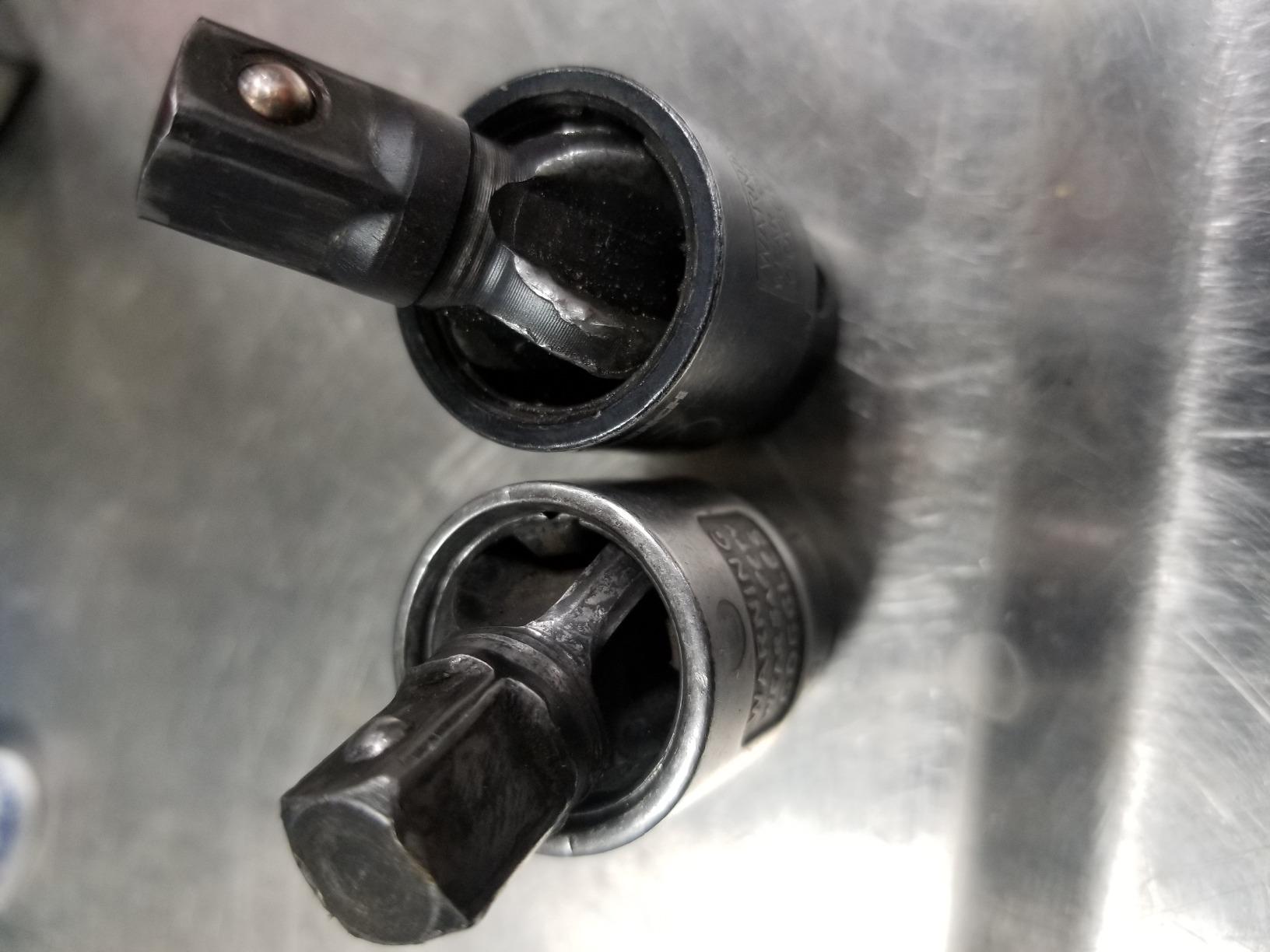

So I stumbled on the gearwrench Xcore line and was excited at the fact that they now offer a much cheaper alternative to the pinless set that is a small fortune through Matco. I opted to try out the adapter set first prior to getting the whole metric and standard sets and I am very pleased with the quality. They are virtually identical, however I noticed that on the packaging it states the gearwrench model is made in China. Is this due to Armstrong closing shop and does this mean the Matco variant will in turn move overseas for manufacturing of their version as well. And if so it’s gonna be hard for them to ask what they’re asking now for sets made in China as opposed to the USA ones

When I get back to work Monday I’ll post some comparisons between my stuff and a coworkers Matco ones. The quality is there for sure. It just really took me by surprise they weren’t made in USA for 2 reasons. 1 being its it’s always been proprietary to Matco, stamped USA. 2 being the quality is truly top notch
Granted, Matco offers them in 3/8 deep as well as 1/2 sizes and it appears gearwrench doesn’t. At least based on their online catalog
But when you factor their 12piece 3/8 set retails for 160 and the Matco variant only offers a 10piece that retails on their site (so surely more off the truck) for a whopping 452 dollars you really can’t beat it.
Matco doesn’t offer a swivel adapter set, but if you piece them together you’re looking at 150+tax/shipping (if bought online, tool truck is gonna be more). Now if you don’t mind it being China vs. USA This adapter set ran me 47bucks shipped/tax

I tried to like the Matco pinless swivel impacts. I really did. After having so many get little dents hammered into the 'slots' and hanging up, I bailed and went back to the old spring ball & socket design.
Maybe they're ok for line work in a shop but they don't like to be dirty out in the field.

This is very true haha. Now I will say based on your experience and the Amazon review of the gearwrench ones, they are plagued with the same issue of mushrooming joints. Which I guess is a given considering the design and each of those contact points taking the shock. So maybe I’ll hold off for about a year or so and see how these hold up prior to getting the metric set
