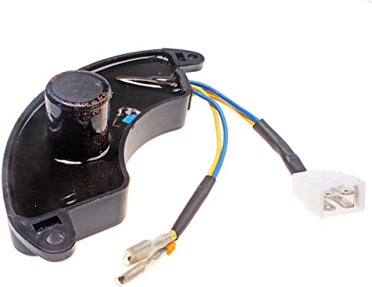

I bought a Generac generator a few years back for $50 because it ran but didn't put out any voltage.
After troubleshooting and researching, I bought a new AVR (Auto Voltage Regulator) off eBay, popped it in, and it was immediately fixed.
I felt so guilty I returned it to the guy who sold it to me!

Mine doesn’t have an avr I was told. I will look at the gaskets and clean carb again. Fuel was drained from tank and new fuel filter was installed. Still surging.
