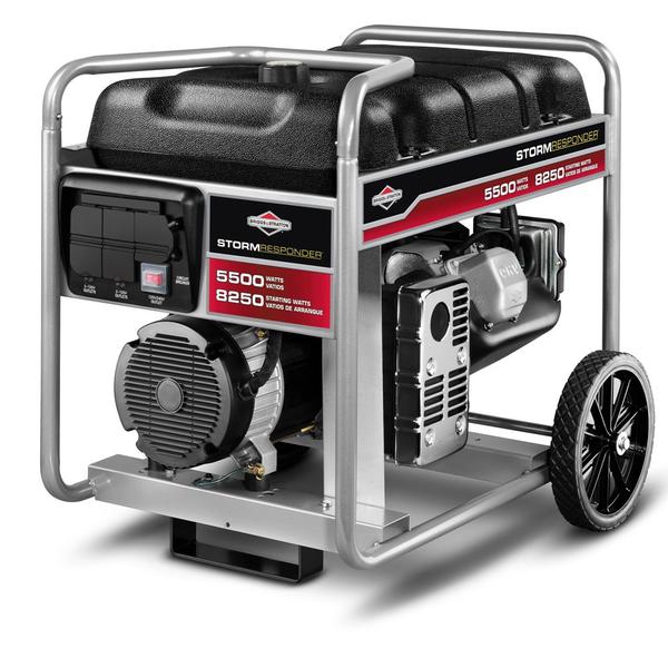

The place is wired for a generator with the Generac panel installed but I have not yet pulled the trigger on the generator. What are the features and benefits of each. 7-10 kW is about where I want to be.
The best generator to have is the one that is there for you when you need it. The right size will provide the power you need to run the things it takes to keep you in your home during an emergency!
When hurricane Irene hit the east cost in 2011, we lost power for three days. Because everything in my house needs electricity, we had no water (well pump), no heat, no lights, no sump pump, no septic pump, an inch of water in the basement, and we lost two refrigerators full of food.
I told my wife never again, and we went out and bought a Briggs and Stratton Storm Responder 5500/8250 generator and Gen-Tran 10 circuit Transfer Switch. I paid just over $700 for the generator, and about $400 for the transfer switch, power inlet box, 25 foot L14-30 cord and all the 10 gauge wire to hook it up.
Fast forward to October 2012, and hurricane Sandy hits New Jersey. We lost power for 11 days!!!!
I hooked up the Storm Responder to the power inlet box leading to the transfer twitch, fired it up, and threw the 10 switches on the transfer switch.
We had heat, hot water, lights, a working sump pump, two working refrigerators, working internet service with phone and t.v., a working microwave and small toaster oven, a coffee machine and we could use the bathrooms!!
I have heard the stories about how everyone says this generator is junk, or that one *****, or the other brand is no good. But I am from the school of if you maintain it, change the oil, and feed it good clean gas, any generator is better than none at all.
For 11 straight days I had that Briggs and Stratton Storm Responder working. I would run it for about 16 hours a day, as that was how long it would run on a tank of gas. Then I would let it rest for 8 hours and fire it up again. I changed the oil per the recommended intervals in the owners manual, and it ran flawlessly, and never missed a beat.
It was worth it's weight in gold if you ask me. It allowed my wife and I to stay in our home, and not have to spend money on hotel rooms like some of our neighbors. Or have to replace hundreds of dollars worth of food again. And the piece of mind it gave us is priceless.
People may say the Briggs generators are not good, but not me. Is it the best you can get? Probably not. Are there better ones out there? Probably. But I would recommend the one I have in a heartbeat.
Here is a picture of the one I have. It is shown with the handle in the stowed position. The handle can come completely off if you want to remove it:
