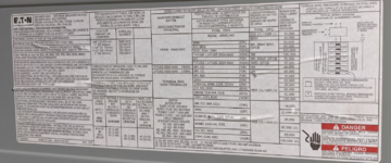

Well, I think I want to put a generator on my shop. The shop powers my "pump house" - which provides water to our house and is essentially split at the power main. The house already has a generator with auto-start. The "simple" way to this perhaps, is just plug the water pump into a 240V generator, so I may be making it overly complicated, but I'd prefer if the shop had power overall.
Problem is, the shop has solar panels. Backfeeding a generator is a no-no. I've looked at control systems that work with generators from Fronius and they exist, but all they are going to do is reduce generator load in exchange for quite a bit of money and complication.
I think what I want to do is "interlock out" both my power main and solar at the panel. There is an interlock kit that is setup to work with "4 pole" breakers. I have 2 x 2 pole breakers, can I tie-bar these together (legally) - the main and the solar would be on the same bar?
It would like like this, via using this kit

Not sure youll find a 4 position tie bar. what is the make and model on the panel and is the interlock youre looking at listed for use on that panel?
I've seen (master) electricians use 10-12ga copper from romex as a tie bar. They doing it wrong?
Yes, the interlock shown above is what I was thinking about, as it locks out 4-breaker slots against the breaker immediately below it.
There are lots of options over on:
I can have one custom built (price unknown).
Panel details are below (Eaton):
Before you guys bust me on it - main bus is 125A. Feed is 90A, Max solar is 6KW, 25A... I'm under 125A.
