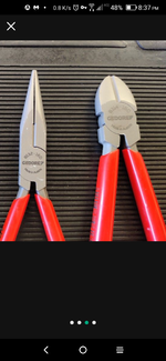

Which Gedore Red tools are made in China ? Ive only seen Gedore red tools that are made in Taiwan , India and a couple in Germany but never China.
The weird thing is both Gedore blue and red tools seem to share common countries of origin.
For example I had 2 Gedore red pliers a few years ago made in Austria. But there are also Gedore blue pliers made in Austria.
Beyond cost, I'm not sure what dictates the reasons behind where Gedore sources their tools from.
Are you reffering to the pliers in the pic ? If so , those aren't gedore red , they're just Gedores which the handles have been dipped red , I have a pair of cutters like that too.
Gedore Red will say "GedoreRed" on the tool , have a model nunber that starts with "R" abd have no COO on the tool unless its made in Germany. So those in your pic are Regular Gedore, or as now known as , Gedore Blue despite being red.
Jesus, way to make it ******* confusing. I hate these damn tools companies.

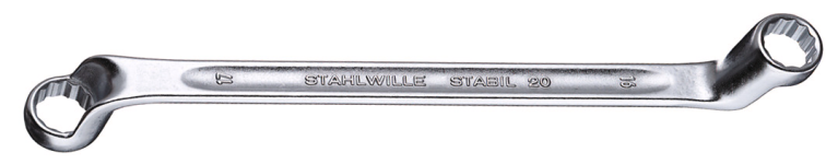

I'm deciding between the stahlwille 21 and 23
Is the 21 more versatile for general purposes? What are situations that a 23 would work but a ratchet wouldn't?
YesIHaveAHammer
Jun 1, 2025
939
Been considering about this recently, and we touched on it here a few days ago https://www.garagejournal.com/forum...-usefulness-of-different-wrench-types.558698/
I'd say the 21 is less versatile. Being completely flat, you can swing it in a narrow space, but it won't clear any obstructions nor make room for your hand.
For each one, there's situations it's better at or where only it will work.
Someone in the linked thread mentioned the ends of the 23 are quite similar to combination spanners such as the 14. What you go for needs to bear in mind what your whole collection will look like.
Also note the lengths, e.g. in 12x13mm: 21 150mm, 23 203mm, 20 220mm.
21 Stabil (flat)
23 Corona (shallow)
20 Stabil (deep)

Whoops, I meant 20 and 23.
Lots of people on this thread saying the 23 isn't that useful and they reach for the 20 first.

I have both the 20 and 23.
They are both good designs, but I find myself using the No.23 Corona’s all the time. They have pretty much become my “go to”. The size, balance, everything, is just right. I have them up to 32mm and love using them.
Sure, there are some situations where you haven’t got quite enough offset with the 23’s, but equally, there are times the No.20 has too much.
The design of the No. 20 is pretty unique though. I can’t think of any other design that offers an offset angle so large, yet with so much clearance. And as Hakeem suggested they are a good complement to a set of combination wrenches.
I guess that’s a pretty useless answer, effectively the GJ fallback of “get both “!

Id personally go for the 20 if I were in your shoes unless you have a very specific daily that the 23 will suffice but then if it's a daily use item , I'd just go with the Gedore 1B combination for comfort(or any other offset combination ,just can't think of others offhand that are available here )
The 20 seems like the most logical buy here without knowing specially what you need them for. If you need an offset for the odd job where you need an offset? Nothing worse than going through the expense and then there isn't enough of an offset for a specific task and then needing to go through the expense again to get the deeper offset. I say that only because of you were willing to buy both sets , you wouldn't be battling to decide between them.
