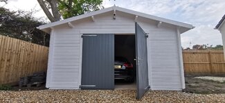

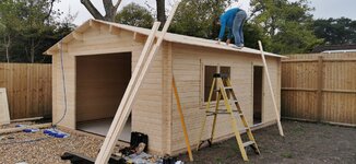

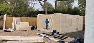

Within the plans I always wanted a garage to go with the house, so when I did the slab for the house I also did a 5.5x4.5m garage slab.
I would not have been able to have a garage with planning permission at the time, so went within the confines of 'permitted developments' which effectively allow people to build a garage/shed/summer house that is under 2.5m high, 30m2 without the need for planning or building regs.
A timber garage met the criteria whilst not breaking the bank. a perfect first garage for me! I do wish I'd gone slightly wider though...!

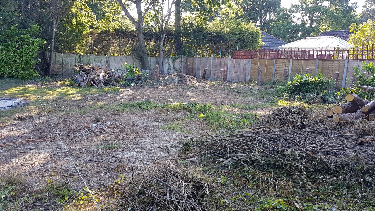

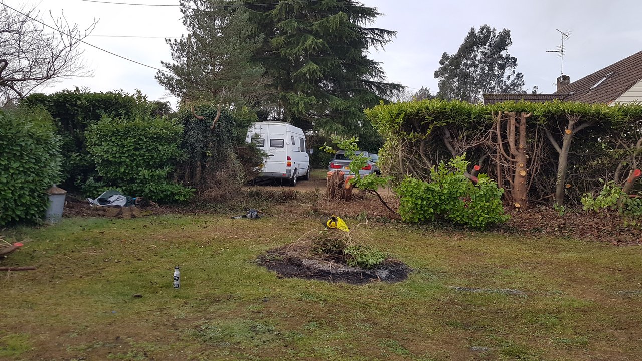

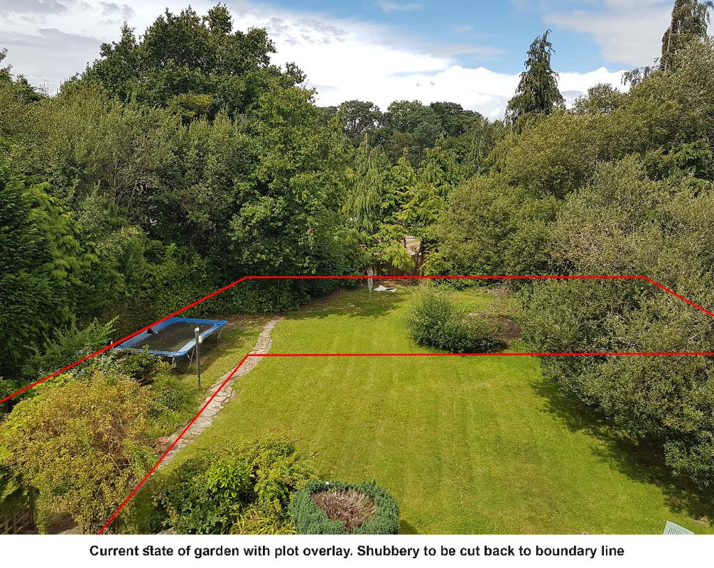

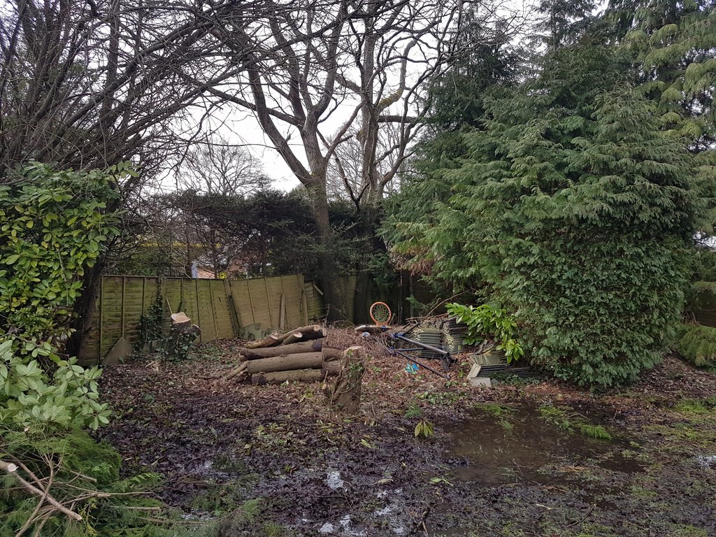

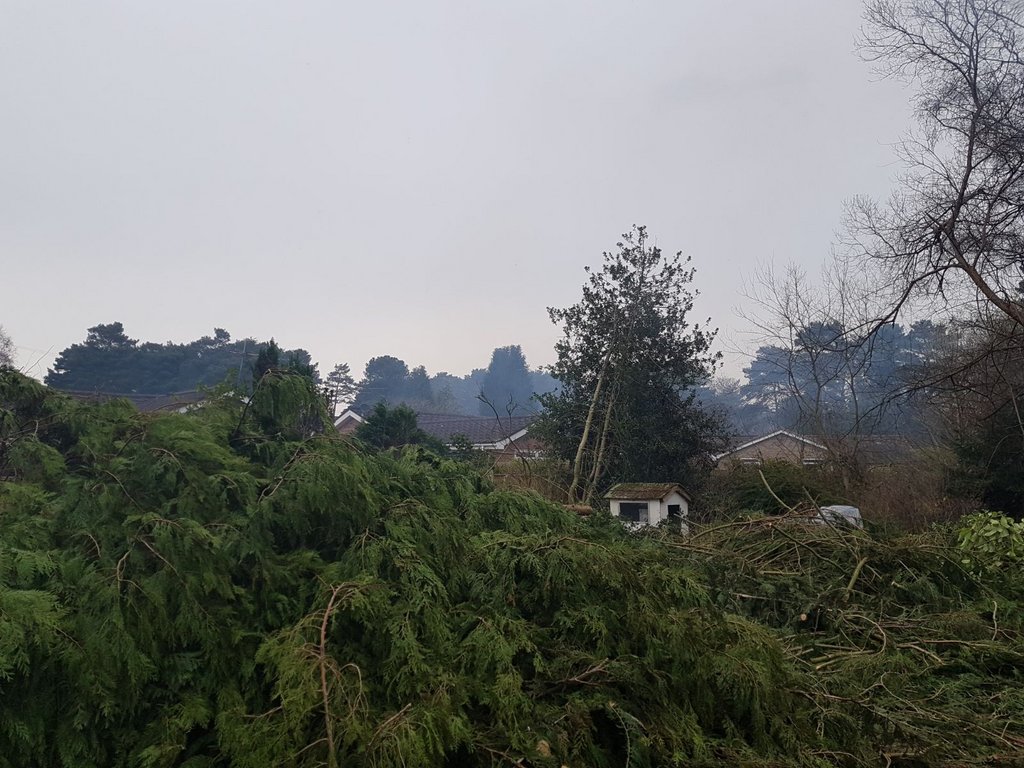

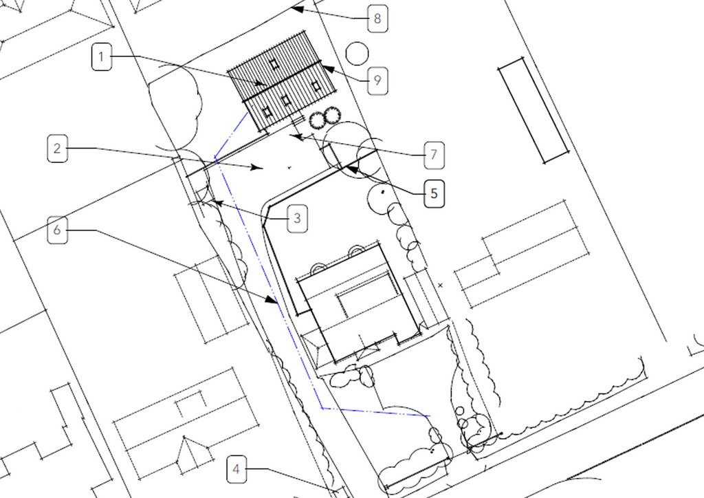

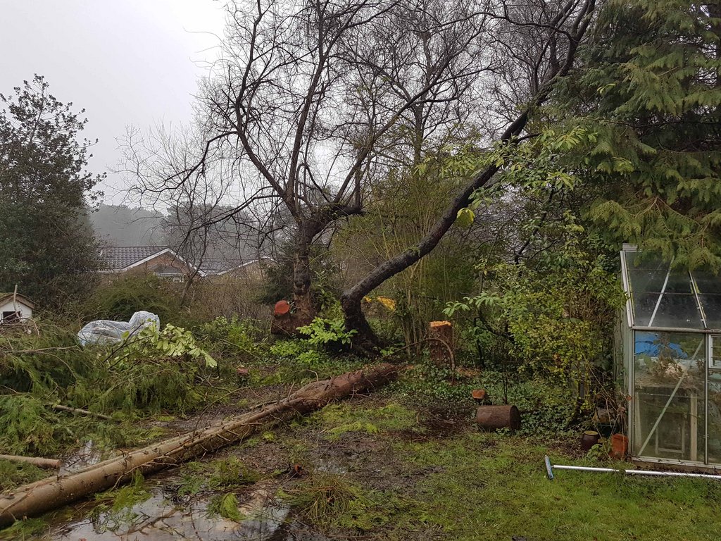

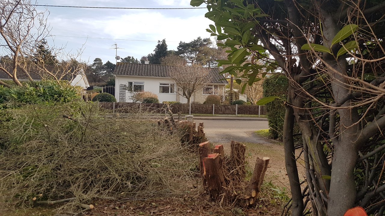

So it started with this... a plot of land that had many trees on it. All work done by myself to keep costs down over the course of a year. Many fires ensued!
Once the trees starting coming down and the constant rain, it wasn't such a nice view. Looks like a tank has rolled through it. The smoke just add the the effect...
Here you can see a string outline of the house and where the house will lay:

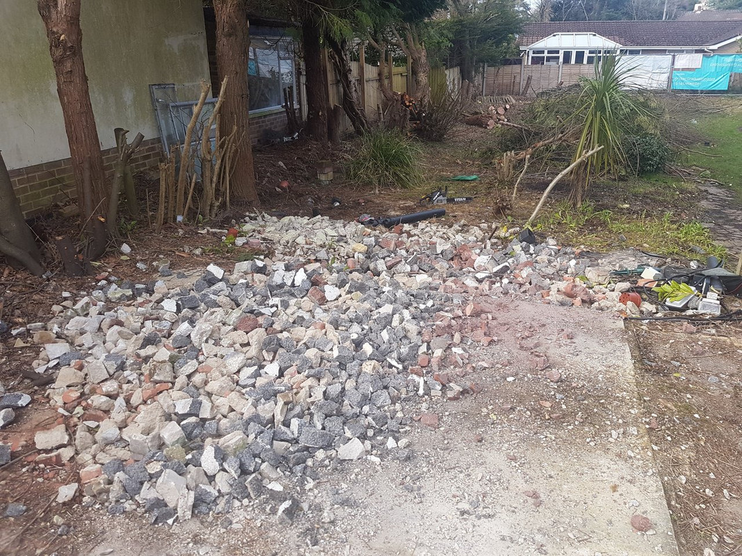

I also had to create space for a driveway to be cut in. This stretched over 60m, as house would obviously sit behind a row of houses on the road. I also had to remove trees nearest to the road by over 8m to allow for lorries/trucks and a large crane to be reversed from road side down this stretch of road, given the distance from the road it was the only option.
Sledgehammer says goodbye to a coal bunker that was in the way!
And the cutting in begins...

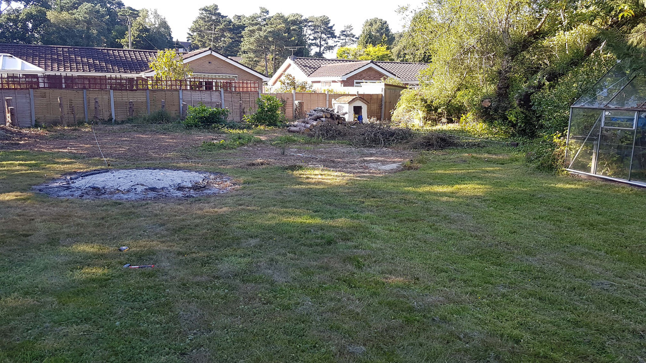

This photo was taken just before I took all of the roots taken away from site. The plot was pretty clear by this point of most of the trees, the foundation work could begin. It looks like a real mess, view from neighbours house.

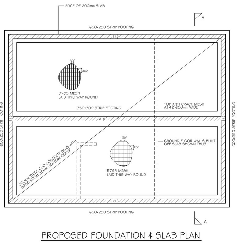

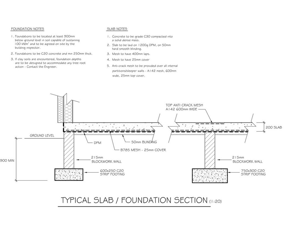

The next stage was to build the foundations for the house and garage.
The plans from the company are VERY exacting, there is not one or two feeds for water waste in this house- to make the house quick and easy to build on site, the house lines up exactly with corresponding points on the slab. This means that all of the SVP's have to be in exact locations within a few mm.
These SVP's will then line up exactly with the corresponding outlets in each room, the majority of which are in the left hand corner for the technical room and downstairs bathroom, etc.
The overall slab tolerance also had to be within 15mm across the entire slab. Considering UK building regs normally allow for a 25mm tolerance that was worrying.
Feet for rebar floatation not yet fitted but were prior to concreting.

Before the house goes up, here's a clearer break down of the slab used as well as the floor plan.
The finalised design put my house on the right side of the plot, not the plan initially but I'll explain why below. The drive/garden also changed to suit planning regs and what would work best overall.
Initially the house was to be on the left side of the plot but because a neighbour to the left has tree preservation orders in their garden (oak trees) I had to move the house atleast 5m away from their treeline.
Initially this irritated me as my oak tree did not have a similar TPO and I thought it was the best layout- however now I am glad that it happened, the house works better where it ended up going.
So I flipped the internal layout so that the kitchen would get sun throughout the day, as would the living area which has no inner partition doors- meaning natural light flooding through the house. The office/downstairs bedroom would be the only room besides the technical room that would not get as much sunlight as the other rooms.
The foundations did not need piling as I thought they might, I'd heard horror stories of people further down the road hitting nothing but clay but luckily all I had was sand.
Still quite heavy duty foundations for what is in effect a very light house.

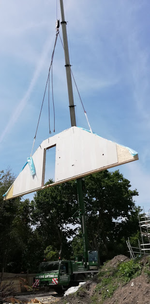

I still had a long list of things to do with the land, fencing etc but this could wait. In the last post I mentioned how accurate of a slab Danwood required, the tolerances were insane but we managed to get it within 4mm across 11 metres. Something Danwood state is one of the best they have seen, which was a relief.

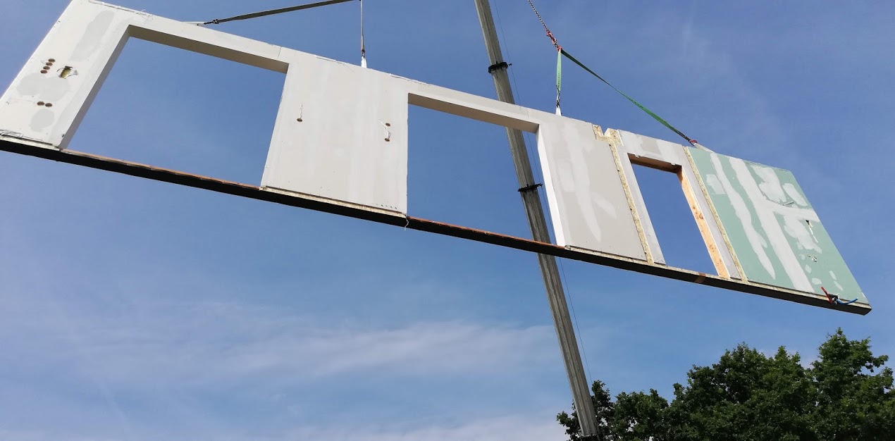

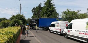

The scaffolding goes up on the Sunday before the build commences. (courtesy of the Danwood, its all in the one fixed cost agreement)
So at 0700 hours on the exact day that they promised it would arrive, the lorries and crane descended on my quiet road.
As you can see in the above picture, the walls are already prewired ready to receive the plugs. I chose where I wanted everything weeks before but there is no going back!
At the end of day 1 it was water tight, windows and doors were fitted and the roof sealed. How it was left after just one day on site: insane!:confused:
The house is an eco home, so that outer walls are timber framed and then coated in 1250mm of dense foam on the outside of all the structural support, every windows is triple glazed as well so bills should be very low for heating.
The walls are well over a foot thick so its quite substantial.
During the first week, a lot of the work took place inside with another team working on the roof tiling/guttering etc. Bear in mind the whole process take 1 month, they allow 6 weeks but my team of 9 Polish and German Builders were staying over in hotels near to here whilst the house was being built.
Mine was done in 4 weeks. 0530 hours they started and often didn't finish until around 2000 hours... that's some work ethic!
I also never saw a worker take a meal break, they must have but not downed tools like my Countrymen would for a good hour atleast. Always in high vis with a blue hard hat, they did look pretty professional.

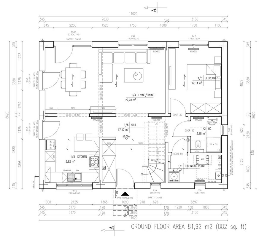

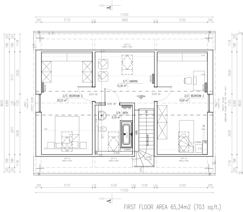

And a first look inside. It's a 3 bedroom, 3 bath. 147m2 house. Nothing grand about it but perfect for me. Very dark and dingy at present...
Living room area dead ahead with downstairs office to right.
Kitchen area:
One of the upstairs bedrooms:
Upstairs bathroom:

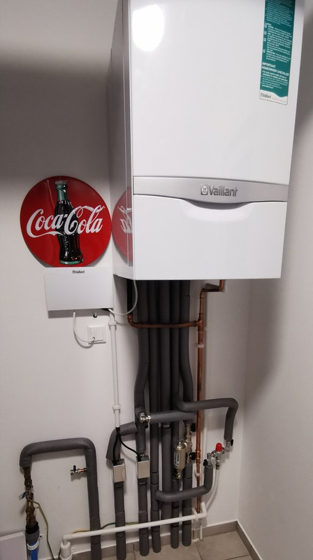

I went with the combi boiler package, which included a Vaillant ecotec plus 938 combi boiler, quick boil tank etc.
The copper work is fantastic, shame its all hidden behind foam. Likewise I had a nose in the electrical box and was suitably impressed by the workmanship.
The home also has a Zehnder ComfoAir Q, mechanical ventilation system- every room has provided with its own air filtration as all of the internal doors have large rubber seals and lips to make sure they are totally sealed off, making the need for air circulation really important and ultra quiet in the house even if someone is watching a film loud in another part of the house.
The Zehnder also knows when there is more moisture in the air and will compensate, meaning that you don;t need to ever worry about opening the window in the bathroom when showering, it will work out the air has changed slightly and keep it totally clear. Clever stuff, not something that is in most homes over here in the UK, even AC is very rare in a home as our weather doesn't really justify it eh. The Stateside guys probably have something even more sophisticated than this.

In other news, the timber garage build started. No issues thus far. I would have liked to have done this myself but the 10 year warranty was only in place if the company built it themselves. I have a trade account there so it sort of worked out with 'free' fitting costs.
As with anything timber, sealing and waterproofing were of the utmost importance. I was told to use Sadolin Supadec 7 year paint, it's more expensive than most but flexes with age and with the wood likely to dry out it made sense. It took a few coats to look good but overall I am happy with how it came out externally.

In other news, I have painted the shed and touched up the garage (!)
And generally finished off some of the landscaping.
