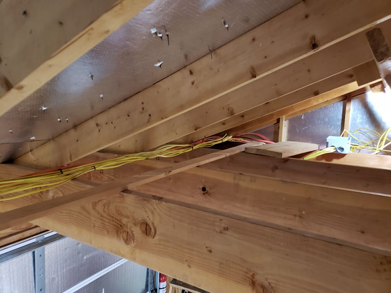

Working on removing about 10x24 of the shop ceiling to allow full use of the two post lift. The sad thing is that there are 11 runs of 12-2 heading across the space in two separate channels. There is no good way to pull the runs back out of the box and re-route, so it looks like a huge cut-n-splice party. I'm thinking two 12x12x6 boxes should have plenty of fill space to home each end. Can't decide whether to punch one big hole - like 2" - to run wired in and out, or cut several 1" holes and kinda separate things in a little bit of order. Both will be mounted where they are easily accessible later, of course.
I'd not have to do this if I had really looked at my layout and realized that I put the main panel on one end of the shop, but 80% of the circuits ended up on the other. Hah. There is no place to do that now and even if there was, it'd be hella lot more work because everything is boxed in, floored, covered with storage, etc. Easier to just label, cut and splice.
Most of that stuff run through the studs will get pulled back. Bummer

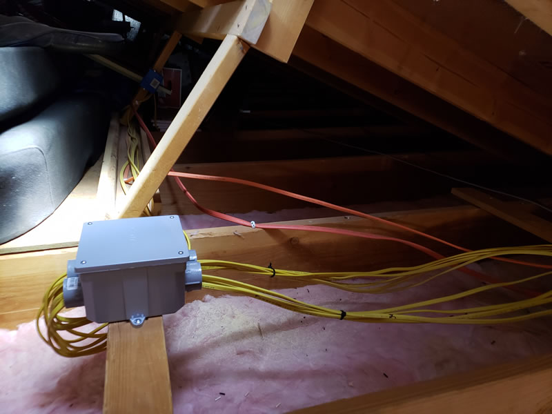

Finally got this done. The south side runs had to be sectioned and spliced. I got lucky as the 5 on the north run could be cut, pulled back and re-routed, then spliced back together. Saved a bunchy of wire that way as the boxes were 19' apart as the drunk crow flies.
Bought a bag of Ideal push connectors and that made the splicing go a lot quicker. Also took up less space in the boxes than wire nuts. Worst part was laying on that bitty board and pulling 5 long 12-2 cables back through the holes in the studs. Now it's just hacking lumber LOL.
