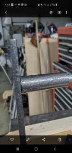

I'm refinishing an old Akro-Mills drawer chest of my father's -- one I probably gave him in the mid 1970s. After forty-plus years in his basement it was a bit rusty.
I've cleaned off the rust and am giving it a simple refinish with Rustoleum Verde Green hammered finish paint. I haven't been able to get the paint to show much hammertone effect.
What works best to give a good hammered finish?
Here are a few before and during pix:
There's a little bit of hammering in areas where the wet film thickness was quite high, I believe, but not much even there.
In the past I've used hammertone Rustoleum on other projects with better results. Here's the refinish of the oil filler cap on my Triumph TR3. Silver, not Verde Green, but otherwise ostensibly the same stuff.
- Heavier wet film thickness? (My coats have been wet, but not so heavy to risk running.)
- Higher ambient temperature? (I've been around 65ºF)
- More shaking of the can during spraying? (I thought I was keeping it well agitated.)
- Something else?
