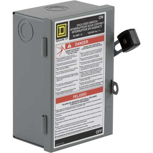

I like the idea of running either flexible conduit, or an AC whip down to a box mounted to the top of the post. I will run EMT down the post. I also like the idea of a safety disconnect switch on the post. Amazon has this 30-Amp 240-volt Two-Pole Light Duty Safety Switch for $30. I'm going to order one.

I assume you are aware that switch has fuses. The AC disconnect switch I pictured is non-fused and is about $15 - $16 at Lowe's or HD. It's a QO200TRCP

Oh, good. I don't have to change anything:headscrat
To the OP, I ran EMT straight up to the ceiling over 30 inches and down to the disconnect switch on the wall.
