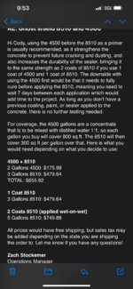

I Emailed garage flooring and this is what I was told.
So, I’m still on the fence about it. I was thinking if I had more time I should test a small area where my work benches will reside and see what the results are between 4500 and no 4500.
I have 2 gallons of 4500 since I had a future concrete floor being poured soon and I got 4 gallons of 8510 also. This would allow me to do the 4500 and one coat of 8510.
These bottles they come in, will they allow me to test the results on a small area and be able to use the rest of the bottle at a later time?

The start of the test.
The left square has 4500, middle square has one coat of 8510, the right square has two wet on wet coats of 8510.
In a week I will put a coat of 8510 on the 4500 square.
Then I will test each square with water and oil.
This will ensure I get the proper application for my concrete and provide others with some inside hopefully.
Would be nice to have a density tester or some way to test it more scientifically then just, “I poured water and oil on it, it no good, or it’s good” results.

I did, I did the water test on them.
The 4500 alone still allowed the water through.
One coat of 8510 had a hint of water after cleaning it up.
The two coats of 8510 showed to be the best results as there was no hint of water left after drying it off.
After I did this water test I decided to coat the whole floor with 4500 and then 2 coats of 8510. I had a water bottle leaked on the floor recently and I didn’t even see it, just felt the water splashed on my foot. I don’t know how long the water been sitting there on the concrete, but I know it wasn’t recent as that bottle was there for a few days.
