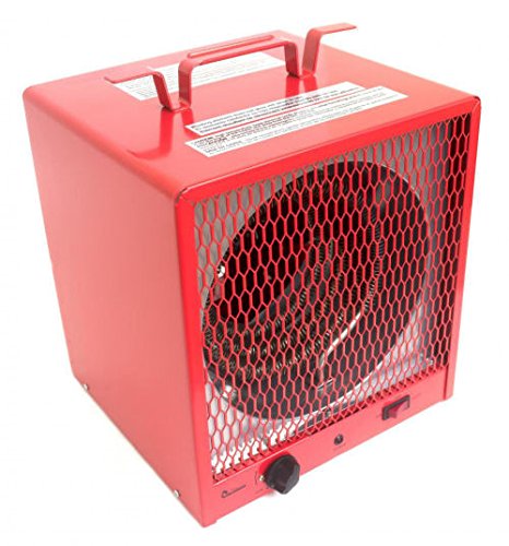

I'm actually liking this one a lot more. Very positive reviews about the high CFM fan helping warm up a large area like a garage. It's also portable (I'm military and move a lot). I can easily wire up a 220v outlet in my garage.
http://www.amazon.com/gp/product/B003XOZN7A/?tag=atomicindus08-20

See my post for the one I just got. It's similar to the red one posted above, only it's meant to be hardwired and mounted. It warms my 2 car garage and shop area (588sqft) decently. I kept it on LOW overnight and came out to a 45* degree garage when it was 12* outside.
It's on sale at LM Fleet for $109. I got mine at Northern Tool for $99, but they appear sold out.

well found the Comfort Zone 5k Unit online at Northern Tool on sale for $99.00 plus Free shipping to store, but that is 1-2 week delivery vs ground for $14 gets it to me in 2-4 days.
Then there is a promo coupon 202911 for $20 off of $100 order, so add in a clearance dollar item to hit $100 and get heater for $80 plus tax, shipping, etc... so delivered to my door is Just under $100 or to Store $86 !! great deal if you ask me !!
also can get them from L & M Fleet Supply for $109
They also carry the bigger 7500w version !! requires more power as well

I've got the red heater that zimm 17 shared. Can't say enough about it! It is absolutely wonderful! I use it to heat my small attached garage and it does in very quick order

Northern tool in Chattanooga TN has these on clearance for $59.
They're not on the website anywhere that I can find.
I bought 2 & used the $20 off $100 coupon & out the door for $108 including tax.
After a quick trip by Lowes for the parts I needed to make a short pigtail to adapt my welder outlets to the 30 amp style plugs, I am working in my shop in a T-shirt.
600 sq ft Shop was 35 deg @ noon, 60 deg an hour later & they've been cycling about 10 minutes every hour afterwards
