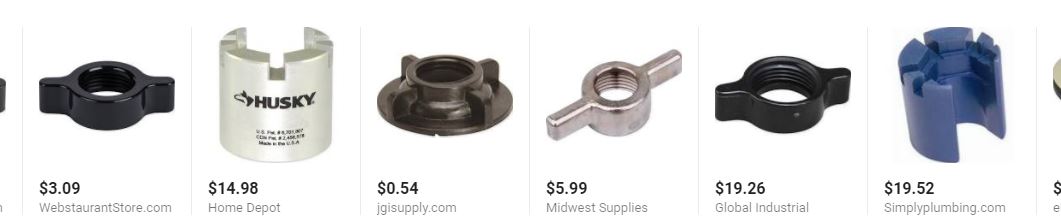

Plumbing is not really my thing, so I may be going at this wrong, but I have a 3 hole bathroom faucet (Kohler) and this large hold down nut that secures the handle/cartridge assembly is just really tough to get at. I have a basin wrench and the area is too tight around it, around a half inch in certain spots. In the past on other sinks I've been able to get a these.
I tried a needle nose vise grip, it just doesn't seem to work. I also have that Rigid tool that is a long red plastic handle, and it doesn't fit either.
Any ideas? Thanks

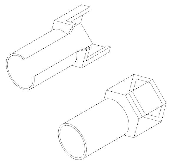

Wow. Good luck with that one.I might cut the end off a box end wrench to get the twelve point action in an open end application. And I wouldn't bet on that idea either.
Your only other idea would be to cut up one of those huge plumbing sockets, and slice it lengthwise like an o2 socket.

The first set might work, I saw those and thought it might be worth a shot.
On the 2nd suggestion, I have an O2 sensor socket and unfortunately it's way too small. But that is the basic design of what I need.
Thats what I'm saying. Buy that first set, (they sell them locally...for me anyway). And get the grinder out.

Some form of pressed steel socket like the Amazon-referenced set should do the trick. Can't see the other end of the copper line so don't know if it will fit over--may have to cut a slot in the socket.
I might also try a cut box end wrench, but a deep offset kind. I have enough of them laying around so it wouldn't hurt me to trash one. Shouldn't take much torque to loosen it. Depending on the room to operate around it, might even try a ground cold chisel with small hammer and start tapping in the proper direction near a point on the nut.

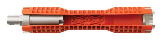

What's holding the sink in - just caulk or plumber's putty? It may be easier to just carefully pull the whole sink...
https://www.amazon.com/dp/B01D4ZF0HA/?tag=atomicindus08-20

I recently had the same issue for a tiled over inset sink. Nothing flipping fit and I couldn't get anything up there. So I took a piece of 1-1/4" tubing about 12" long and cut the reliefs in it then used a pair of channel locks. Worked like a champ, so I now keep it with my plumbing tools.
