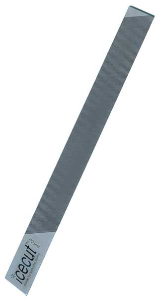

I worked as a ski tuner for years and have tried a decent number of brands and types out there. I don't know what you're going to be using them for, but some of the "ski tuning files" are head and shoulders above most hardware store stuff. They're not even in the same category as far as I'm concerned.
My favorite "basic" file is the "Ice Cut" file by Vallorbe (Switzerland). These are super smooth and stay sharp 3~4x longer than most over the counter stuff.
Vallorbe offers them in a handful of sizes and tpi. They're the best I have used in that category.
