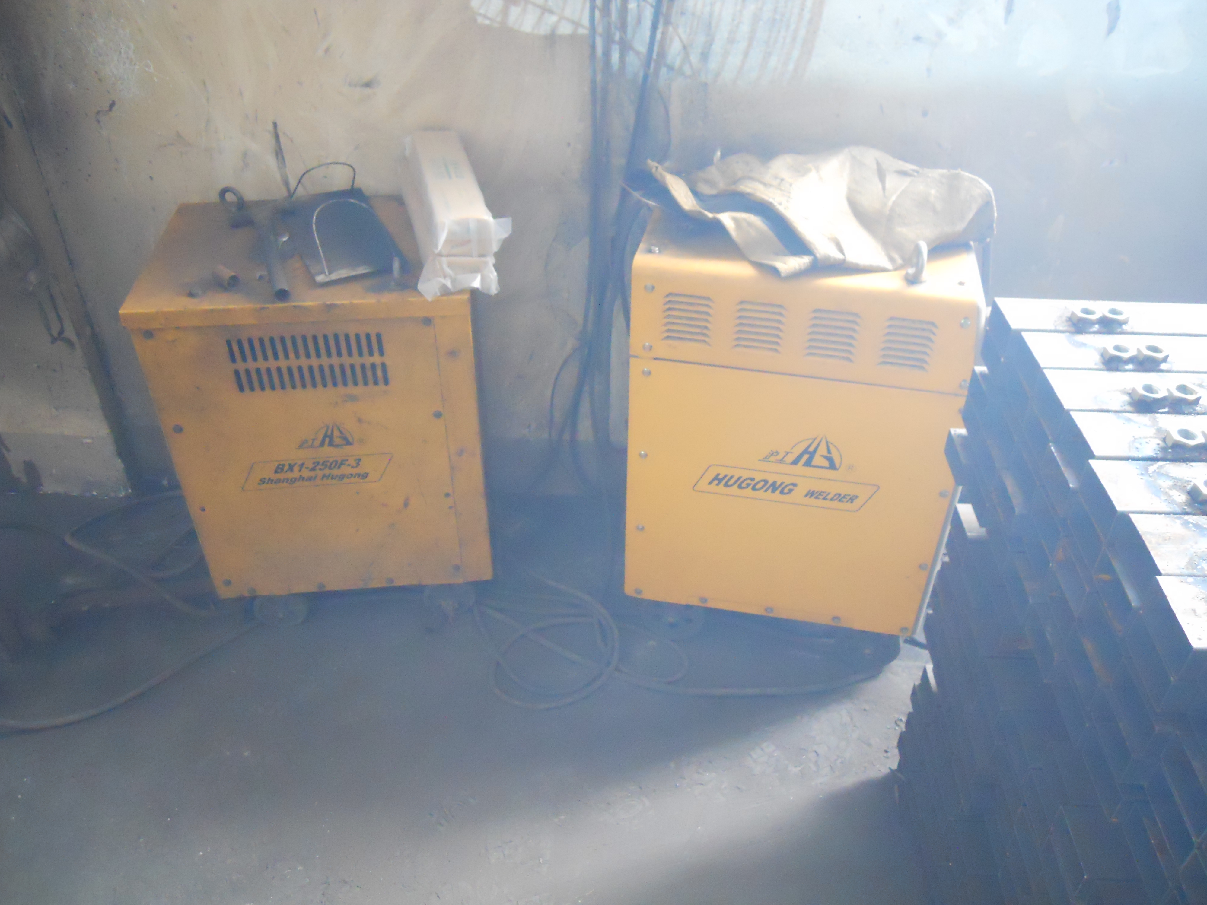

When I visited multiple factories in Shanghai they all had the same arc welder. Their mantra is "more bead, more better". And all of them were cranked up to 11.
