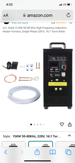

Thing is pretty cool. Seems to heat mild steel a lot more readily than Titanium. Perhaps I need to build a smaller coil. Target material is .188” od. Coil that came with it is about 1.75” I’d. Any body play with these things?
I thought the material had to be ferrous for induction?

Not sure about Titanium on that. Seems to work. Video on Superior Flux website shows doing Ti. Did a Ti part, just had to have the power much higher. Still learning. Coil is just a copper tube, can make any size/shape IMG_1395.png
