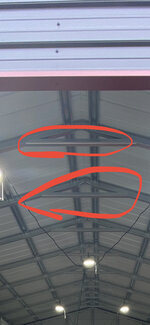

Got my building spray foamed yesterday. I paid for 2" everywhere, but this crew no doubt gave me much much more than that. The tubing is 2.5". 90% of the foam comes past it about 1 - 1.5" easily.
The roof is packed full of foam! Same 2.5" tubing, + 1" for the purlin.. No doubt there is minimum 4" up there.
On the peak area where the cross support is thats 4' wide, there’s about 13” from cross support to roof peak. As you can see, it’s completely filled in.
So far Im pretty happy, I just have a lot of cleanup to do.
With that being said, what is a good solvent to use that dissolves spray foam overspray? I have some speckles on my garage doors that I need to remove. I tried to use acetone. It does seem to work. But after about one minute the acetone dissolves the rag, and the color of the rag ends up on the painted surface.

Hell of a deal there if charged for 2".
Yea, one of the deals with spray foam is it's a lot easier to plastic stuff off up front than clean up later.

  2. That's a LOT of foam. Hope they sprayed correctly and it cured solid. Good luck with the outlets and sheathing.

Holy Foam Batman! You might just want to make that a meat storage locker now that you have that much insulation. :) Good luck getting it all under control!

Looks like you got a deal for only paying for 2 inches should be real cool & warm. Was the spray crew new / inexperienced the stuff is not cheap dont show the pictures to the spray foam co owner might get a second bill.

Good problem to have I would say. Just cut the foam away from the vertical studs so you can sheet it. maybe one of those long flimsy hand saws ould make quick work of removing the foam where you dont want it to be?

A long serrated bread knife makes a good tool for trimming back foam. (Don't steal the one from the kitchen...)
I've also used a long blade handsaw like you suggest where you have room to work--you can put a bit of an arc on it by holding handle and end and use the 2x as a guide to ride the blade along. You can go pretty fast once you get the hang of it.

I would sleep on the idea of what you are going to do next. As to overspray, acetone works well with cotton but it will dissolve plastics and things it is on. It will also leave a sticky residue unless you wipe it several times. The reason I say sleep on it, you may want to leave it thick, or you may want to slice off the excess and cover it. If you do that then change your mind, you can't go back.

Jezez, am I the only one that thinks this is a terrible job? The companies I see in my area that know what they're doing know how to apply it just right so that when expanded it doesn't go beyond the studs. I would hate to have to spend hour after hour shaving down the foam so that I could put wallboard on, or outlet covers. And that's not to mention all the waste.
I'm glad I saw this, forewarned is forearmed. If my company starts like this I will correct them or stop them quickly before my interior looks like a pile of wadded up bedsheets.

The "terrible" jobs with spray foam are really uneven spays, sprays with big voids in them (that you can't see unless you have a thermal camera), missing areas, not covering rafters, etc. I do think they went a little nuts here and DO be specific if there is something you don't want covered or need them to shave it down (they they do for stick and brick construction). But too much foam? I can always cut a little off.
