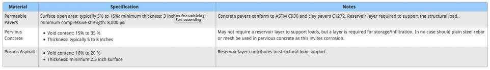

Recognize that the pavers aren't 100% permeable. Basically, they'll have a permeability factor. Whereas grass may be 100% permeable, the paver system might only be 20% permeable. Here is a typical chart:
