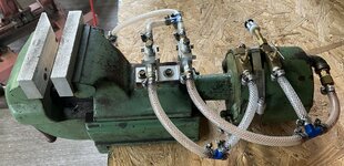

When you put something in between the jaws, you can spin the arm and just barely tighten on the part, just enough to hold it. Then pressure must go into the line at the bottom front of the cylinder, which moves the rear sliding jaw forward 1/4" unless there is something to clamp down on. If something is between the jaws it clamps down tight. But to put pressure in to clamp it, the rear fitting must be vented to atmosphere. That is why there are two sets of valves. The front set apply pressure to close or open, and the rear set have to be used to vent for either action to take place. I am sure there is some sort of foot valve that does this automatically, but not that I can find at Gressel's website. They don't even show this kind of vise anymore.
Interesting to me that both the Leinin and Gressel move the rear jaw, which means more of the vise has to stick off the bench in front. Seems like this is very common in European vice design but not in USA brands. I wonder if there is any advantage? I use the Leinen a lot as well as a big Craftsman and have not come across a situation where one design seems to work better than the other.
