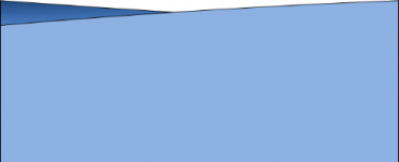

I have a good chop saw which I use to cut steel and aluminum tubes and bars. Of course, it does not cut perfectly flat, as seen in the sketch I attached.
I need to be able to grind or sand this stuff to be flat, and at an exact angle (perp or otherwise). A bench grinder is clearly not the right tool, because the work piece is held in hand. What is the proper tool for this job?

I've got one of the larger disc/belt sanders that I do it on.

This is definitely the realm of a large disc or belt sander. I do have a couple of questions though, (I assume this is a home shop) would you need to be able to set the angle or would it be done by hand? What is the material? And most importantly what is the budget? We use a LOT of Burr King equipment and it has never let us down, but it may be out of the realm of a home shop.

Ditto on the disc sander. To help insure the ends are flat, I like to rotate the tube or bar while sanding it. But if you use a good square and make sure the table is square to the disc, you should be fine.
If your chop saw isn't cutting flat, it can be a combination of things. You could have a cheap wheel, you could have a loaded up wheel, your stock may not be laying square to the wheel, you could be either going too fast or too slow causing the blade to flex. Depending on what I cut, I like to keep the cutoff wheel dressed with a piece of Norbide.
Double check all of your setups. And what brand of cutoff wheel do you have on it?
I have a Ridgid 14" chop saw. I think maybe I press too hard on it which causes the flexing. I normally use 5/32" abrasive discs. I am not sure which brand they are. I usually get brands like Stanley or DeWalt or similar.

If you cut much slower, your cuts will be squarer. Also you can rotate the work and cut from 2 sides. I have even lightly dressed the work against the side of the cut off wheel.
But if you jam the wheel down on the work, it will deflect.

Check the table and blade for square. I bought a Rage 2 and ended up adding some shim stock to get square cuts.

Angle grinder w/flap wheel. I can eye it near-perfect but you can always check it with a square. All the belt sander comments; well they work but you need a big *** one, not some re-purposed wood working tool. And if it's a long piece of tube good luck using a stationary sander.

I have a KMG that works great for this. The belt is only two inches wide, but the largest tubing I use is 1-1/2. I square up a piece of angle to the flat platen and clamp it down as a guide.

It helps if everything is square and level. I keep a level by my cut saw to make sure the stock is level and the saw is level. Use a square to check the vice to blade for square. It makes for so much less cleanup if it's cut square to begin with.

If you end up with some type of sander that has a table that can be set at 90 deg. to the belt/ disc, use a set of v-blocks (for round tubing) and just rotate as you feed the tubing in.
