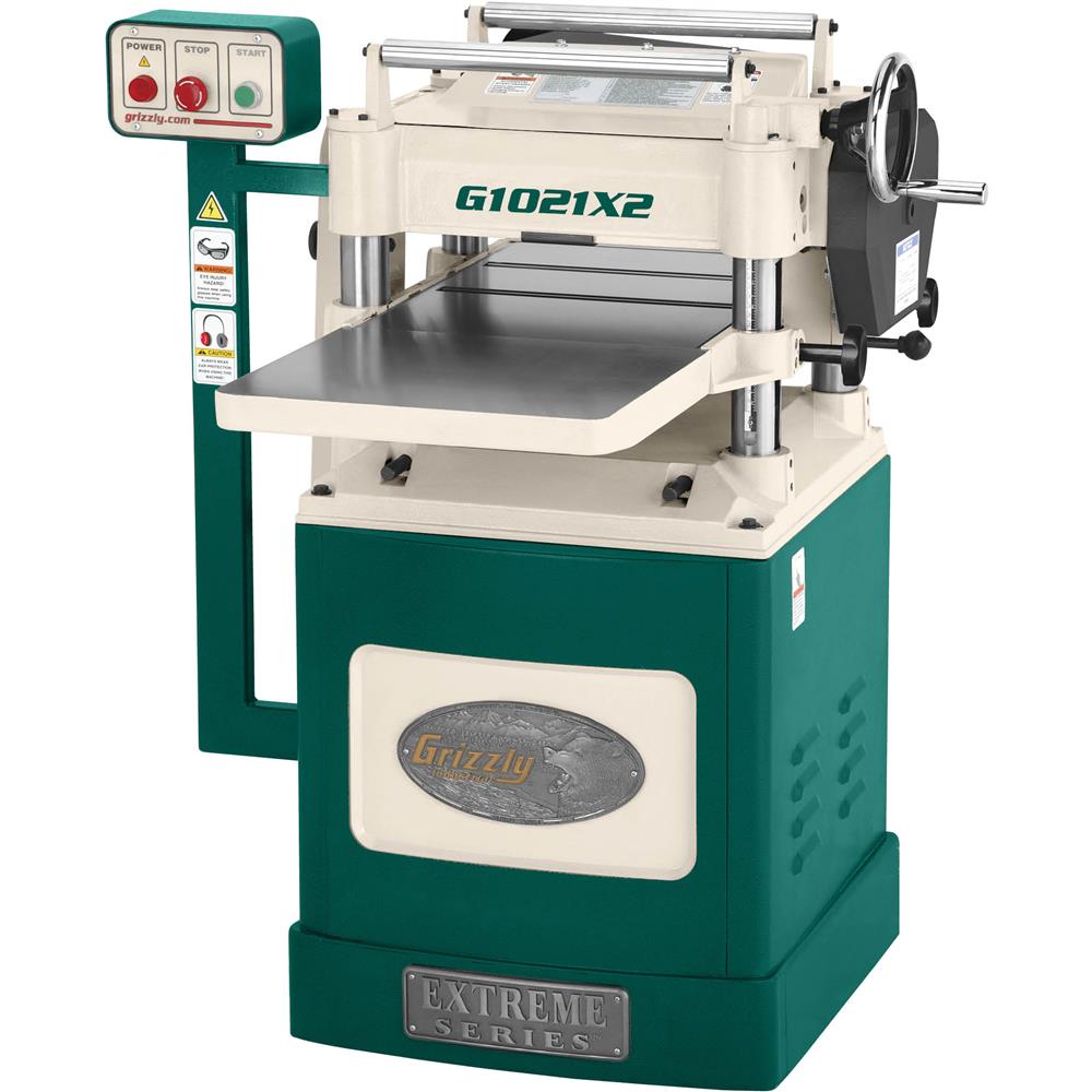

Going down the planer rabbit hole, I have a dewalt DW735X which does a decent job but would like something a little bigger. Right now Grizzly is offering free shipping which is like 10% off so it sweetens the deal a little. Going from straight blades to a helical cutter head should be a big improvement in finish quality. Just curious if anyone has a planer they would recomend, I've been looking at used delta & powermatic but no great deals & I love old PM stuff. It seems like alot of guys are selling rough sawn so cheap it's worth milling your own finish lumber. I have also had good luck buying from Grizzly in the past, so getting a new machine with a warranty is kinda nice.

I have a old 1021 that I put a Byrd head into.
It's OK. There are some aspects of the 15" 4 post planers that I don't love, but they are better than a lunchbox.

@jar944 what is it that you don't like about those 4 post 15" models?
There is no pressure bar on any of the 15" planers, and there wasn't on the original 13" invictas they are all clones of. The 20" 4 post planers do have a pressure bar, which is odd as they are just wider versions of the 13/15". They do all at least have a chipbreaker unlike the lunchbox planers.
My other gripes more nitpick, and not fair for the price point of the machines.

The reviews i've read & watched seemed to all agree it's a good machine that leaves a great finish. I am still looking at some used planers, I a PM 100 but am concerned the 12" inch width may be limiting. !5" width seems like a sweet spot, though an 18 or 20 for the right price would be nice.
