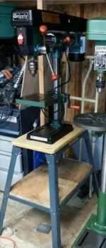

Grizzly rotating head Drill Press ??? WTH ??

If it goes slow enough for steel I could see it being useful for drilling holes at angles.

Could be useful for making angled holes in wood with a Forstner bit. Forstner bits are very happy to make an angled hole as opposed to other drill bits. Those types of holes are needed in furniture making - think of a chair for instance. Many angled holes are needed; from the legs into the seat, cross braces into the legs, backs, etc.
It's a small drill press but for the right woodworking projects it could be very handy.

^ ^ ^ Yeah, woodworking makes sense.
See it has hand crank on the table so it would be handy for odd wood bores.
The $200 price seems steep for used . . . . what would a reasonable price be ??

That same unit has been available from Cman, grizzly, and other places that source China tools.
It is well known to not be a rigid machine and is intended for woodworkers.
Can be very handy for drilling odd angles

It's a type of radial drill press, yes most often limited to wood working or sheet metal due to lack of rigidity.

I have a similar Delta radial drill press. Useful for woodworking and very small holes in metal (I use it exclusively with sanding drums). Very noisy, and sloppy. Paid $25 for it a garage sale, and think it was a fair deal.

Same here except it's a Rockwell. Another thing it's good for is you can pull it way out to get clearance from the columb, I also use it in my wood shop.
