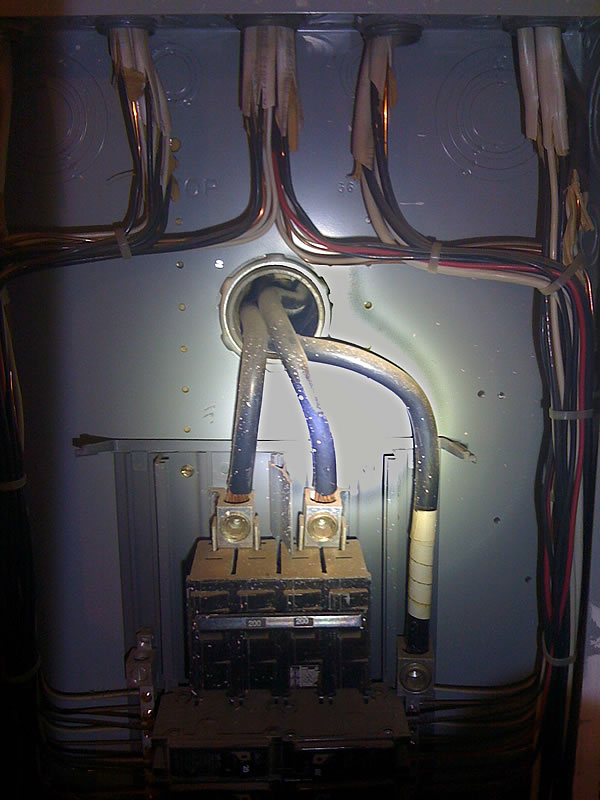

Interesting. Definitely a very CLEAN panel, I think probably too much time was spent and I can't say I've ever seen a professionally wired panels organized with wire ties :)
Either an amateur install, or it's grounded through the service conduit and the actual ground enters the meter pan... which probably isn't legal, but is functional.
I've never installed a Homeline new, though I have put breakers in many... can you see if the neutral/ground busses are tied?

The light washed it out in the picture, but yes the neutral and ground buses are connected by a bar at the bottom under the breakers. It's lost in the glare of pic #2. This panel was put in when the house was built in 2001, so I'm sure it was a pro install. However, I didn't see a company sticker on it. I need to remember to call city hall tomorrow and ask if they have a record of the builder. Need paint info if I can get it. If there was an inspect, they would have a record. Inspections have been very spotty here over the years as there is no resident inspector.

That is an excellent job. Best I've seen for a commercial job.
The wire ties are a great idea and needed on MWB by current 2008 code but it doesn't look like that's why they were done. They were just used to keep it tidy.
It is missing the bushing though. There should be an anti-chafe bushing around where the feeders come in in the back. No biggie though.

The panel is a ITE/Siemens & it has a split neutral, which makes it EZ to have a neutral connection close to load connection of the breaker, the pic obscures the bottom of the panel where the tie bar would normally be factory installed. Is the grounding electrode connected @ the meter can? Not allowed in PG&E territory but is alllowed by some PoCo's.

Is the grounding electrode connected @ the meter can? Not allowed in PG&E territory but is allowed by some PoCo's.
It may be - we'll see when we get them out here. Our old house was like that when we bought it, but at that time it had 4 Federal Pacific boxes hung on the side of the house. That was a mess. I can tell you that I see no obvious ground rod or solid copper wire anywhere around the meter can. The engineer wants to cut the house off at the transformer to make sure everything incoming is AOK. We also need to re-mount the meter can as something is pulling it off the bricks outside.
STILL waiting on clearance from the bank to take over this repo. Supposed to get the word yesterday, nothing yet. Patience young Skywalker...

I have property in two utility's territories. One requires the ground at the panel and the other requires it at the meter channel.

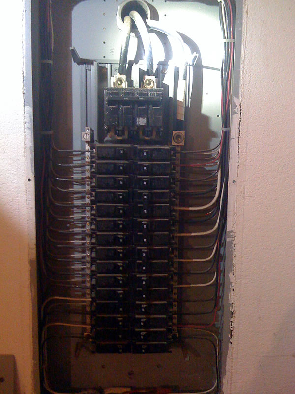

That is the same panel I have in my shop. The one in the pic does have the tie buss between the neutral and ground, its difficult to see but crosses over from one screw head to another at the bottom of the neutral and ground bars, it is turned flat to the side of the bottom most breakers.
Only issue I have is the number of romex runs in each of the cable clamps. They are large clamps and have several runs each, not sure what the clamps would be approved for however.

i my self would swap some brakers around for dome smaller ones to makr room for more add ons like more power to s hop later no but i like how they made it nice and clean

cannot do that, your limited to how many circuits you can have by the NEC. He'd probably have to do a sub panel to keep it to code. Its better IMO to have a sub panel then to have a main panel with tandems
Charles
Good catch. That is almost certainly not allowed. I have not seen clamps listed for so many 12/2 cables like that. Most are two max.
As already noted, that is a 40/40 panel, meaning it is designed for 40 circuit breakers and 40 circuits, and is not UL certified for more than that.
Had it been a 30/40 panel, it would have been designed to accept ten of the duplex breakers to up the circuit count to 40.
Only certain stabs in the panel are designed to accept the duplex breakers, this panel will not accept any duplex breakers.

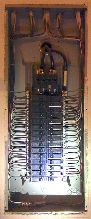

every panel i make up gets zip ties. when you dont use em your panel looks like ****. its all about taking some pride in your work. but it seems that more and more apprentices coming up have the attitude of 'its hidden, who cares what it looks like'

Im serious as a heart attack and your not going to believe it, but some local municipalities will positively NOT allow a panel to be dressed with zip ties; I've had panels fail final because we zip tied the panel, so we now just neatly dress the wire w/o zip ties or anything else. Personally though I think a zip tied panel looks spiffy.

If one is using solid wire, there is really no need to Ty-Wrap the conductors.

This may have to due to wire heating, Bundel wires have no free air movement, hence they operate at a higher temperature, Think I read it somewhere?

I would have to question that and require the inspector to site the code.

In a residential panel it really is not a issue IMO, but it is a issue if the NEC is followed as over 24" is considered bundling.
The 1st part is just my opinion....

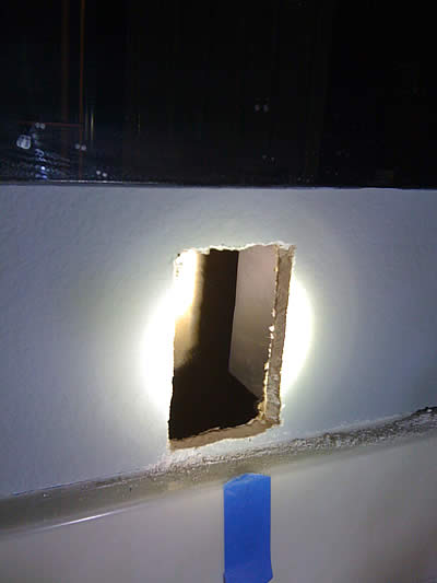

Update - The house is now ours. We're painting and learning some things as we go.
Small bath - vanity light are not connected to safety ground.
There is a 12-3 cable in the attic going nowhere, turns out it's cold - good thing. But it's pulled into the service entrance - where there are no breakers or spaces for it. Um, OK.
In the master bath, power comes into the light switch, jumps to the vanity light, then to the GFCI and then to an outside outlet.
- The outside outlet was not connected to the load side of the GFCI.
- And the best move, they used a 12-2 as a double power feed - hot on both black and white - from the light switch box to feed the light and GFCI. To switch the light, they used the safety ground as the return leg from the vanity light (white from light to copper). Nice work. The vanity light is in the closet and the breaker is off until I figger out how to fix that mess. If the romex is not stapled close to the switch box (it isn't for the GFCI) I may be able to pull a couple of cables up to the light. Otherwise, I'll have to come in from the top of the wall. !@#$%$#.
Thought I bought a house I wouldn't have to re-wire :wtf:

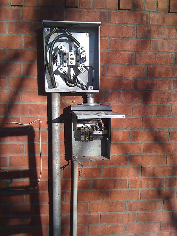

Fixed now - utility remounted meter can and they put on a nice 100A Square D box for the well power and shop feeder. Plus two 8' copper clad ground rods 6' apart and tied it all in with a #4 ground cable (not shown).
Oh - and that bath thing. I fixed that easy. Then, decided that while everything was a mess anyway I'd just put in a new outlet by the other sink. I mean really - a 6' double vanity with one plug? Who does that. I measure a spot to make the outlet symmetrical to the sink faucet and cut a hole. Guess what I find...
The electrician thought there ought to be two plugs, but the drywall people maybe thought not. Nice. Live too. Been like that for 10 years, it can be there a while longer.

I would NEVER be allowed "here" to double tap the meter base with that small gauge wires....
Class time.
Please educate me.
it looks like they are bringing aluminum to the top of the meter, and coming out in smaller copper wiring.
IF the copper wire is sized to the main breaker is sized appropriately for the main and the wire to that little panel in the pic is sized appropriately to those breaker, why does it matter if it is smaller than the wire brought in the top?
Note that the utility engineer did the install, not me or a hired gun. So I guess that means it's allowed.
It's aluminum coming in from the pole underground
2/0 copper into the house - 200A main in the house.
#4 to the SqD box.
What I found - I found an outlet box in the wall, already wired.

Not sure but you might want to check tap rules, its possible that you can do what was done
This'll make 'em choke - the house we have now house is triple taped. AEP checked it out and buttoned it up. Before you choke, it was quintuple tapped at one time - really, 5 boxes.
