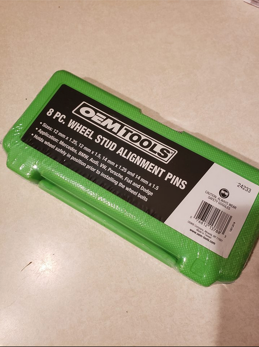

Stud to align wheel with hub for installing wheels with lug bolts instead of lug nuts. Guessing it's used on some Porsche models based on the package notes.

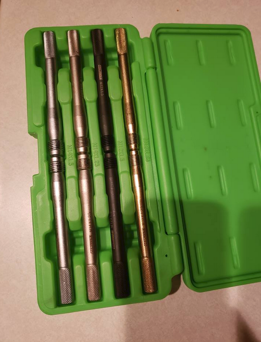

You guys are good!
I could have made one easily by cutting off the head of a bolt, instead of $30.6bd0e921d6a47d1fb02c6129a002d2f5.jpg

Yes, but yours wouldn't be knurled on the one end, and it will have bare steel exposed where you cut the bolt head off. And those have the nice little caps to identify and protect the threads.
$30 is a bit steep for that, I will admit, but sometimes you are money ahead to just buy the tool and get back to work.

IIRC the Audi's included a polymer one in with the jack stowage. On occasion I'd just line them up with a screwdriver. It wasn't normally an issue unless I'd pulled the rotors. New ones would always float and sometimes pulling the old ones would knock enough gunk out that they'd slide around as well, sometime though they'd just stick right back on. Still if you don't have a lift and are trying to do it on the ground those pins do make it way WAY easier. $30/pair isn't too bad, they'll certainly hold up longer than polymer ones would.

I just cut the head off a bolt, little grinder action to round off the edges, cut a slot in the top for a screwdriver if necessary...cost free, as I had a spare bolt of the right size/length kicking around.

Feel like its saving my back one wheel at a time. No more awkward holding/lifting scenario while I try to get a bolt in place lol. They're pretty awesome, but 30 dollars for a pair seems a bit steep.

I have a bunch that were free I also have shorter ones and longer ones for if a wheel has deep holes. Old inner tie rods are the right thread for these......

LOL, I use to think the same way....... until I was changing a tire on an Audi on the side of the highway, in the middle of the night, during a snow storm and couldn't get the holes in the hub, brake rotor, and wheel all lined up at the same time. I struggled with that for probably 10 minutes or more. I finally broke down and bought the set I linked to earlier in this thread and I have used it a few times since. It is ABSOLUTELY worth the 36 bucks I spent for that 6 piece set. If you've never struggled in ****** conditions to change a tire on a car with lug bolts instead of studs, you have no idea.
