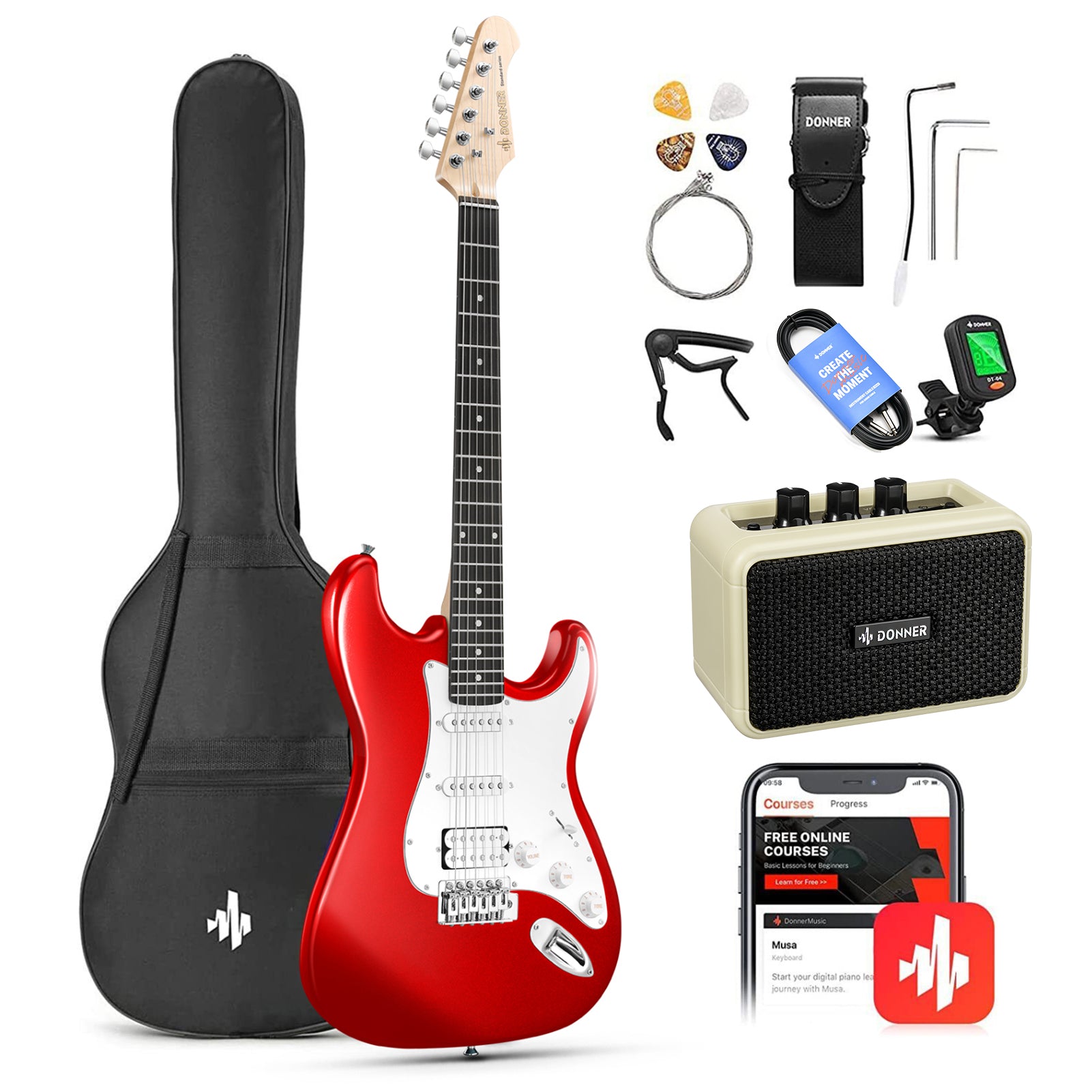

Annoying the neighbors with the new guitar (Strat clone) postponed for a day as Amazon not only sent it to the wrong town, they left it sitting there ALL day... it's STILL there.
On the upside I did get a Black Friday deal on it for $136 + tax ($149 total), down from $230 + tax, today's price is $170+ tax.

As for issues with a cheap guitar:
It will be getting regular Slinkies & Grover tuners.. which seems to cover known issues. & possibly a bit of file work on the ends of the frets depending on their finishing, some are great, some are like razors. Also polish the frets & get the action sorted.
It's a sunburst Strat clone from Donner. Lots of YT reviews.

They cost almost as much as I paid for the guitar, especially considering they sell the mini amp it comes sells alone for $50:
It's kinda cute, looks just like a full size amp, but the front is barely larger than my cellphone. headphone socket is 1/8in.
This is the kit I got (it shows the wrong amp):
Tried the auto tuner doodad it comes with, it works but the tuners on the guitar are really sloppy. Tuned it, went back over them all again, couple needed a slight twist.
Def getting Grovers & Regular Slinkies in the very near future
