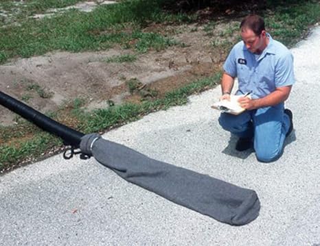

Have you looked in water socks for the end of the pipes? Something like:
https://www.erosionpollution.com/filtersock.html
or
http://www.mutualindustries.com/product/pipe-sock
As seen on amazon:
