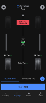

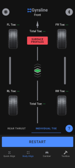

Here are some of the different measurement screens and one where I was messing around with it at my desk. The little line with the specs on that one is the spec for the car you are measuring, it has a database where you can find and add cars, or make a custom one like I did for my Cougar becouse I am not using the stock settings-
The one where I was messing around and some settings screens-

Thanks for the run down, that really helps. What I want to do is to get the chassis squared up and setup like it needs to be. Then when I install the body I can adjust it to the chassis as needed.
Is the information and screens you showed for the new G2 version? Is it the same for the original version? Do you have the option that has the vehicle specifications?

Its the newest version, it comes with the vehicle database access so you can find and add cars. I believe the app looks the same for the older model now but the accuracy is slightly less, but still plenty to get a vehicle within spec.
