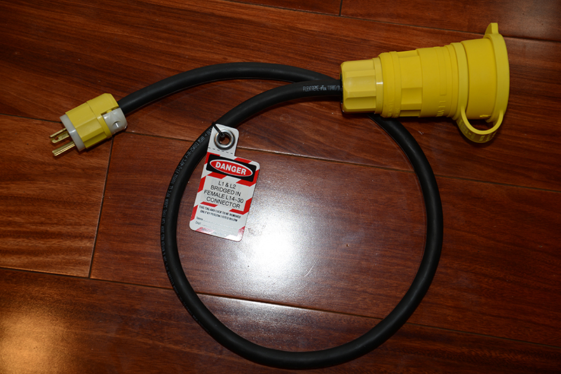

In light of the recent thread, I wanted to share my current generator wire setup.
I actually shared this on another forum, but the mod felt since it was not up to NEC standards, he deleted the whole thread/diatribe. Actually, from what I recall, transfer switches in itself in his ~eyes~ were not up to NEC code, and he deleted all transfer switch threads...
Regular L14-30 Inlet to a Transfer Panel
Gas Guzzler 120/240V on hand.

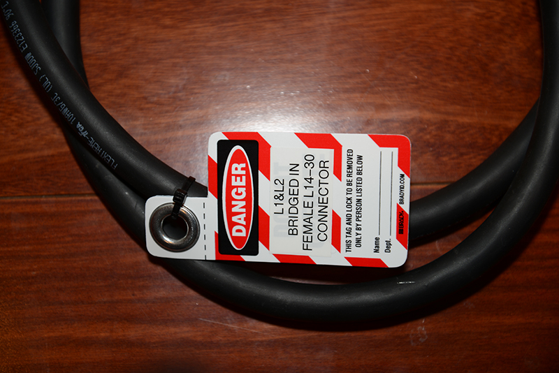

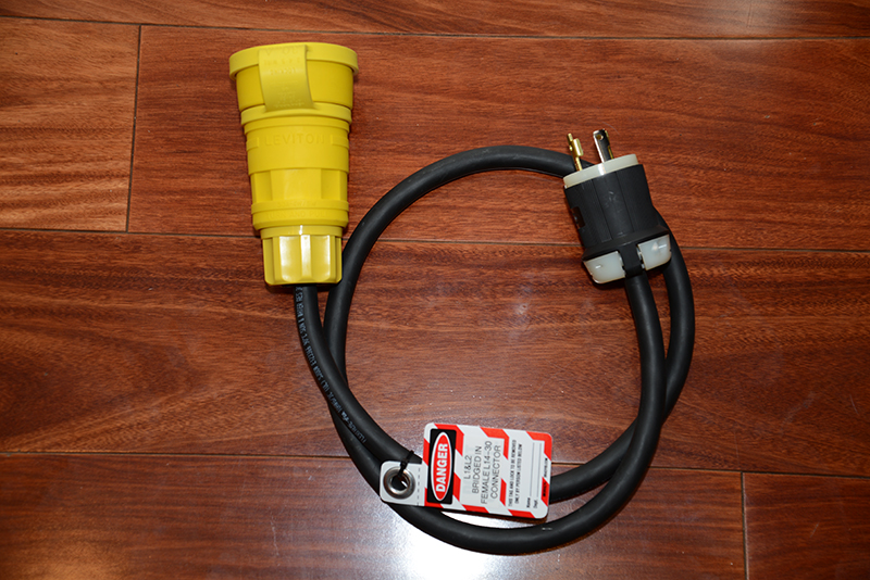

After Sandy, I added 2 Gas Sipping Honda EU2000'i to my stash. I wanted to maintain the L14-30 ~standard generator cord~ so I made 2 cheater plugs. One of my EU's has the standard duplex, and the latter also has a L5-30R on it, as you can Parallel both the EU's together. Both ends of the cheater cord have a L14-30 Connector on them, in which I then connect my regular generator cord back to the inlet.
The cheater cord basically give me the option of powering both legs on my transfer switch.
Mustang brought to light a point about ampacity on plugs....and just spurred this thread.
mobiledynamics
Mar 14, 2010
5,077
Gotham City
Those are not suicide cords.
The males ends go either into the L5-30 or 5-20 on the Hondas. The other end is a female L14-30.
I then use my *generator * 14-30 cord back to the inlet

Assuming the hidden capped end is female - Not a hack.
I looked at making that cord, but found one an existing commercially manufactured one for ~$45.
And I acquired it for the same purpose as you.

...this is questionable on the application so you are saying that you used that L6-30P as L5-30P (120V) by providing X from the L6-30P to both X & Y on the L14-30R. and I didn't get how the two generator tied in with each other into the same circuit and none of the appliances in your generator powered requires 240v?
I guess it is ok, when used stand alone (one generator to one house circuit) and not expect 240V from generator, Plus you will be using that cable for that only purpose. which u have a warning tag. Not sure about the NEC and not sure about how you tie two generator to the house. Especially one with 240V and one with 120V powering two legs L1 and L2.

ok now after seeing the Honda site. You have an EU2000I and an EU200I companion which the Honda have special feature to allow you to tie the two generator together and get a 120V 30AMP outlet and a 120V 20Amp outlet on the companion generator. So you made this L6-30P (even thought their manual says L5-30P) to L14-30R cable by powering X to XY on the L14-30P. I guess it will work as long as it is not powering any 240V. Not sure what would happen if you do. Does the L6-30 really fits the L5-30 ?

You are worried about the ampacity of the plug. Your setup could now be drawing 2x the load per wire size over one wire and pin on the plug potentially. The weakest part is obviously the whip to the generator and the generator receptacle.
Obviously a 20amp pin is really only going to yield you 2x10amps at 2x120v legs, so you might be overloading that feeder. Will it melt down? I would take a WAG that the generator CB would break before anything melted, but that's up to you.

Corrected my OP. It's a L5-30

I'll fire up the gas guzzler if I want 220
The Honda's only do 120.
One unit does 15amps, parallel is 30.
The adapters are there to power BOTH legs of the transfer switch, utilizing the L14-30 Cord and Inlet

So the 2 legs are in phase? It seems that any MWBC you have in the house could potentially see 40A on the neutral, no?

I believe one could make 240v from two Hondas if needed to by inverting the synch signal between the two.
Now whether it would be safe to do so is another question. Would certainly violate warranties/codes/etc.

What I was saying you can have a generator that makes 60 amps,but with a 30 amp breaker in your panel your maxed out on your draw at that amperage. Now I don't know if one generator will trip before the other because I've never hooked up two generators to the same cord.
