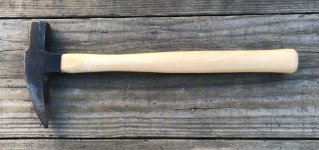

Hung a handle on a 4oz ball pein.
Not having a handle small enough, I shaved down the neck on a bigger one.
Left it 4 sided with the edges eased.
Thinking it felt pretty good, I set a rivet and like the way it swings.
Royce
