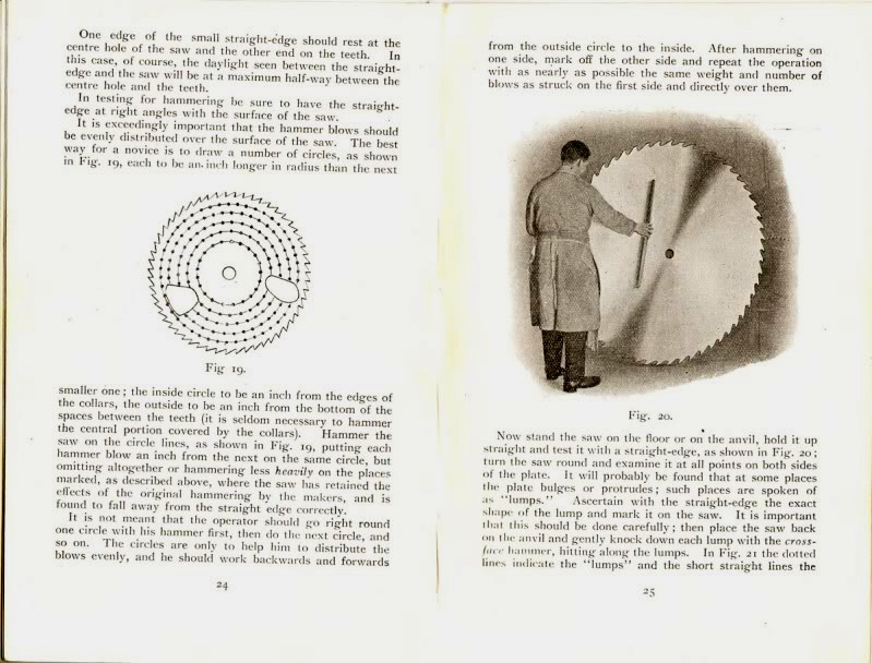

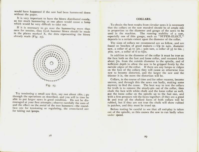

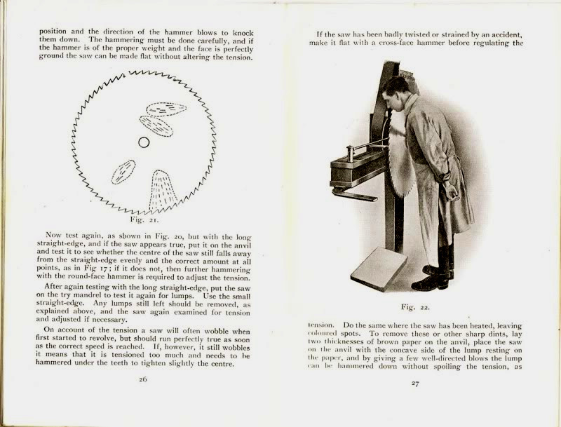

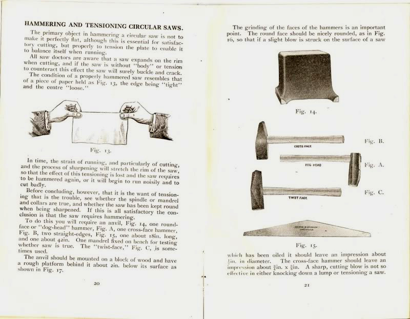

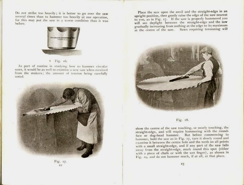

So I looked up"saw doctor" and learned a lot but I don't quite get the reason for the angled faces. Is it just as simple as having to work in close quarters or is there a more interesting story?
