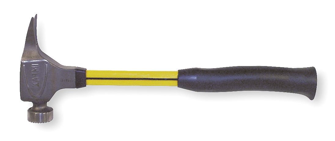

I frame with a Woody.
Yes...it's a hammer. 22 ounces. T-style metal head that goes down into the wooden handle with 3 bolts connecting it. Too bad they don't make them any more.
I could lift a 20 foot wall off the deck without breaking the handle.
I used to use the California Framer 25 Ounce from Hart hammers but I broke too many of those.
Douglas Hammers makes something similar and maybe as good.
Check them out. http://www.douglastool.com/
Shows a picture of the hammer.
