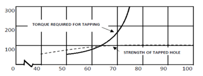

What's critical to know here is the %thread (e.g. the size of the hole being tapped):
% Of Thread Calculation for Cutting Taps
Above from https://www.tapmatic.com/tapping-torque-vs-thread-strength.php
yeah, unfortunately, not a whole lot of cheap drills w/built in torque meters (maybe I'll throw this one in when I try it) (the floating tap ad above says most broken taps happen when backing out too). I think one can keep track of the clutch settings in a conventional drill w/a torque wrench though. Curiously, I did find this one & wondered if it would even work on the smallest taps:
