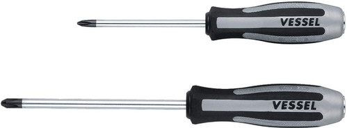

Indeed, mostly Honda, also my Hyundai Santa Fe. I had never thought about the fact that the screw would be JIS (too crusty to see the little dot!). I'll definitely go for the JIS. I assume the VIM set is just standard phillips?
Any screwdriver bit made in Asia or Europe will be the new DIN standard that works in JIS. I would expect the same from the American tool truck brands, but not from hardware store bits made for the construction industry.
Your rotor screws may not have the dot, but they'll certainly be of the JIS type.
Aside from Vessel, Zeyphyr sells individual impact bits on ebay. I'd check there.
