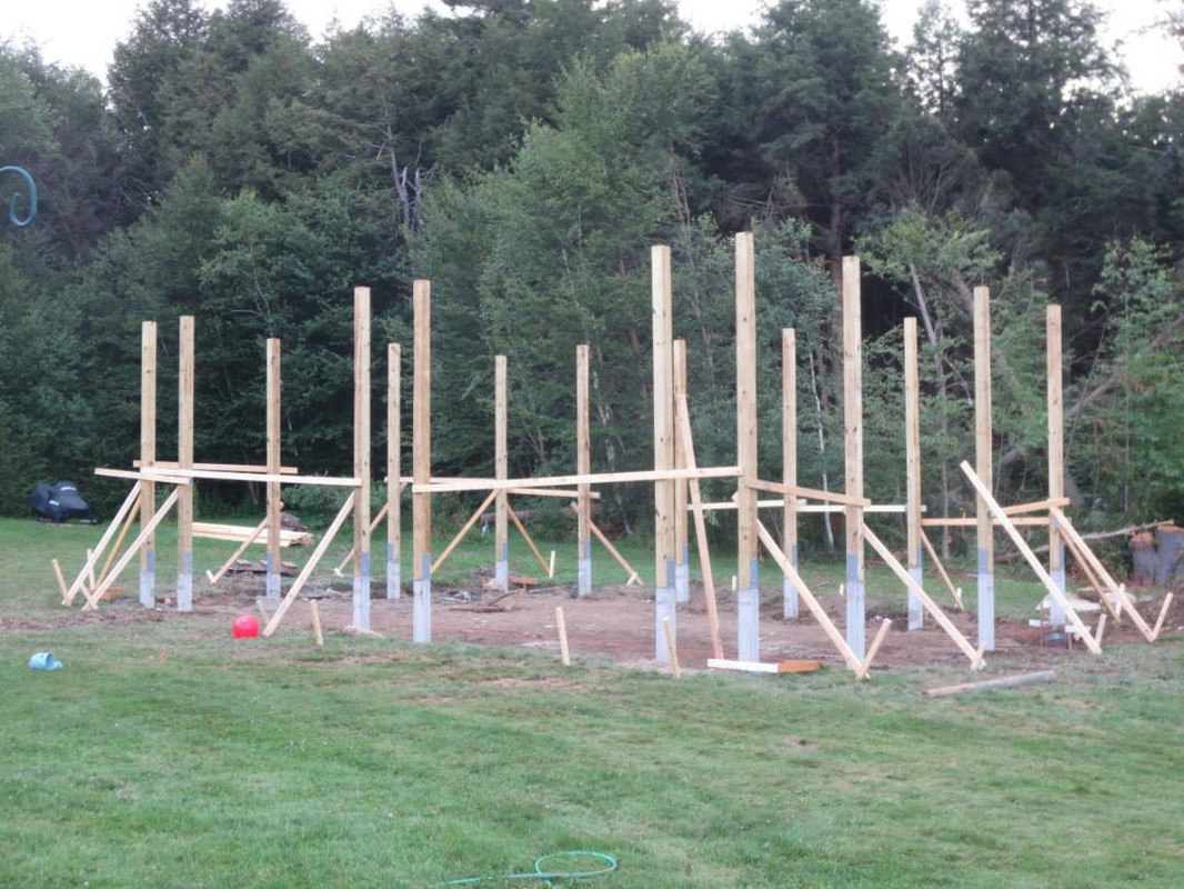

My 2 cents. I just don't trust the longevity of 6x6 PT posts in wet soils. I have seen 30 and 40 year old pole barns here in Northwest Mass. come down because the posts rotted off at ground level where there was oxygen and water. 4' down the posts were fine.
When I set my posts a few years ago for a 25x35 pole barn I used a 6"x6"x5' pre-cast and reinforced cement pier which sat in the ground on a footer. My wood posts will never be in ground contact.
If it's just 4 posts and you're not too worried about the building outlasting you, cement will work. Hand setting them would work. Whatever you choose, I do think I'd set the posts on some kind of a footer at the bottom of you hole though, as opposed to just the compacted sane and gravel.

Yes, exactly. You can buy them pre-cast for whatever size hole you dig. I had oversize holes drilled for my 6x6's and then just poured a footer myself with about 3 or 4" of bagged concrete. Dropped scrap pieces of rebar in as well.
