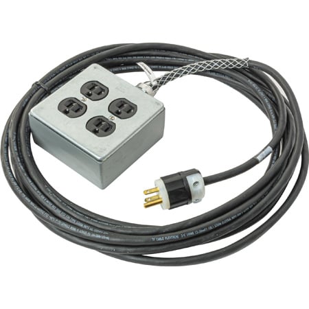

You want to make something like this:
Your chinese puzzle is called a strain relief and are made in metal and plastic. You will need to know the OD of the extension cable you are using in order to use the correct one.
An example of what is out there: http://www.elecdirect.com/cord-grips-strain-relief
I use one of these type of cords to supply voltage for my welder. This allow me the option of being able to move my welder closer to the project. Since (for me) it is a temporary move, I just lay it across the the floor but keep it coiled up when not in use. With my welder, when not it use I keep it tuck away to save floor space.

I'm not sure why so many are insisting on a cord reel. I added two ceiling drops when I did my garage workshop remodel. They are a great addition and easy to install.
You need the following:
1. metal electrical box
2. box cover with center knock-out
3. section of electrical cord
4. strain relief (sized to match your section of electrical cord). I got mine on Amazon Leviton L7503, $17
5. cord receptacle
My two ceiling drops hang in the middle of the garage - one over each car pad in a two car garage. They drop 7' above the area that is usually where my saw horses are set-up as my work station. Convenient for all of my power tools - from table saw to sanders. Saves the hassle of extension cords.

I use hanging pendant outlets a lot. I have a couple hundred of them in the facilities I run. Your generalization in your list is incorrect as to what is legal (OSHA approved) and safe with what many electricians do. Let me tell you that electricians DO NOT really follow the rules and do what is safe when it comes to hanging pendants. I have learned this the long hard and almost very expensive way directly from OHSA inspections.
OH HELL NO. Pendants are grabbed by hand all the time. What happens if your outlet shorts out to the box? Instant joy buzzer to whomever grabs it. This is a no no
EDIT when I first looked at your post the photos did not appear. I assumed that your pendant was the metal box. Just make sure you top box is fully anchored with over the joist mounting straps.
No box with knocks outs are allowed in any fashion. The box bust be formed with a boss connection as fully part of the box. Think what happens when, and it does happen, the nut inside the box holding the fitting comes free. You now have a metal item freely floating around in a box where people grab them and move them around. Sooner or later it will short out to the box or between the outlets causing a fire or shocking someone holding the box. Now something that is handled by hand is not allowed to have knock outs on it as they could release when someone grabs the box allowing a hand to enter the box and create a short and shock as well the possibility of cutting the person from a sharp edge.
EDIT for some reason when I first looked at your post the photos did not load. I see what you are using the plate for now and hat is proper.
Not just any cord is allowed. The cord must be of a design that allows stresses to be adsorbed in the casing and with internal strapping putting no strain onto the wires themselves.
Good here just put one on top and bottom.
5. cord receptacle
Good here also
I'll tell you what happens: Assuming the box is bonded to ground, as ALL metal boxes should be, the breaker will trip almost instantaneously as soon as the short occurs. The power shuts off immediately and nobody gets shocked. THAT'S what happens. Following your logic, metal boxes shouldn't be allowed anywhere. I have metal boxes surface-mounted to the walls all around my garage. I can walk right up to any of them and touch them with my hand, or accidentally brush up against them at any moment. And there is always a possibility of a wire inside of them shorting to the box. No different than touching a metal pendant box. That's why metal boxes must be bonded to ground. There's nothing wrong with using a metal box for a pendant, as long as it's grounded.
